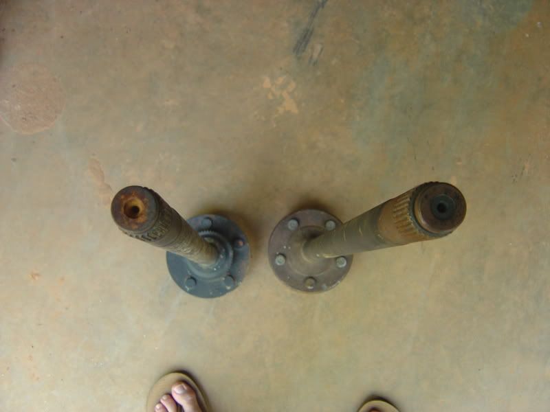

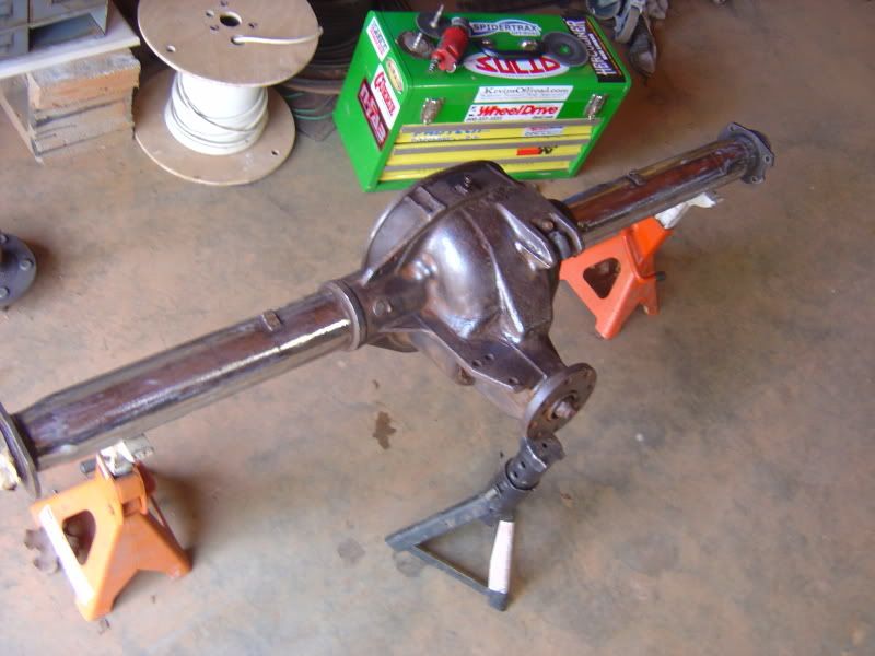

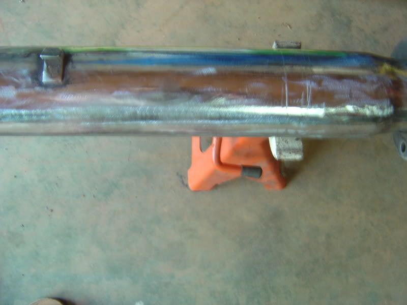

All cleaned up. The chunk still has some rust, but ill clean up more where the truss will be welded to, not to concerned.
heres a nice comparison between my spare 35 shafts and the new 8.8
Im ordering around $350 worth of stuff from ballistic on monday, so hopefully this will get rolling soon. I still need to find a 30 with 4.10s, or just say screw it and go without 4x4 for a while and find the waggy 44.
-Ronnie
UTChavok is offline
post #35 of 455 Old 04-26-2009, 08:19 AM
spidermonkey
Location: Two Harbors MN
Posts: 665
Lookin good man, the waggy 44 would be nice but they are low pinion, get the shafts and cut down a HP ford housing down the the waggy width for best results. There are threads all over the web on it.
Yeah thats what I was concerned about. I never really thought about cutting down a full width high pinion. Ill have to think about that one for sure.
