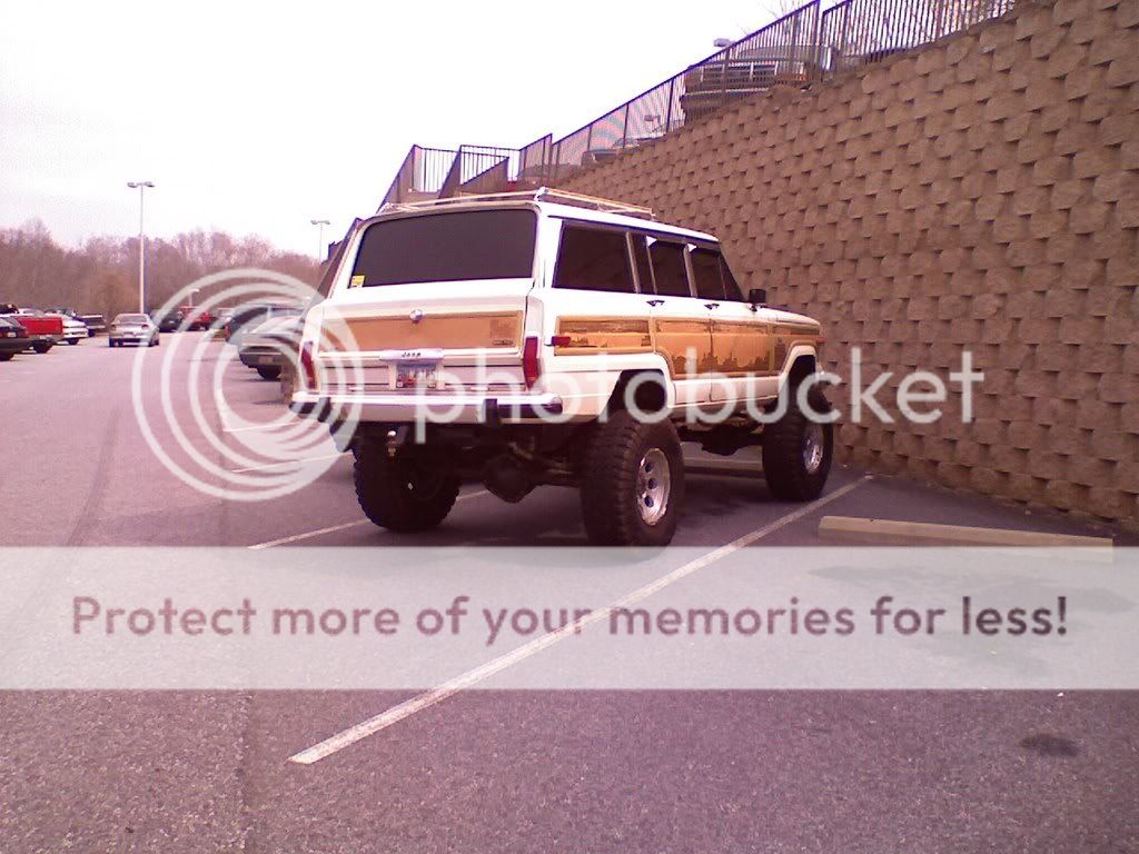

Originally Posted by UTChavok View Post
Thats a good lookin old waggy, too!

Thanks Gabe. Yeah I do love the wagon. Its ridiculously big, 4" springs with the spring over and 2" shackles.
