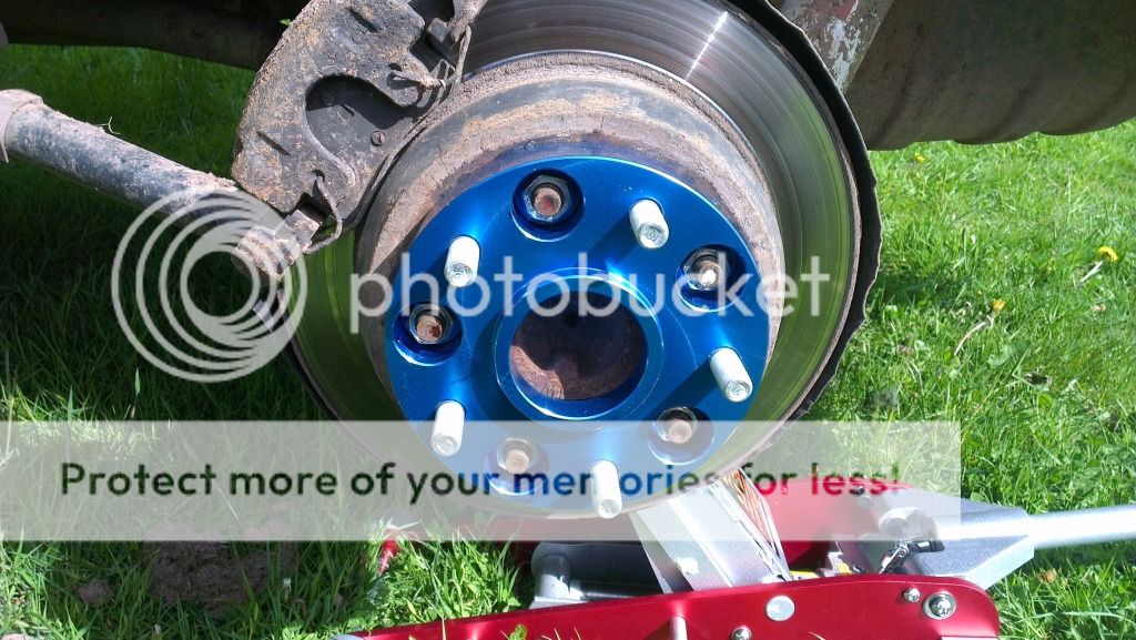

Now gone back to OEM jeep alloys so had to fit some Spydertrax spacers the other day

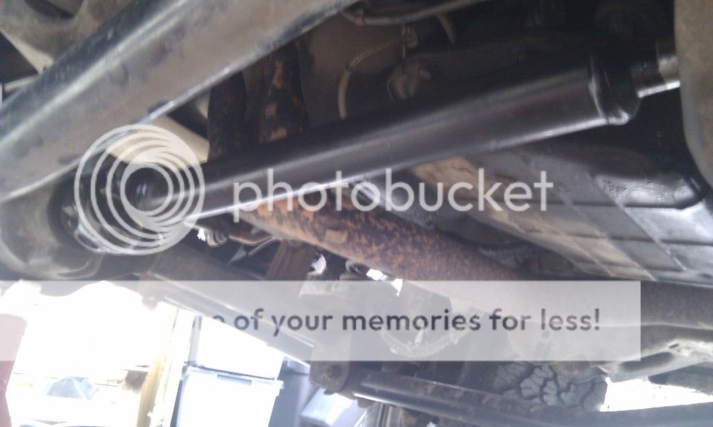

Bit of an update, loads of vibe issues with the UJ props, back running a stock CV shaft that is about to die. Just sourced a 242 to throw under the Jeep and going back to a UJ front shaft, hopefully the 242 will behave better than the 247. Regear still not done, need to get a second car so my mate can do the work.

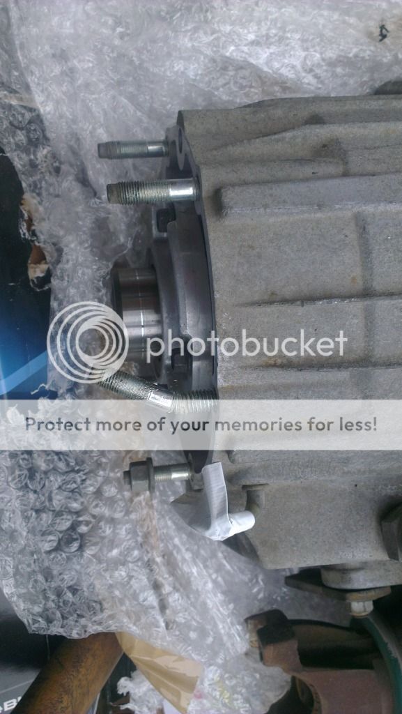

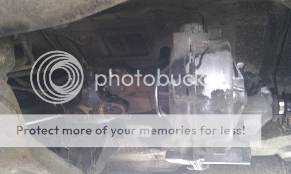

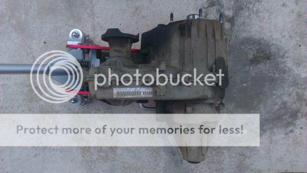

no updates for a while. Threw an XJ 242 under my grand today, regear starts this weekend.
some pics
Seems it may have been dropped on its travels, very carefully took the stud out, was more than 1/2 snapped
old 247 out
242 in!
just need to mark up the shifter until I find a new one. Had no vibes from the rear prop up to 70-odd mph (front prop not in until front axle regeared)

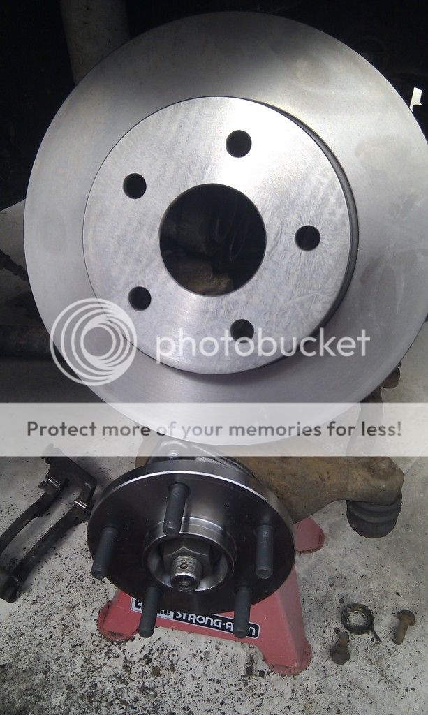

4wd again =D>
No vibes at all in 2wd, very slight hum around 70mph in 4wd but I haven't set the pinion to match the TC yet.
Shiney bits!
Drivers side wheel bearing separated when I took it off :shock: Never had one do that before
