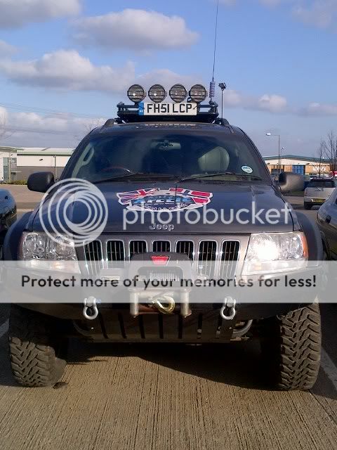

also hopefully done a deal on a front winch bumper, same as this one:

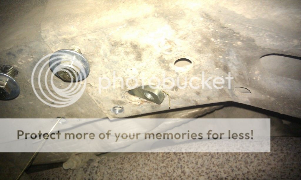

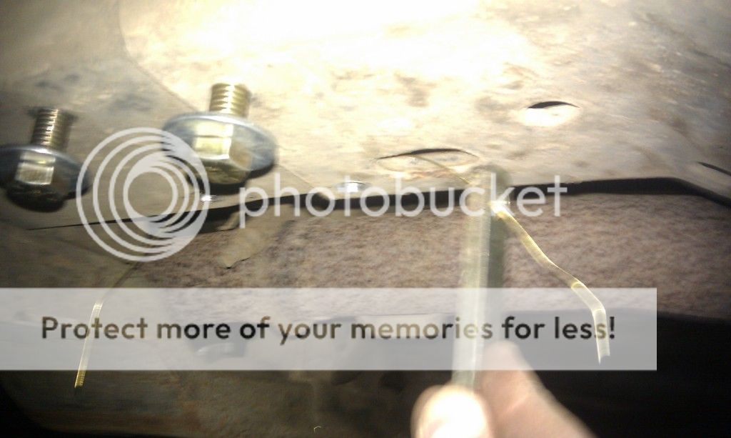

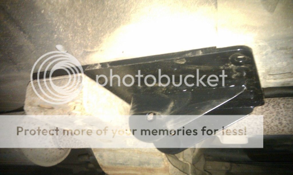

Front brackets first, they fit under the transfer case crossmember & bolt into the frame.
you need to drill 4x 7/16th (11mm ) new holes in the frame rail, so each bracket is held in with 8 bolts in total.
they come with a threaded bar to bolt into, getting them to line up in the rail can be tricky
I used some wire threaded through the holes and through the bar before inserting the bar into the frame rail, when the bar is in the rail it then lines up on one of the holes.
then spray the rail with frame sealer / waxoil
and bolt the bracket up, getting coated in waxoil in the process
All done, ran out of time so will fit the arms tomorrow night.

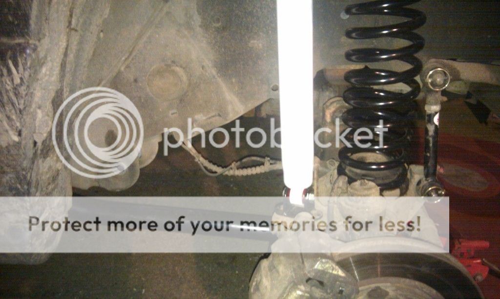

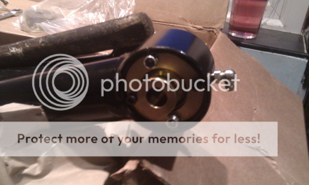

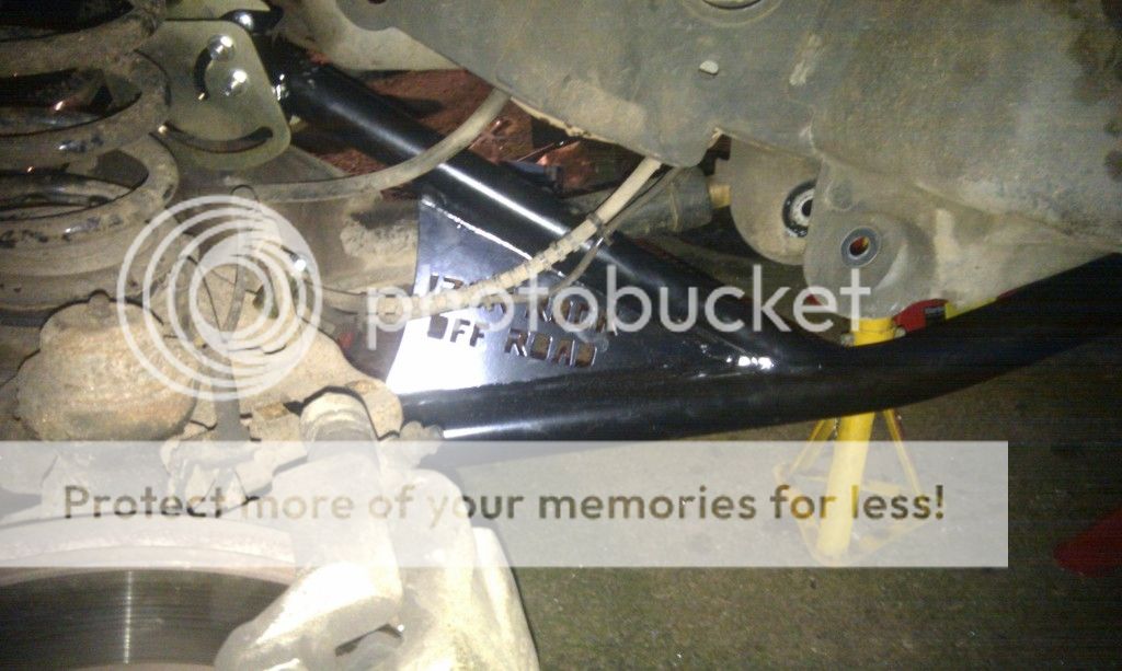

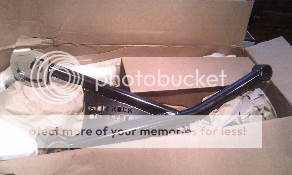

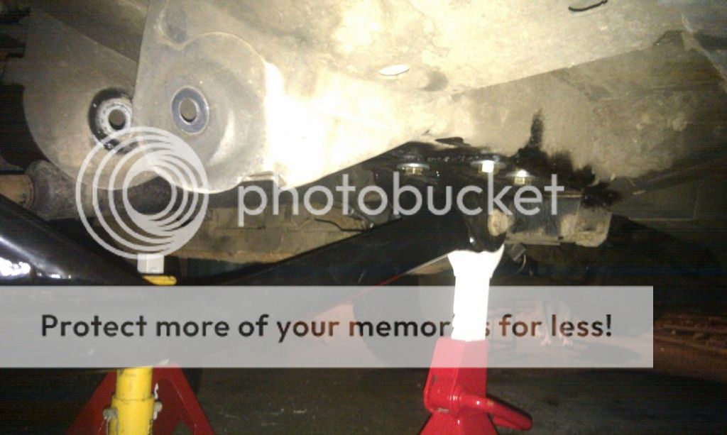

Right, 4 hours of rolling around under the Jeep & I have them installed. No real tips, it is a straight forward unbolt the arms & bolt the new ones in, a bit of a pain on your own when setting the axle angle to install the Y arm as it is heavy, other than that, straight forward.. Oh 1 PITA is the bar pins that came with my shocks are too long, & I don't want to rip them out of my old shocks as a mate is having them & my spacers for his WJ
shiney
frame end joint
Y arm installed
plain arm installed
Also installed the IRO 4" front springs and the DT shocks, which are much beefier than the Rough Country ones coming out, the the piston rod looks twice the diameter.

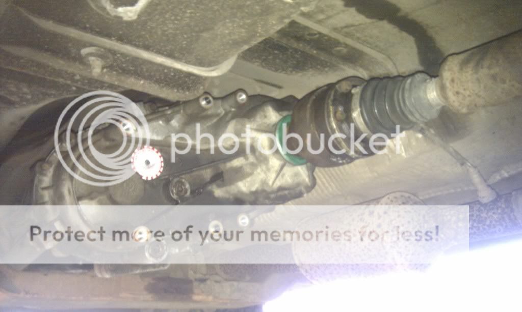

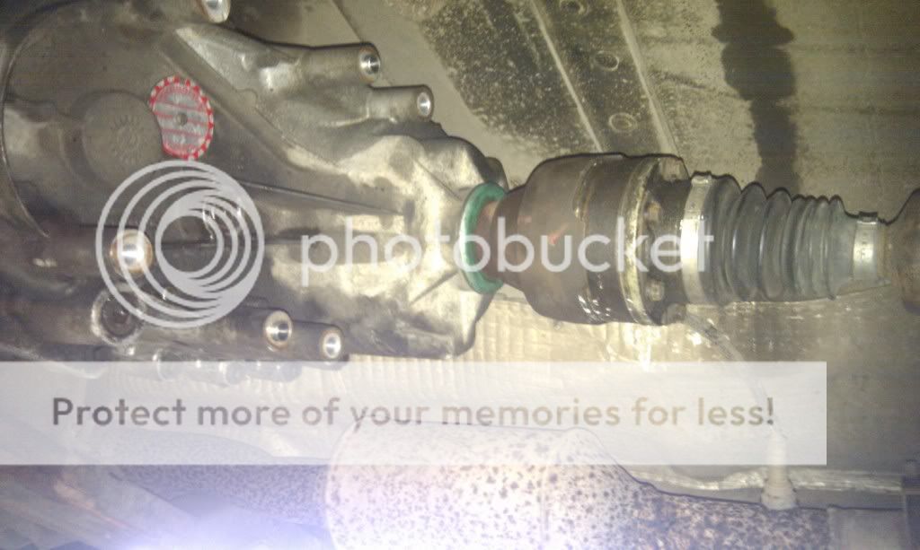

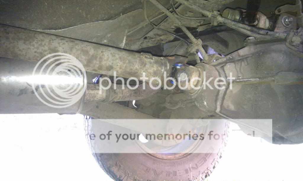

2 front axles & 2 transfer cases & I still have vibes from the front end. Prop is coming off & I am getting a double DC shaft made
I am currently running no rear ARB and it seems to drive well, may not fit the addco one I have, will see.
Looks like this now

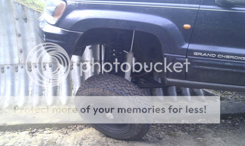

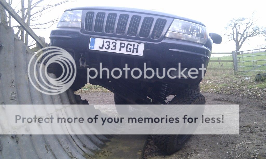

post #54 of 99 Old 03-10-2012, 10:12 AM Thread Starter
offroading.net
offroading.net's Avatar
Join Date: Jul 2004
Location: Malpas, Cheshire, UK
Posts: 705

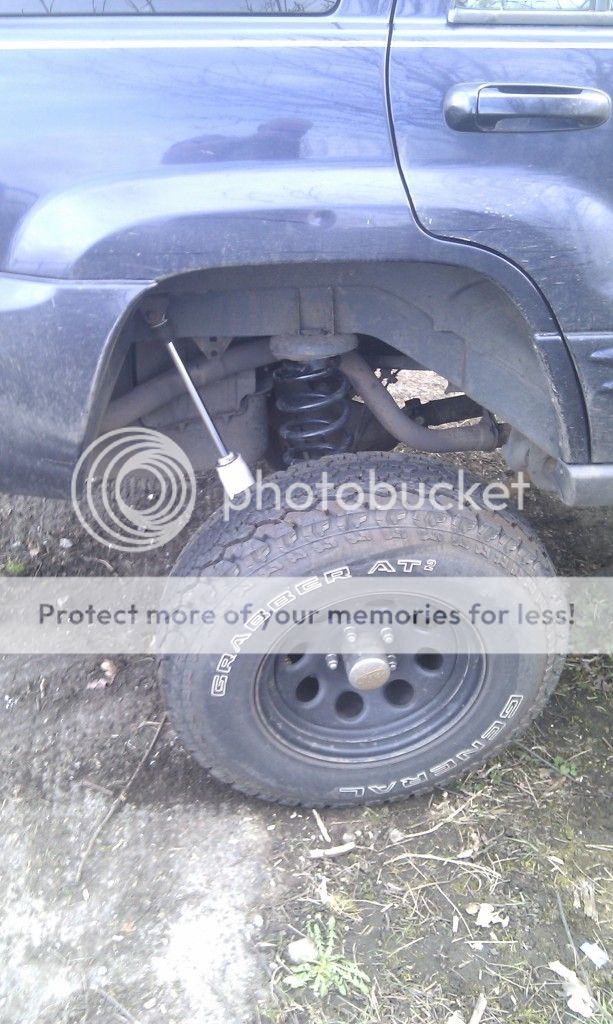

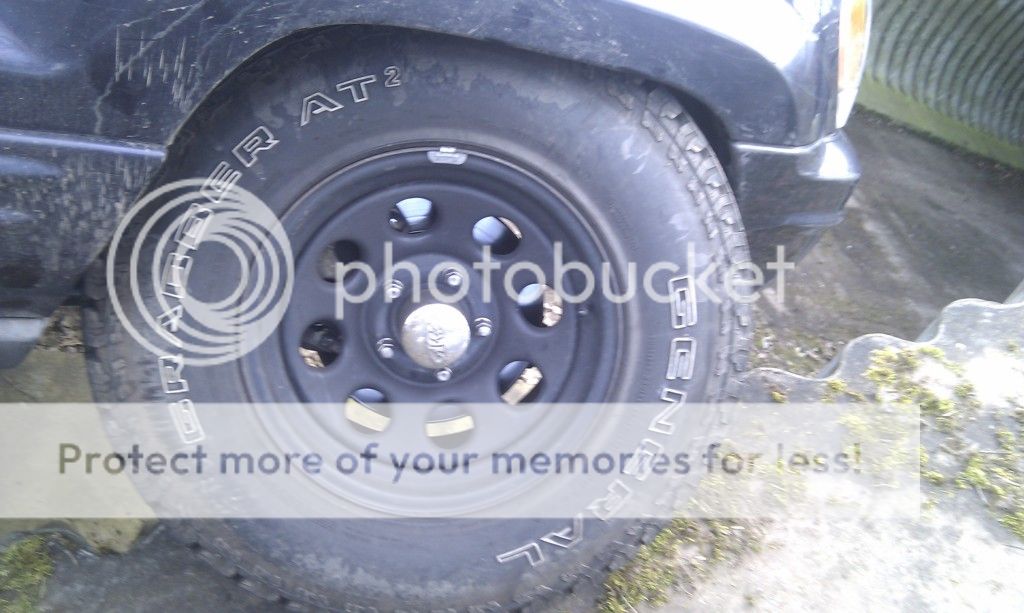

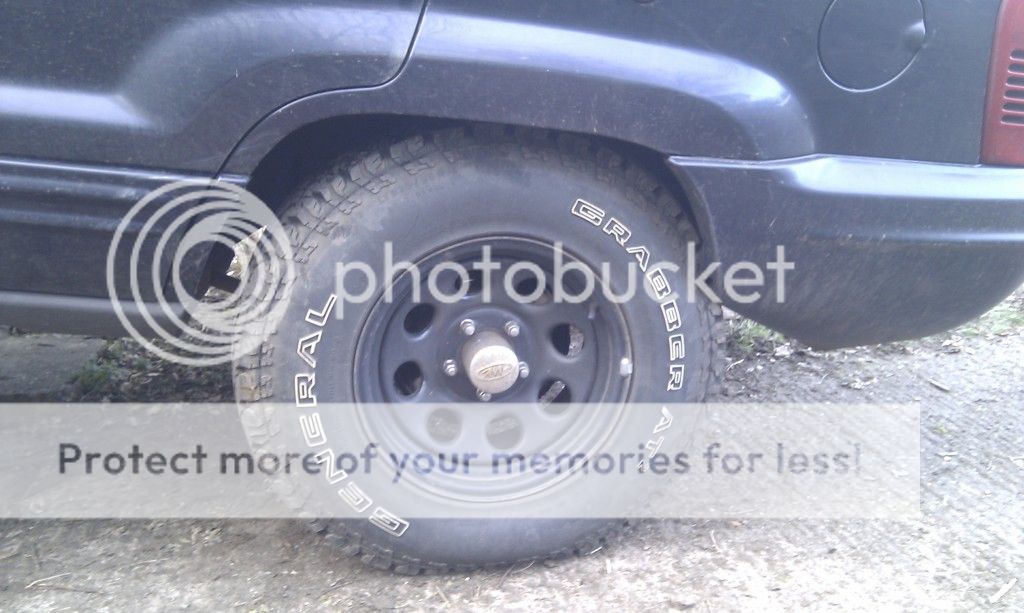

flexing
The shocks have built in bump stops, perfect for 32"s
Rear coil is unseated at the top by 1"
rear bumper needs a trim
Top of the front coil is around 4" unseated

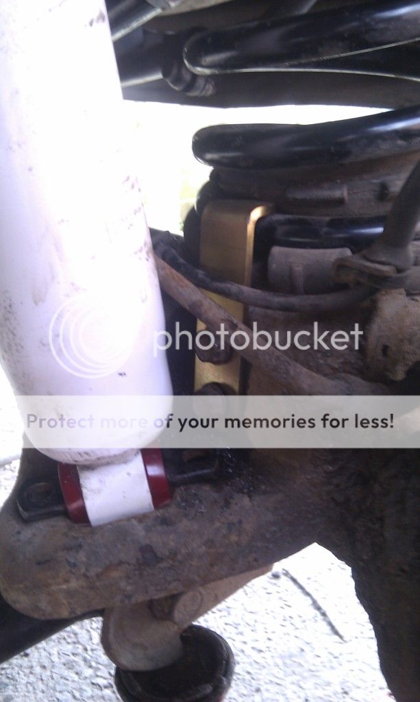

damn that looks awesome!!!
didnt the kit come with front spring retainers? have you ever solved your vibes?

Still have vibes, just about to buy a new front propshaft with a double UJ at each end.
Retainers fitted, bottom clamps the spring, upper just guides the spring back into the seat.
