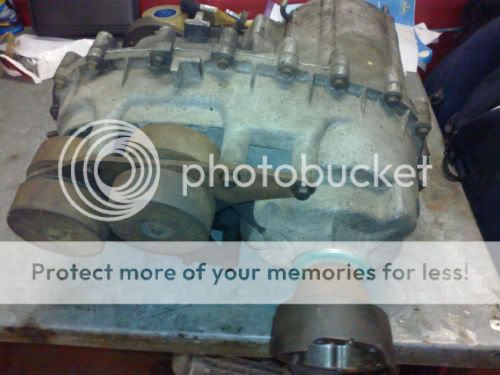

One 247 off a 3.1TD WG Grand.
Notice the rather good thing out of the factory? No slip yoke Just need to sort out getting my rear prop a slip joint fitted and I get a fairly cheap SYE (as I needed the TC anyway), been quoted 100 to get the rear prop modded

Interesting that the 3.1TD used a Rzeppa-joint rear driveshaft. It's got an odd vibration damper on there too.

Looking at the damper it does a good job of bracing the case, its very heavy
