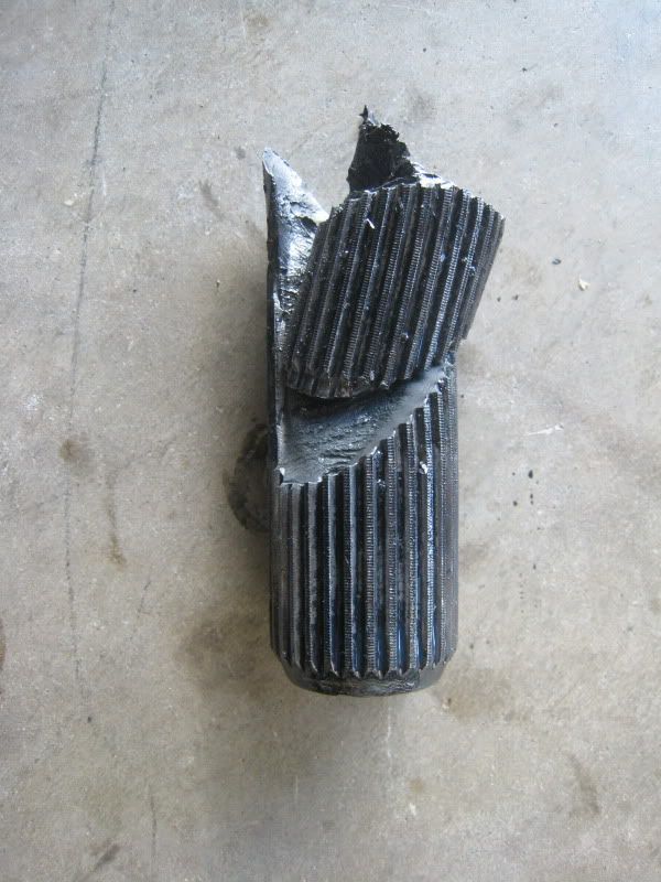

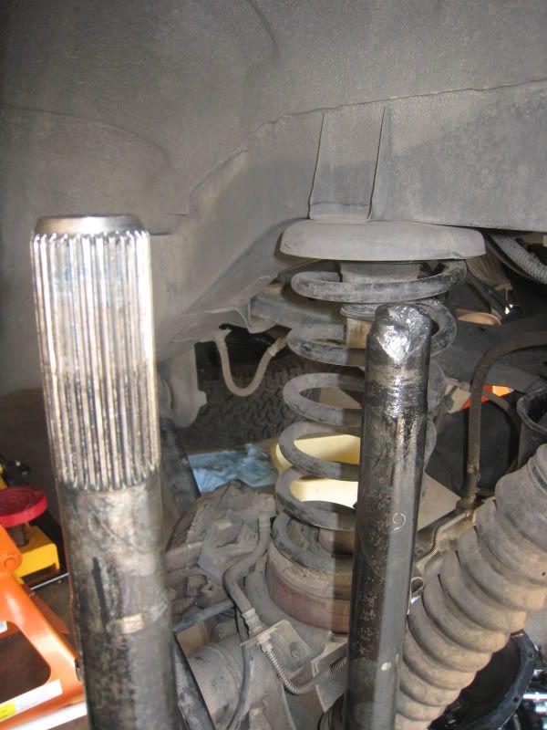

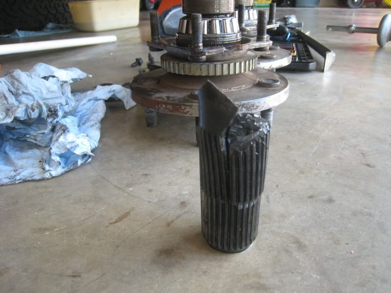

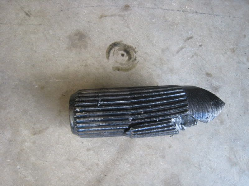

How to fail by breaking your D44a!
OK, since the build it's taking it's time , last weekend I figured I'd check the D44a (with it's broken LH shaft) and see if it would be worth to get a JY shaft for cheap so I could drive the WJ while the build is complete...... SOB, it wasn't pretty, I had already checked the diff a while back, and everything looked good, I just knew the shaft was broken, and figure I just wait to swap the rear axle rather than try and fix it. This is what I found, the shaft broke right at the at the splines, but it had twisted and expended some inside the "tube" part of the carrier (right underneath the carrier ring side bearing). The shaft came out but the splined fragment was stuck in there .... I used the other side's shaft and some sockets to press it out..... got the aussie out (intact) and inspected inside; the R&P are OK, the housing is straight, but the carrier as mentioned is toast..... , so no sense on spending a dime on it, put the spider gears back in, bolted stuff back up (with broken shaft and all ) so I can at least move the dub in and out of the garage.
Originally Posted by ArloGuthroJeep View Post
Bouncing is bad, mmmmmm k?
Nice carnage
Where did the axle shaft break at? Splines? PICS!!!
Da pics: (FYI, stock D44a shaft, aussie locked, 32" ATs, V8, trying to climb a double whammie staircase, minimal bouncing, no, really ).
RH shaft for comparison:
How it expanded after twisting and breaking, messing the carrier:
FAIL! .
TX-WJ is online now

i bet the housing flexed causing the break.

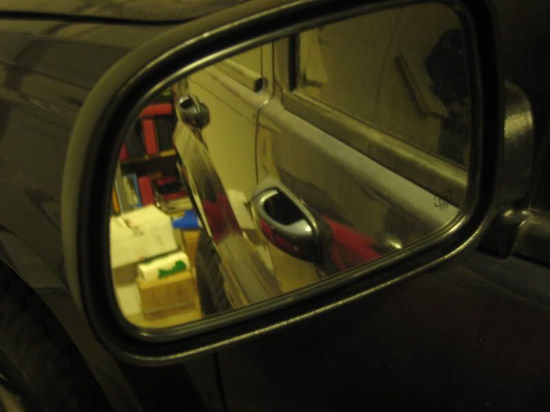

Few months after buying the WJ, the LH side mirror took a dump and the auto-dimming function quit working, the fluid just layered inside the mirror and it got darker and darker.... I looked online and the prices were outrageous (>$100), so I simply broke the outter-most glass, cleaned up that nasty oily darkening fluid, and kept a heated non dimming mirror.
Well, scored a working auto-dark'ng one at the JY out of a '99 ($5):

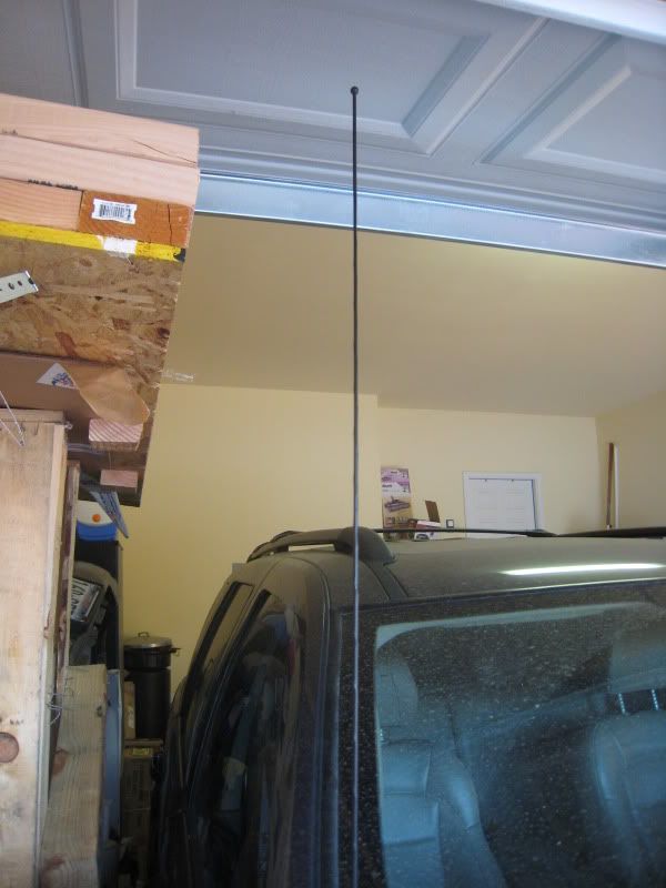

I had thought bout painting my antenna black since I did not like the silver one on the Ltd. well, took a black one for $3 since I charge myself much more than that for a paint job, and now have a spare one.

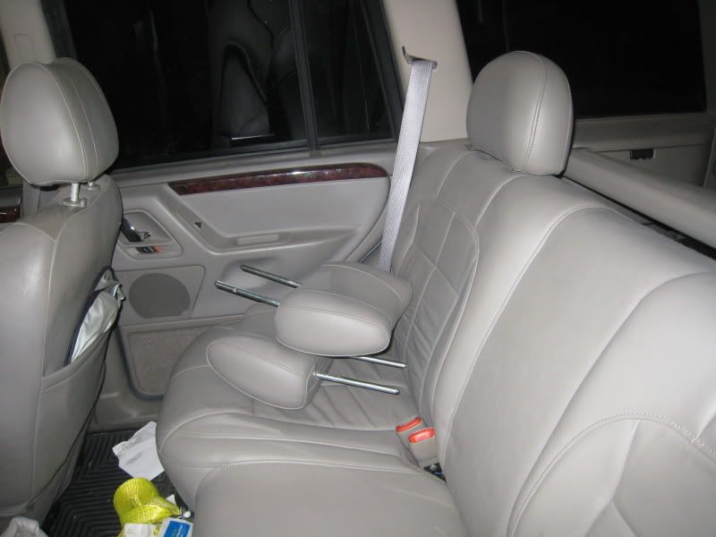

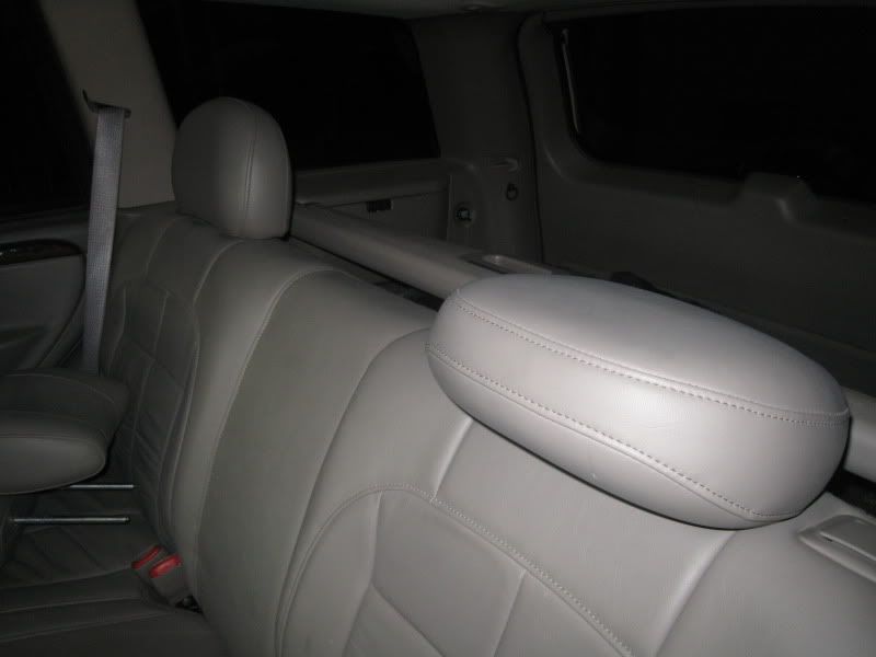

One of the few things that I really missed from when I had the '99 was the folding rear seat headrests, which allowed you to fold the seats forward without having to remove the headrest, a feature neither my '03 or the '04 had, to DC. Found a matching set out of a '99 ($10 for both) and slapped them in.
So let's see, $5 plus $3 plus $10, plus $1 "environmental fee", minus 50c I found in the back of one of the WJs ; not too shabby for a <$20 bones trip to the JY, and the WJ got some well deserved love .

Ouch. Looks exactly like my D35 shaft when it broke. Make sure to replace the bearing and race on the side of the break.

Maybe, but what I really think happened was the LH rear tire was bound up on a crack, and the torque went all to the RH shaft, and twisted till it broke (ya know, the aussie doing it's thing).
