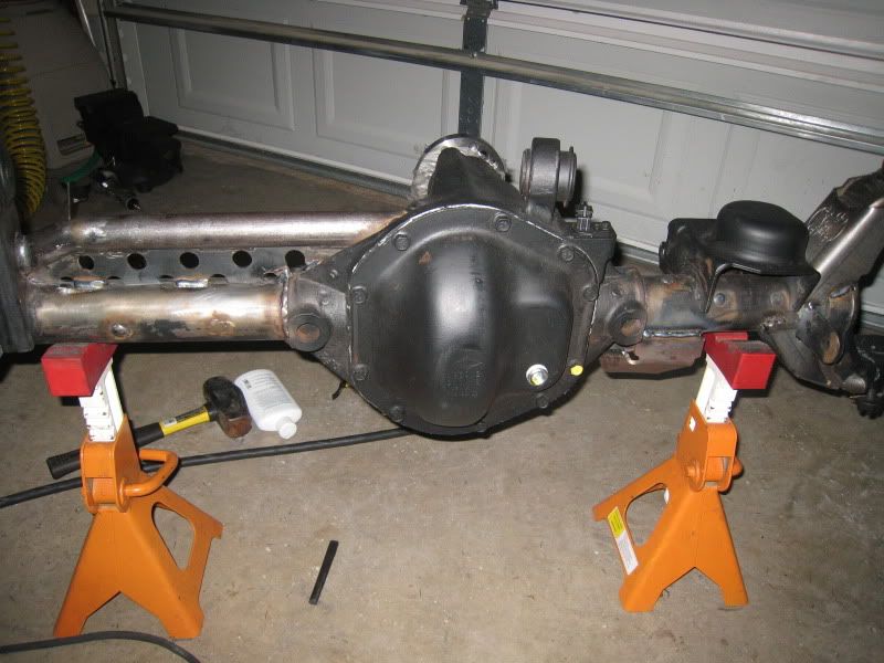

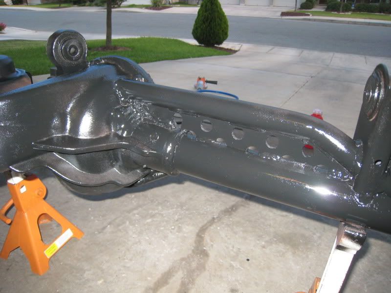

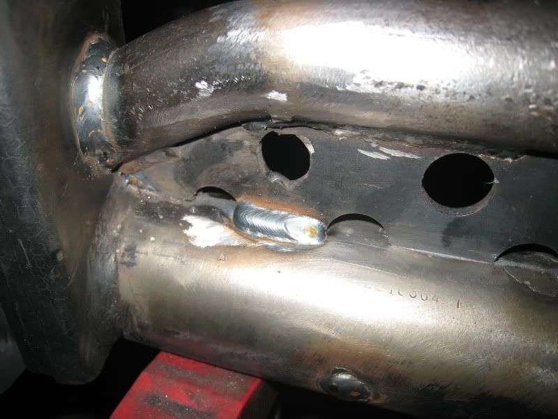

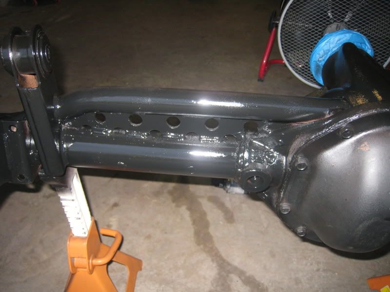

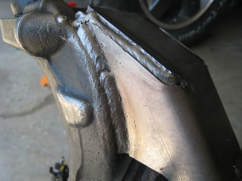

OK, the front axle is almost done; burned the "C2s" gussets, CA bracket skids and the RK truss; still need to bolt/weld the TB relocating bracket and some bumpstop pads/extra trusses (prolly will wait on those until the axle is mounted so I can measure where and how tall they need to be).
This thing is far from a D60, but it should be significantly stronger with the inner sleeves/truss and gussets; next cut the rear axle brackets and weld the Calyton's axle bracket kit; slap'em Riddler covers, done.

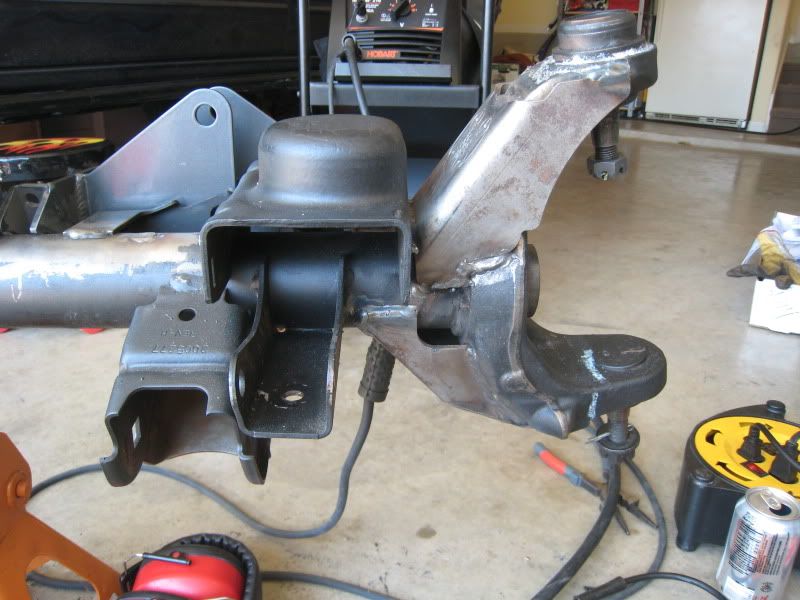

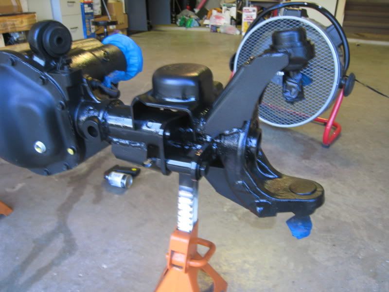

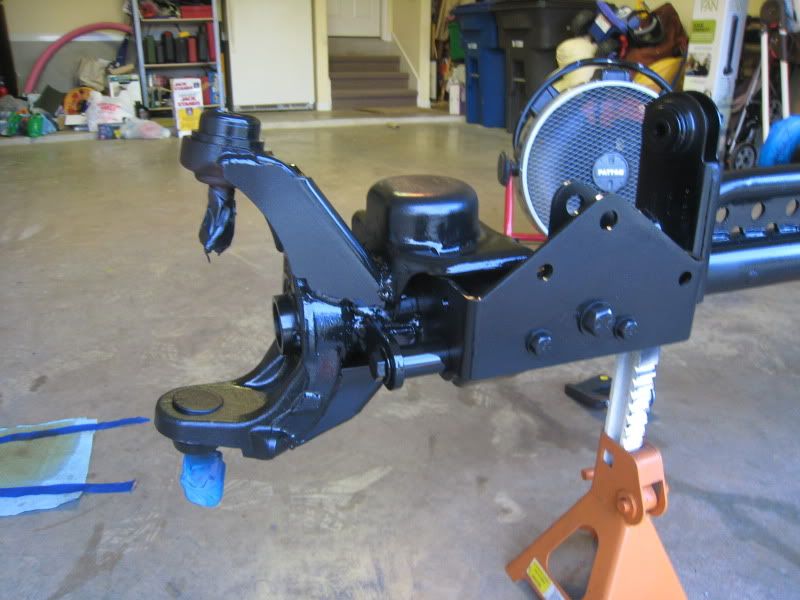

OK, so the front is done; just need to slap a HD cover and mount the knuckles/shafts. Next the rear....... damn it, after seeing those 4 door JKs on 37s , been pondering the idea of regearing low and running 37s instead ; it never stops. me.
Da pics:

Nice looking welds. That thing looks awesome painted up.

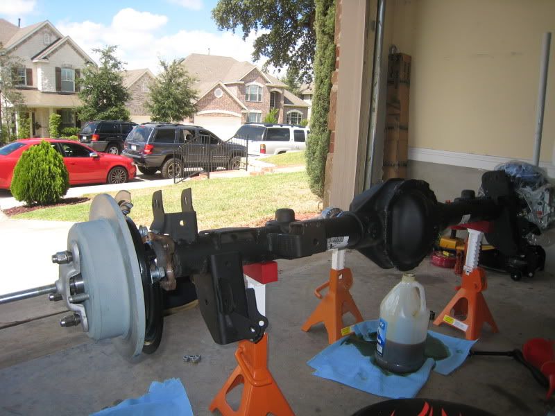

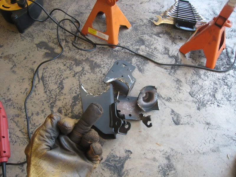

Made some progress this weekend; well not a lot, but progress is progress .

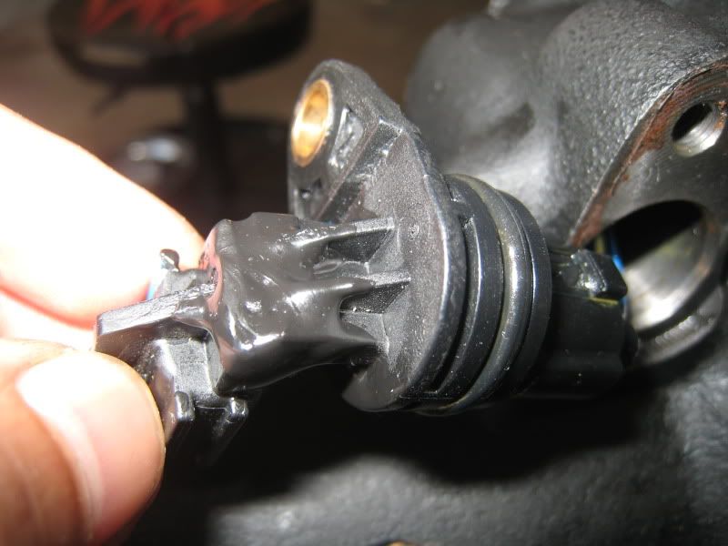

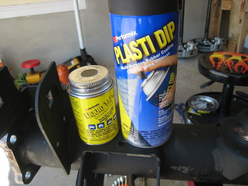

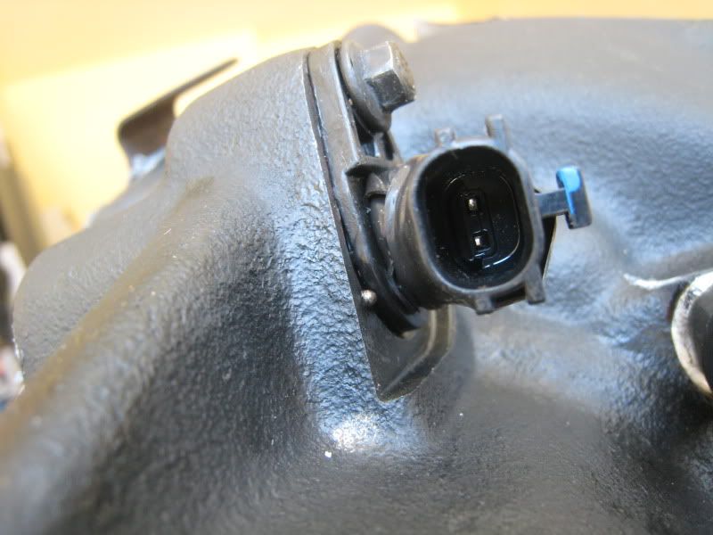

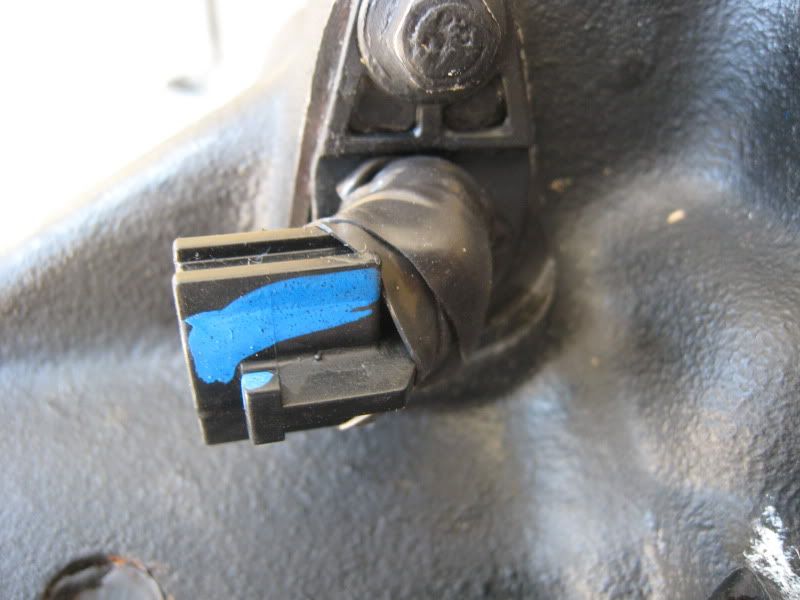

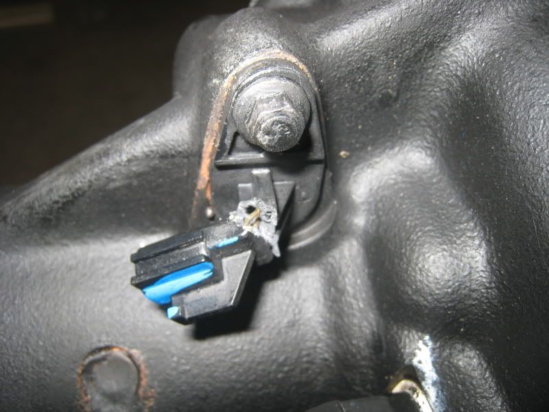

Gutted out the rear axle to start working on it, only to find out that the locker sensor plug got messed up during shipping; so I decided to try and fix it since only the plastic part of it broke off, the metal connectors were still intact; I used some plasti dip / liquid tape to insulate it and some self-bonding tape I found in the stash of useless crap one buys from Harbor Freight .
FML!!!
Then started cutting the brackets..... after being done with one side, the vibes from the angle grinder/cutter were getting to me, so I decided a plasma cutter is my next bday present.

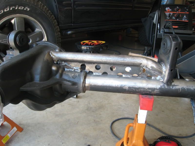

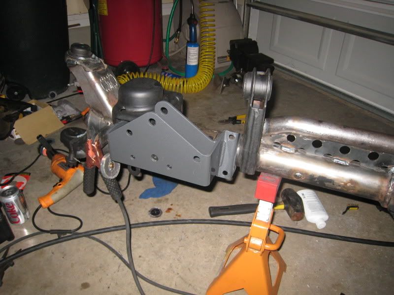

Mocking up the clayton's truss:
I can't wait to have the rear brackets welded and be ready to move on to gears / D-shafts and get the dubjay moving again; getting there slowly but surely .

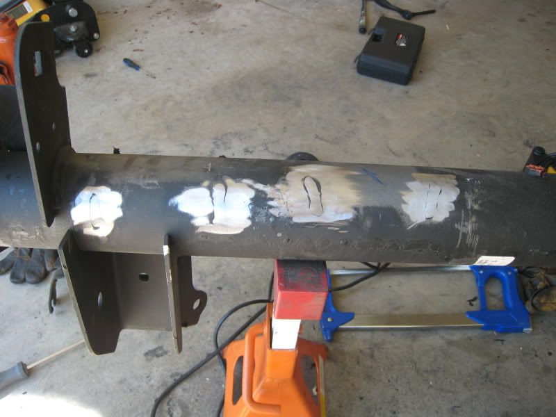

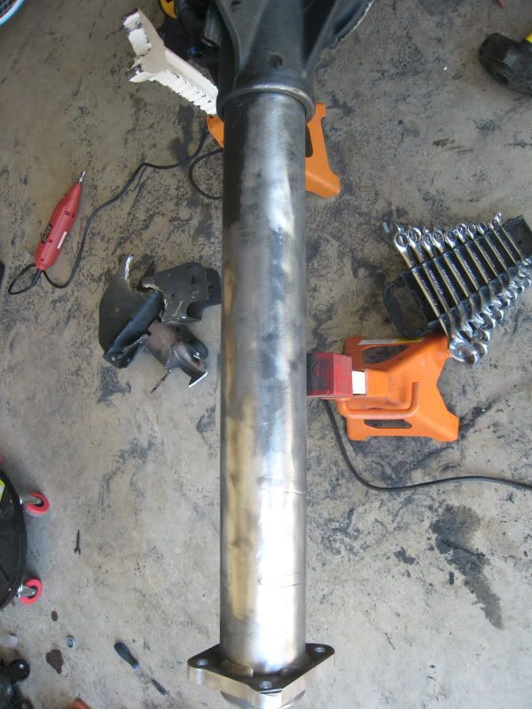

Well, I'm glad that the JK axles are nearly a bolt-on swap for the WJ ; finally done cutting / griding all the brackets off the rear today, hopefully will be able to weld the truss & new brackets this weekend and move on to something else. Still can't make up my mind whether to go with 35s or 37s KM2s....
