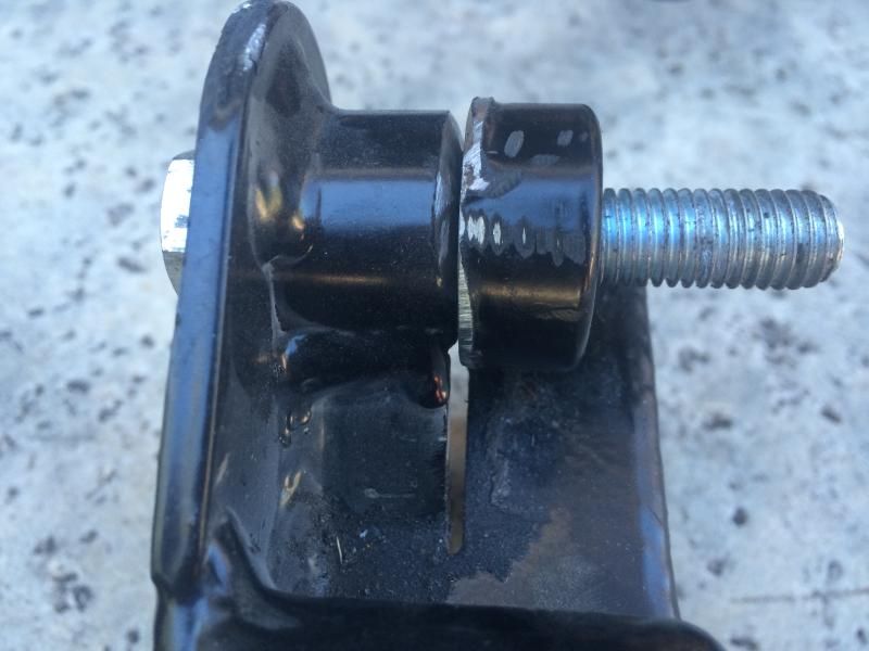

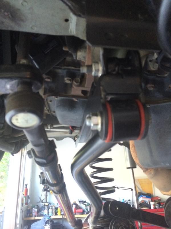

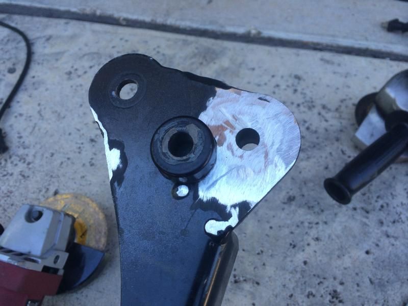

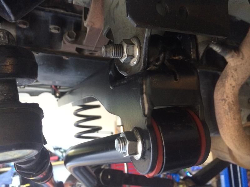

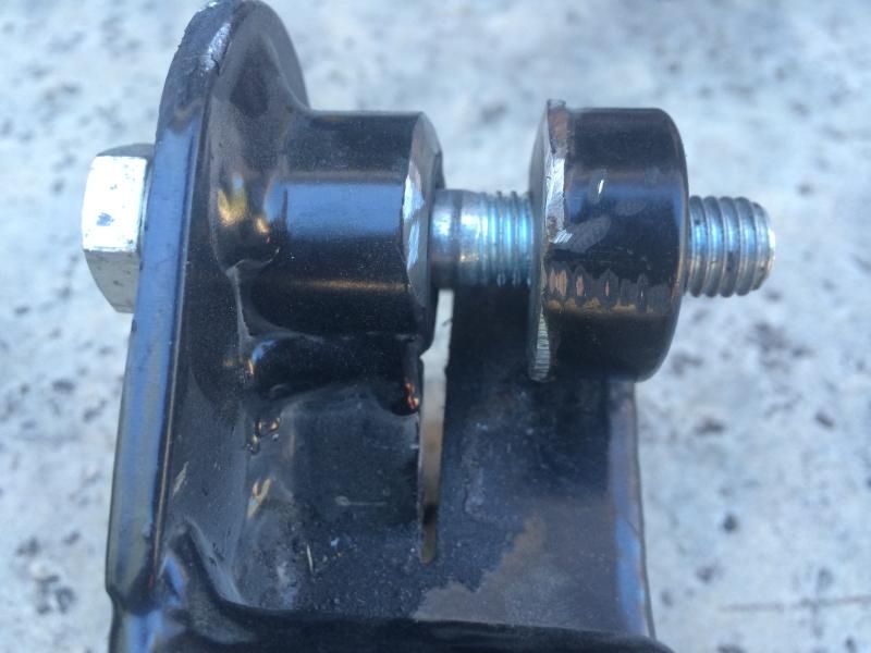

On a different note, I finally tackled an annoying clunk in the front; with the steering equalizer in place, the frame side of the trackbar is pushed forward due to the design of the TB drop, and the TB and the DL would make contact under certain load/steering/suspension travel conditions.
My solution was to take the equalizer out and cut the rear half of the mounting sleeve out and move it to the front side, reweld it and that displaced the frame side mount back about 3/4"; now there's plenty of clearance between the TB and the DL and the front clunks are all gone. If I could only get rid of them vibes!
