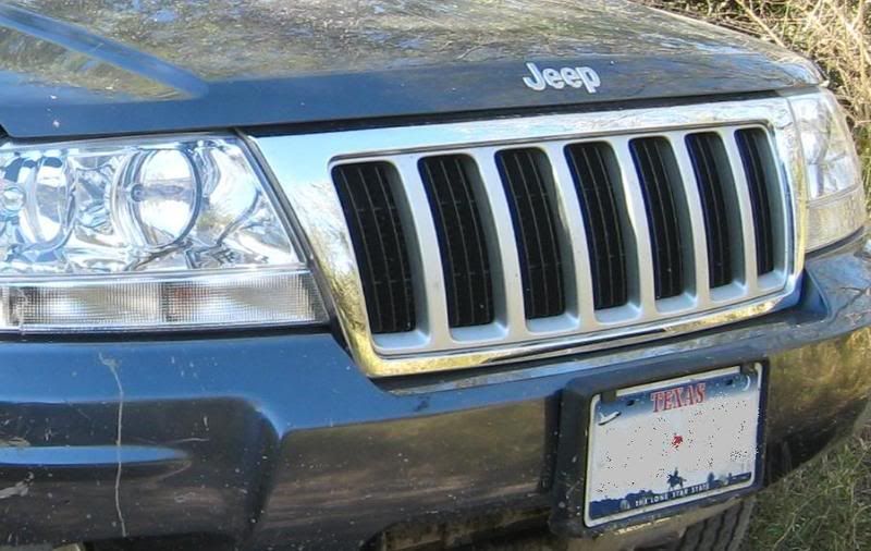

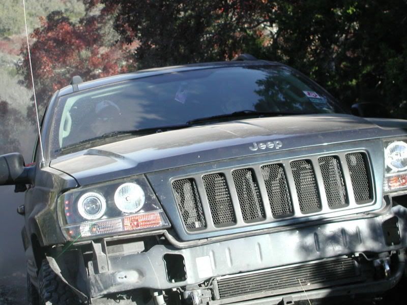

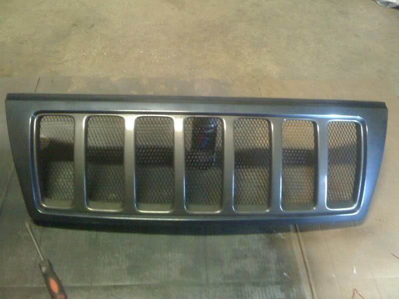

Then, got tired of the way the chrome ring on the grille looked like, so I sanded and body match spray painted it; while at it, added some mesh grille love : (more on it here.)
before:
after:
Some action shots of the front end, I love the more aggresive look now (Yes, I do have a Freedom ed. fetish ):

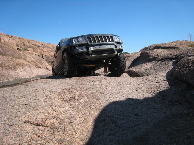

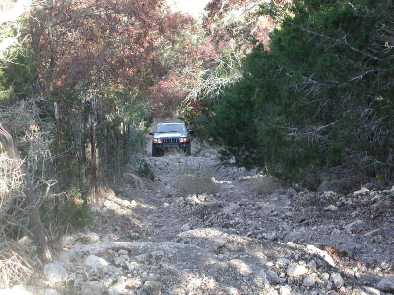

This pic. don't do it justice, this is some nasty steep loose gravel Texas hillcountry climb at Cline's ranch "throttle up".

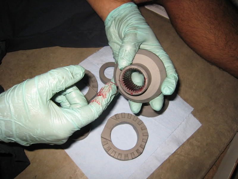

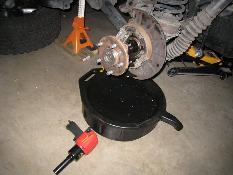

Then the D44a Aussie goes in :
(No, I'm not lifting the Heep by the diff, jst. supporting the axle while in the air.)
Working on the floor sux. Where's that lift?

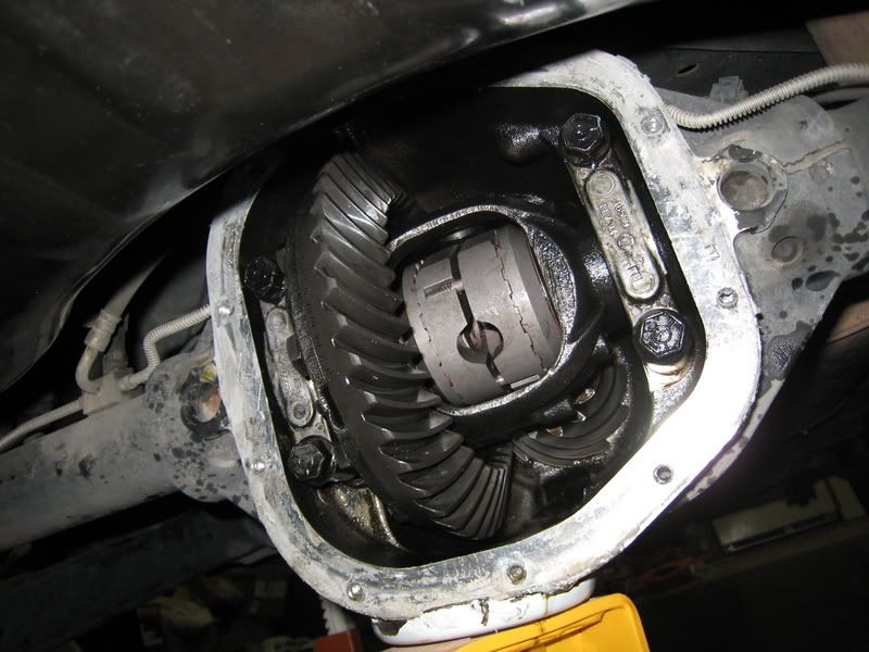

Putting the Aussie to the test at K-rocks: (Mopar front, t-case and gas tank skids went in sometime around here, sorry no pics; the front one seems like a waste, the t-case one is pretty bent but has done it's job; the gas tank one is PURE BEEF!, and was a pain in the arse to put in).
"Have you scraped your alum. diff lately?" , damn leaky D44a.

Nice lookin jeep! Was the grill pretty easy to paint? I'd like to get mine painted black
Thanks, just follow the link I posted for some more detailed instructions, but it's pretty easy, just takes some time. (more on it here.)

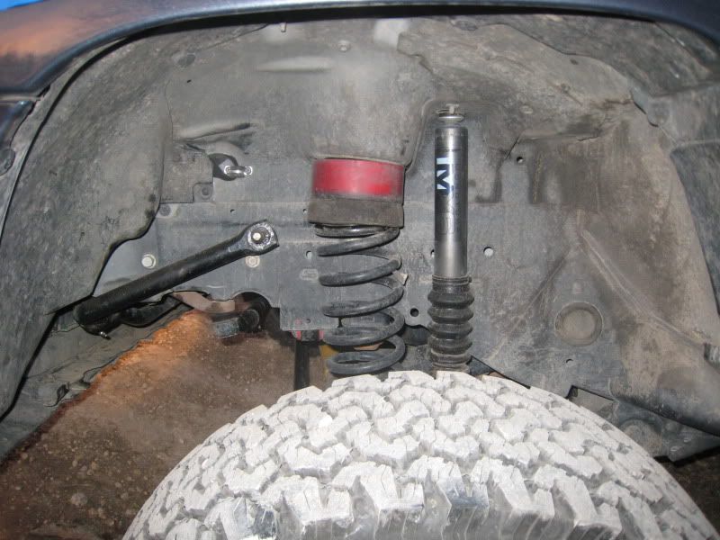

Ummmhh, there aren't any stacked spacers anywhere in this Jeep, r u talking about the BB? ; the fronts go on top, the rears at the bottom as per Daystar's instructions. The factory rubber isolators are suposed to stay in under the BB.

I think he's talking about the spring seat, whatever you call it. There's that small piece that the spring sets against and then the spacer on top of that. Though it looks like you could use some spring retainer post extensions. Had any issues with that? You'd said your bumpstops weren't any good either. Do you have problems with that?
Yeah, I think you're right, he's referring to the spring isolators, they are suposed to stay in AFAIK. I do have spring retainers / post extensions somewhere in the pile of parts siting in the garage, awaiting for the next phase of the build . Since so far I've been running stock arms, the droop is limited by the arms themselves, so not enough droop to pop a coil . See max droop below:
(as a side note, you can see the small loop with a velcro strap that I screwed inside the wheelwell to secure the swaybar when disco'd, not in use in the pic).
