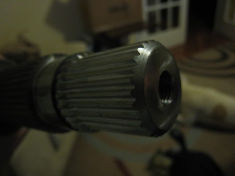

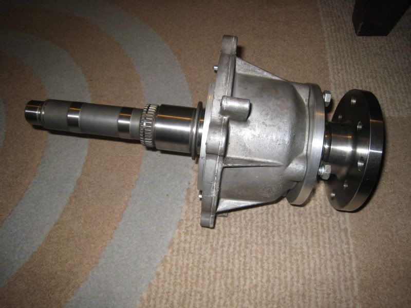

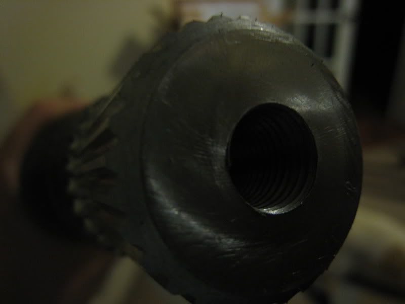

I recieved the 242HD SYE from TW today. Upon initial inspection, everything looks pretty well made; the shaft is shortened, re-splined and tapped; the tailcone is replaced by a round aluminum piece which bolts on to the "speedo housing", this new tail piece has the new "output" seal which fits snuggly around the flange, which in turn will accept any U-joint sized DS.
Assembled things and did a quick runout check and everything seems in order; good machining all around, took about 10 days door to door.

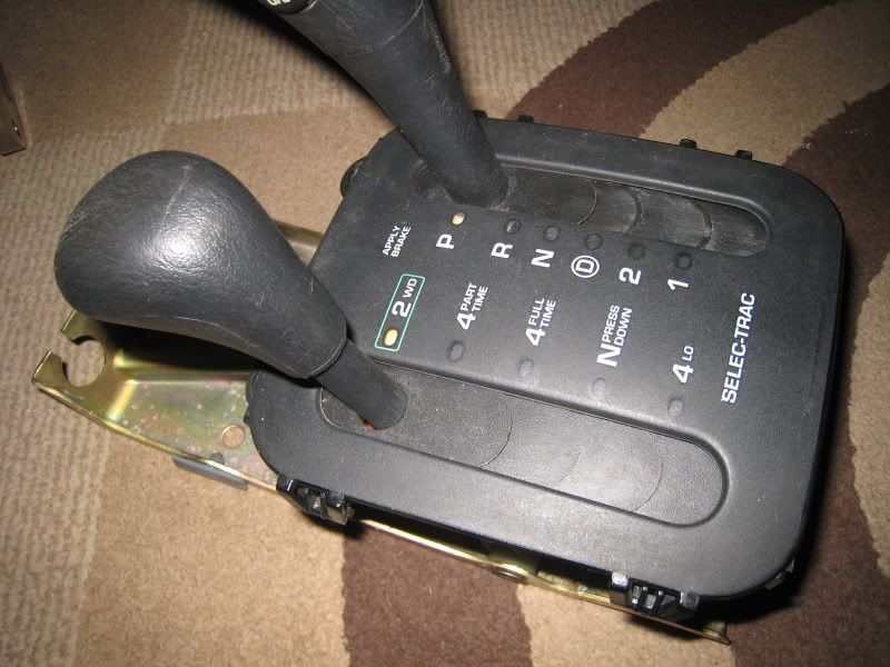

Also got a selec-trac shifter to swap out (thanks Quadra ).

Whew, that TW SYE looks awesome. Will have to put that on my "want" list.

It's funny you mention that, cause when I called 2 weeks ago, the guy that answered the phone gave me the same response "we don't have an SYE available for the 242HD", so I insisted he let me talk to Tom directly, since I knew he had done it as far back as May this year when Skain8 had posted it here, and then Tom told me he had done a few and could do one for me if I sent him the main shaft and speedo housing.
I, like you, figured by the time I spent the money on a 231 with a 4:1 kit, might as well had gone Atlas; I decided to go 242HD+SYE for now thogh; but an Atlas and 1 Tons is the destiny of real Jeeps, it's just a matter of when.........

TW already has an SYE kit for the 242LD listed on his website, and I think he's had it for a while, so you should be good; the one pictured above is specifically made for the 242HD, it's not yet listed on his website AFAIK, and wouldnt work as the shaft is a bigger diameter on the HD one.
