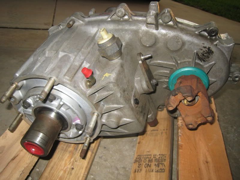

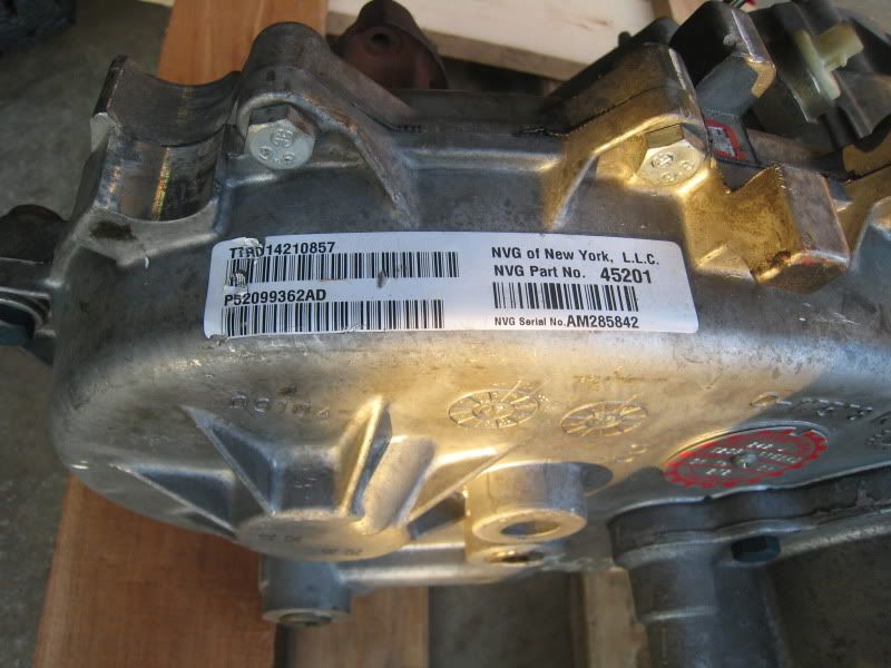

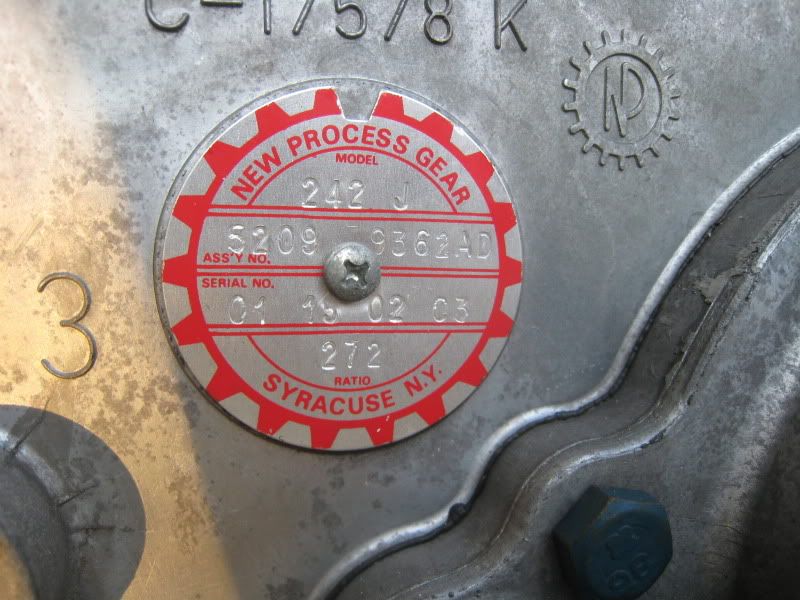

So, since I could not source a local 242HD, went to car-parts.com and found me one out of an '02 with 11K mi . It arrived today .
Next, TW SYE / DC shaft .

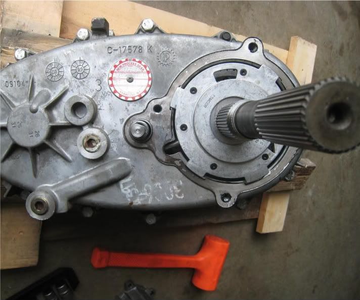

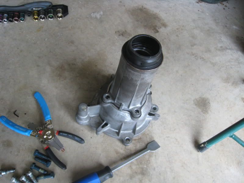

Today I took the 242HD case apart to inspect it and get the main shaft out; overall pretty simple process, just take your time and work carefully, you don't want to mess the aluminum case. I followed TW's website instructions here.
Start with this:

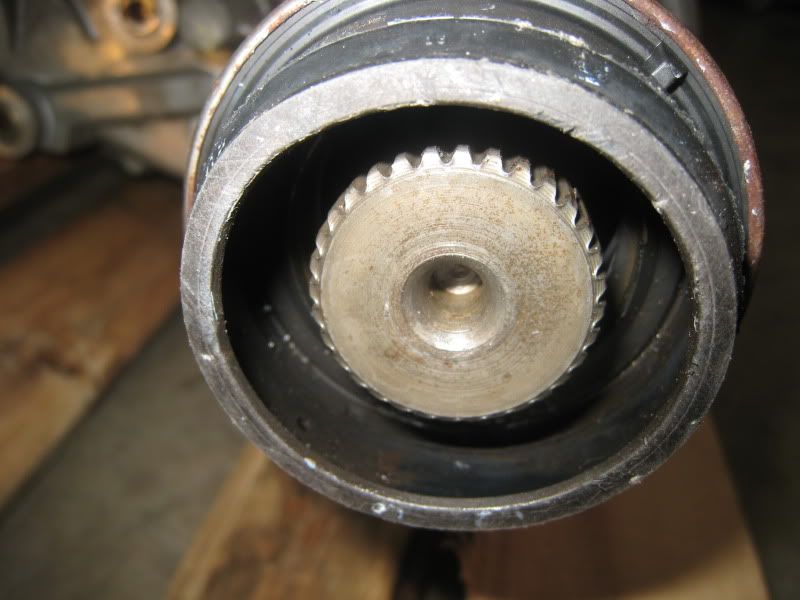

Remove the tail-cone, then you'll see an external snap ring right at the "speedo case" bearing (of course, no speedo on our WJs), remove it, then remove the speedo case itself.
Followed, remove the rear half case (tap it around with a dead blow hammer, again take your time, then use a flat head screwdriver on the side slots to carefully pry it appart, you'll brake the seal eventually, just takes a little bit of patience).

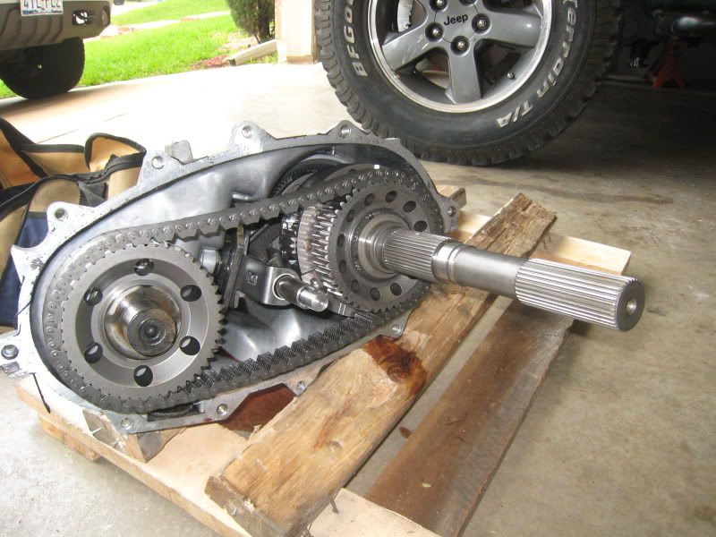

Now inspect things; no need to rebuild this puppy, everything looks good, and shifts well as should be expected for an 11K mi case.
The 242HD in all it's glory:

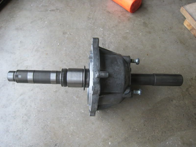

Then simply pull the main shaft out while working the chain off the front output chain sprocket at the same time; now you'll have a couple'a more snap rings to remove the intermediate sleeve and the planetary assembly off of the main shaft, and done.

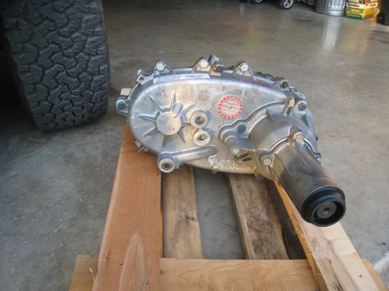

Here's the main shaft and speedo housing ready to ship monday to TW to get SYE'd .
