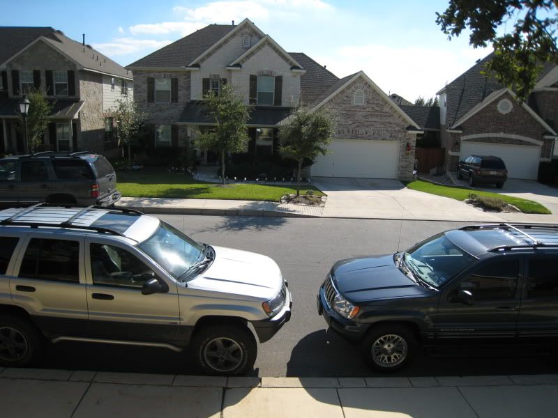

Here's the window sticker:
And here she is, in its pure "stock" form (sidesteps installed by the PO ; as a first mod, those sidesteps have to go).
In with the new, out with the old:

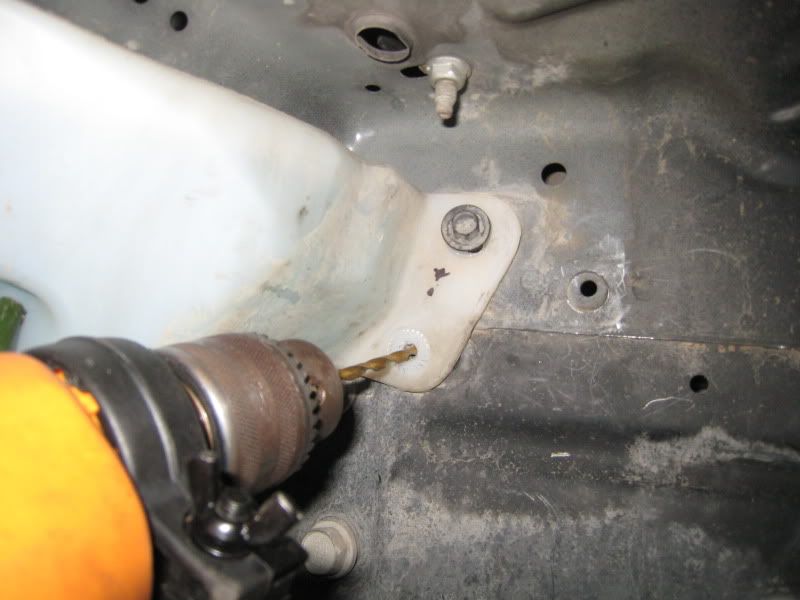

Then the process started; transplanted the 3" lift from the '03 to the '04; that was a long weekend, which ended with a sore back and a big smile on my face LOL.
Got some chrome mopar towhooks:
Added tera bumpstops front and rear, they suck!, what a waste of money , too short to do anything at 3"; should've gone with IROs custom ones.
Added the JKS adjustable trackbar while I was there, since was dogtracking a little at 3":
Redrilled holes for the washer bottle mounting bolts on it's stock location and was able to move it forward about 1", which worked well with the 32s fully stuffed; but will need to get a bottle inside the engine bay for the next phase of the build.
Tossed in the front Addco and added grease zerks to the mounting brackets since the poly bushings that it came with would squeak like crazy after a few days.....especially after water crossing with the heep . (Had to drill the front addco holes to fit the JKS disco pins as the bolts were bigger than the addco's holes, what a pain!, make sure you have some sharp cobalt drillbit for this, I think it was 1/2").
Getting her dirty after the lift and wheel/tire transplant:
