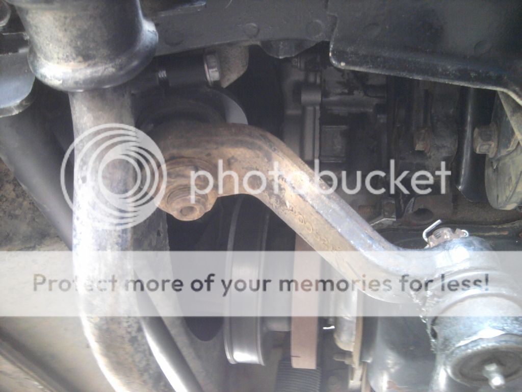

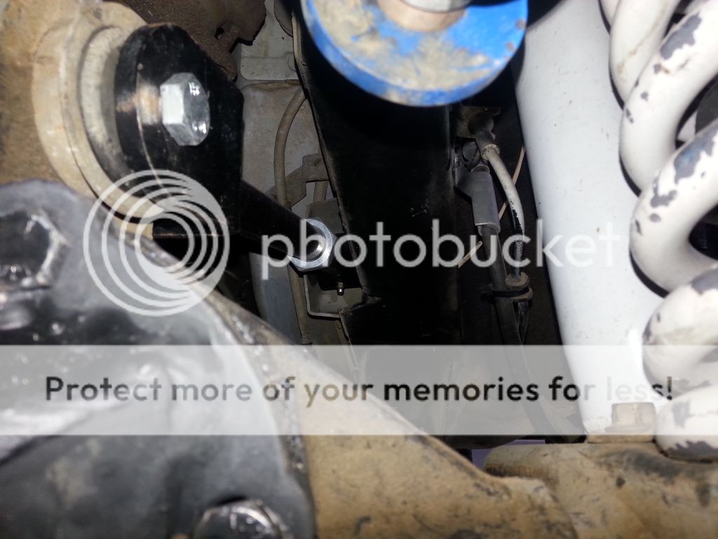

in the before picture the mount was cocked because the backing plate i made was trying to go off those 4 bolt holes but my holes were slightly off so i have to oval the arb brackets to now it sits straight. any angled you might see if the top piece of 5" where it tapers down about a 1/4"

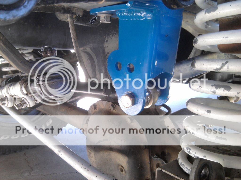

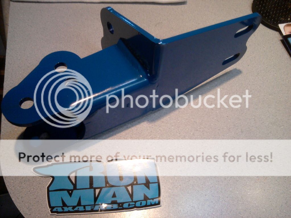

so i got my iron man 4x4 trackbar bracket installed, but unfortunately i have a creaking noise still after going to an after market bracket, i have it tacked in at about 10 different spots. so i may have to make a brace for this.

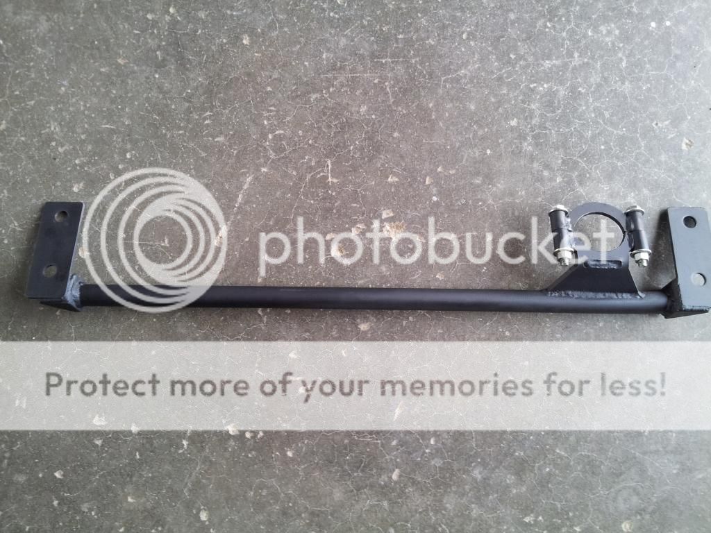

then i got this steering box brace from FortCollinsZJ for considerably cheaper then KOR brace, and i don't need to buy his sway bar bushing i can use factory bushings. i didn't take a picture of when i got it so i will use his pictures. i got the brace right at sunset so i had to go install it right then.
this thing is beefy probably weights about 10lbs or so. and it uses all 4 sway bar bolts.

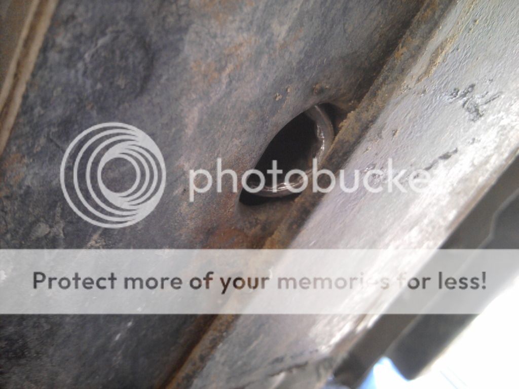

oh and i found my 15mm socket that fell into the unibody. which i was able to fish out. about 2 feet away from the upper CA bolt

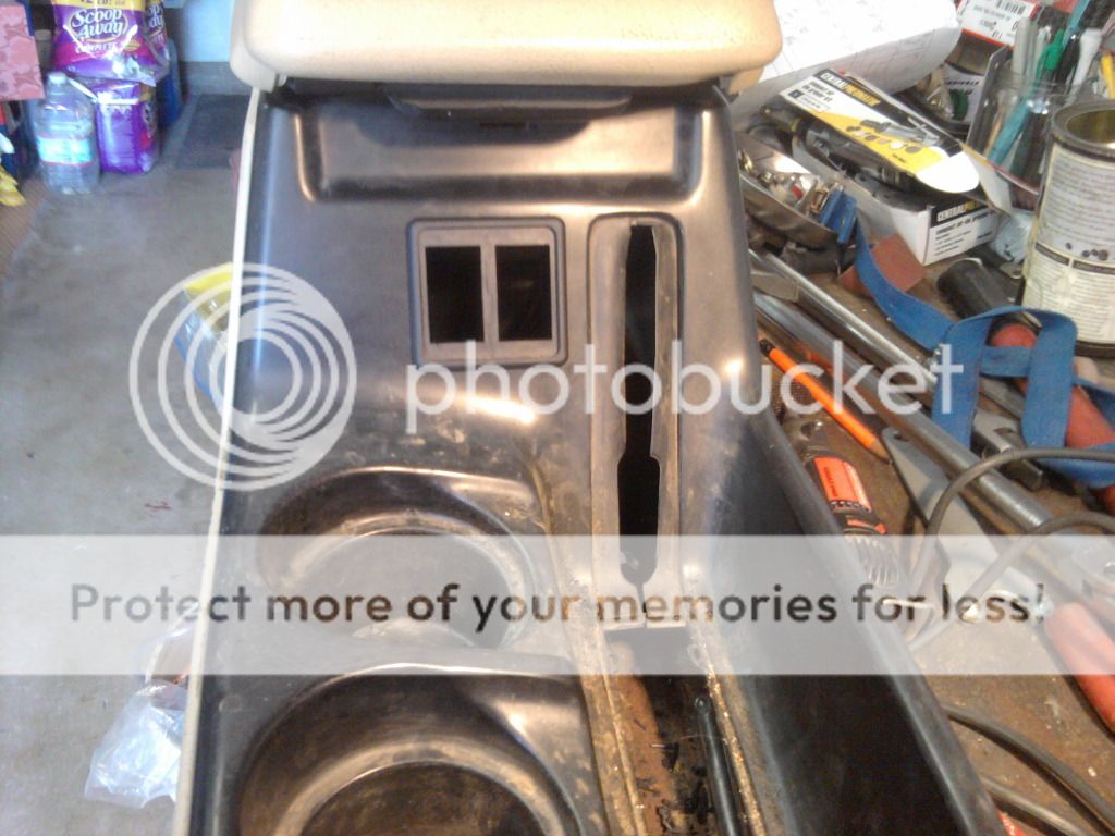

i got my rock lights all wired up and my otrattw.com switches
a top view

Isn't that an AWESOME place to mount your switches!?!

sure is, it was either there or where the VIC is i'm too lazy to remove that just yet.

alright minor update i guess, i found my track bar noise which turned out to be the hiem joint going bad so i replaced it and all is good as new. i got to test the light bar and rock lights they are amazing! for what the rock lights are they are bright.

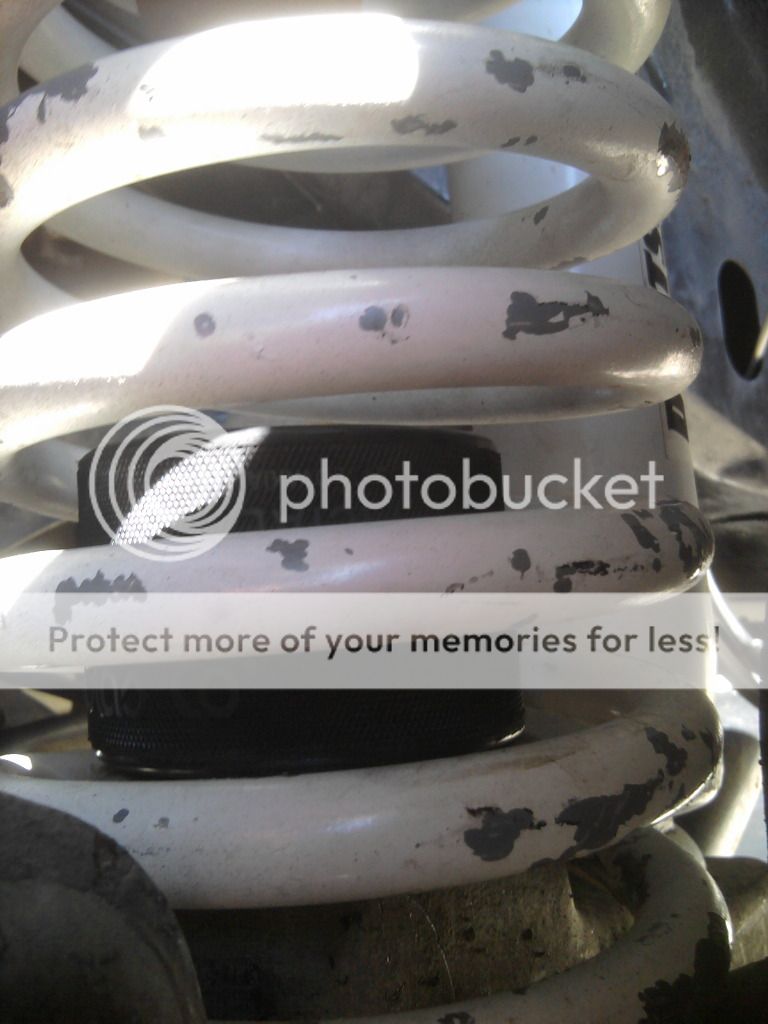

i put some bumpstops on to stop the tb from hitting the diff cover ( i'll give someone a high five if they can figure out what my bumpstops are)

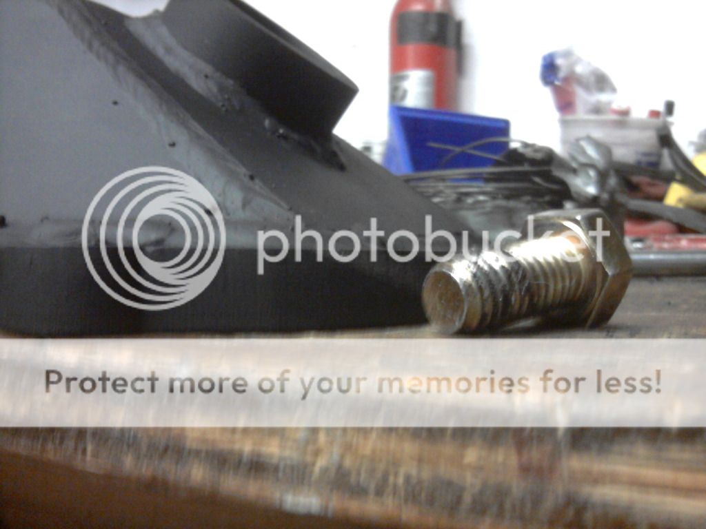

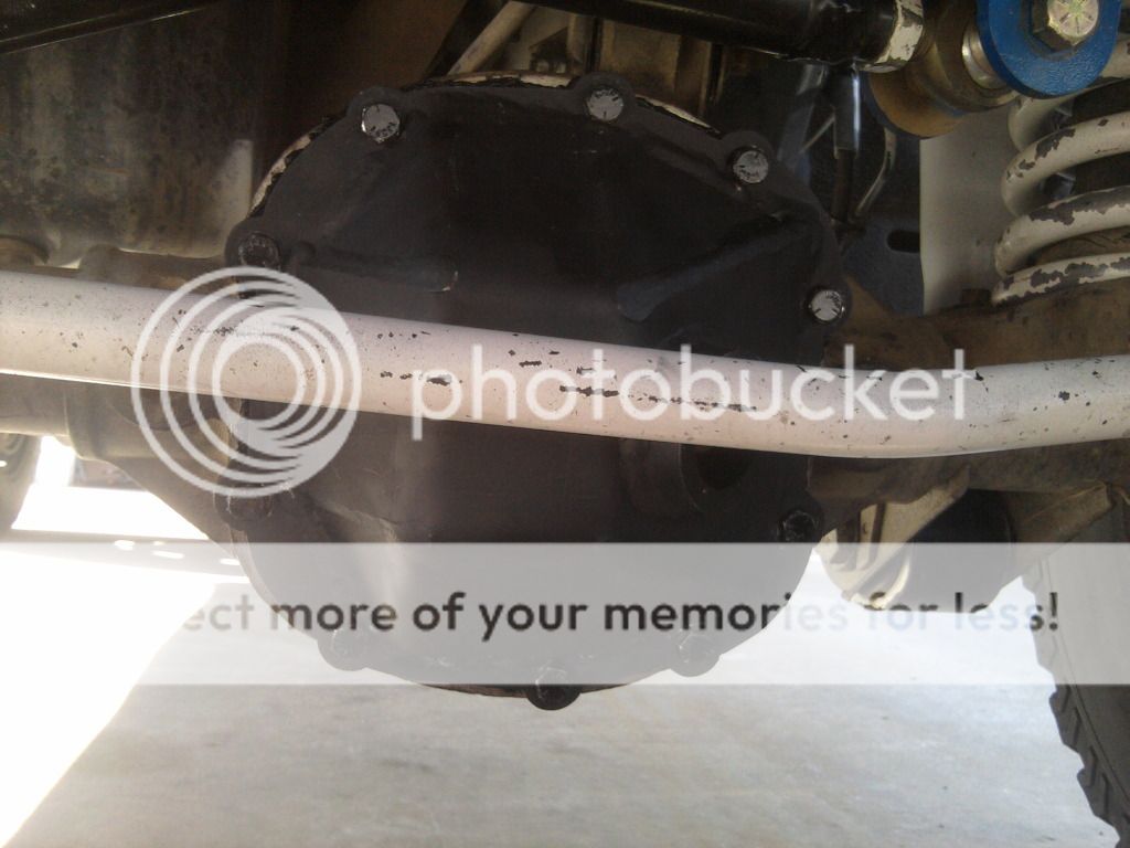

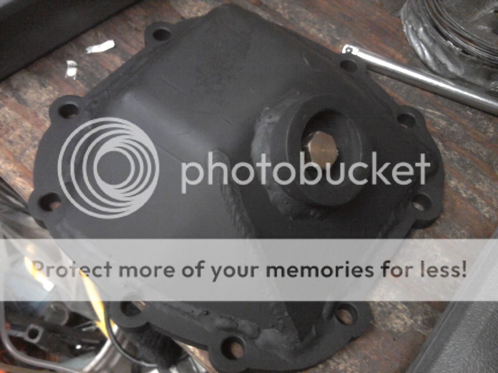

oh and i got this all natural 100% beefy diff cover
and yes that is a 1/2" bolt
surprisingly enough with that ring around the fill plug it clears the steering (just)

Originally Posted by GCjunkie93 View Post
Is that a RuffStuff cover? Beefy as **** that's for sure.
E: hockey pucks
actually its not ruffstuff, my buddy said it was some diff cover off ebay but truth be told if i didn't get it for 50 bucks i would say get ruff stuff. this one the welds are right in the way of your socket trying to get the bolts on, and one of the holes didn't line up so i had to up drill the holes and then it fit fine.
yup! we have a winner

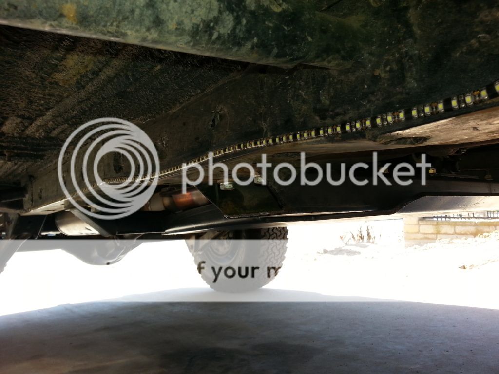

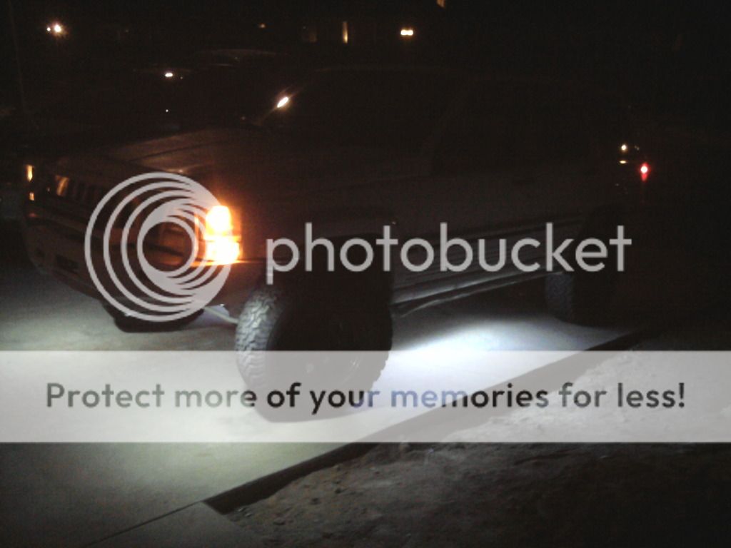

well i realized i never showed you guys what i used for rock lights
how bright it is under it
