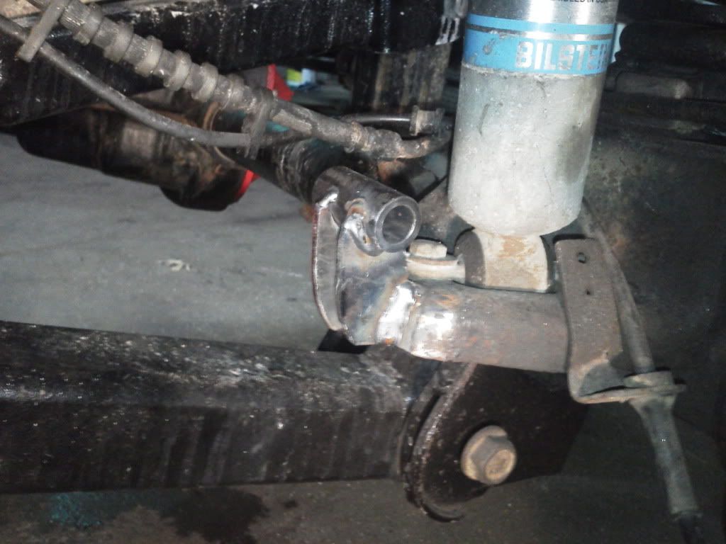

I ordered the limit straps from poly performance yesterday. So today I got the pieces for the front lower strap brackets cut and everything tacked together.
Where they will be mounted.

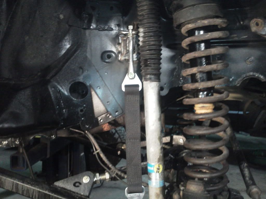

Ive been super busy at work with a lot of side work. But finally got to give the jeep some love today. The poly performance straps came in, so I was able to get the front mounts all welded up

Got the rear lower strap links welded up today. I also got the rear upper mounts welded in as well. I don't know how, but for some reason I was way off on my rear strap measurement. I needed 14" but for some reason I came up with 17". Either way, the correct rear straps are already ordered from poly. It's gonna be down to the wire, but I should be making the black Friday ride in wellsville next week.
Rear lower mounts tacked together
Rear upper mount welded in place.
