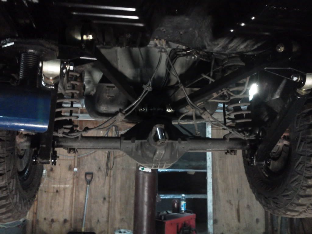

And the trophy for the worlds longest clayton long arm install goes too...... TJSWJ!
And Im still not finished. Rear arms are all in. Still have to burn off all the original brackets, then clean and paint those spots. Then go put it on the alignment rack to make any final adjustments and tighten everything down. Then the suspension is condidered done!
Only thing Im concerned about is the front brake lines, even at normal droop on the rack (sway bar connected) the look WAY too tight! I think im going to order a set of braided stainless ones from Iron Rock, unless anyone else has a better idea.....?
Edit: looks like Clayton offers braided lines as well. I'll be ordering those once I get an email back from them confirming compatibility. I like the fact that they are Clayton, but more cause they are red.
Pics!
(yes, while taking the last pic I realized that I accidently ran the e-brake cables and abs sensors under the upper arms. They belong on top.)
