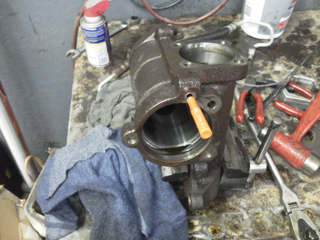

Started taking the box apart today. I plan on doing a small writeup once everything is complete.

The steering box tap is under way, I have one of the holes drilled, and should be drilling the second today on my lunch break, and hopefully tapping/assembling tomorrow. Im holding back all the pictures ive taken that way I can do a writeup for anyone interested.
Got a psc 1.5" bore 6" stroke ram on the way. Now all that is left to figure out is the plumbing. Ive decided to go with all summit racing brand hoses and reusable/swivel AN fittings since I dont have any local place to by hydraulic stuff. While im at it (and because ive spent to much time doing re-search on pirate), ive decided to run all rebuildable AN hoses throughout the whole powersteering system (yes Greg, i was spying on your build thread ). That should make trail repairs a lot easeier. That being the case ill be ordering AN adapter fittings for the gear box and the power steering pump (im saving all the part numbers case you guys want to go this route too).
Ive also figured out my pump situation. I spent about 2 hours last night reading over on pirate, and I found a little secret. The pumps for the wj's equipped with a hydraulic fan (most wj limiteds) came with a factory ported powersteering pump. Apparently the fan draws an excessive amount of fluid, so jeep had to modify the normal tc pump in order to keep up. The best part is that it will bolt in place of the non hi output (non hydro fan) powersteering pump and is about 1/4 the cost of an aftermarket high output pump. The only thing you have to do is either a) block of the second fluid return port or B) swap your original reservoir over using a piece of 5/16th's hose as a big "o-ring". Ill probably just plug the extra port off. Stay tuned.
