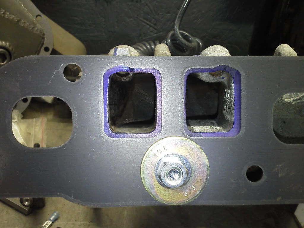

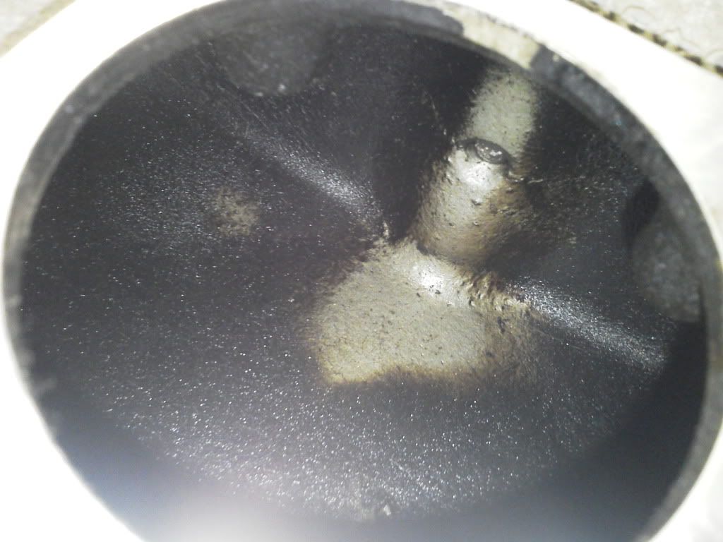

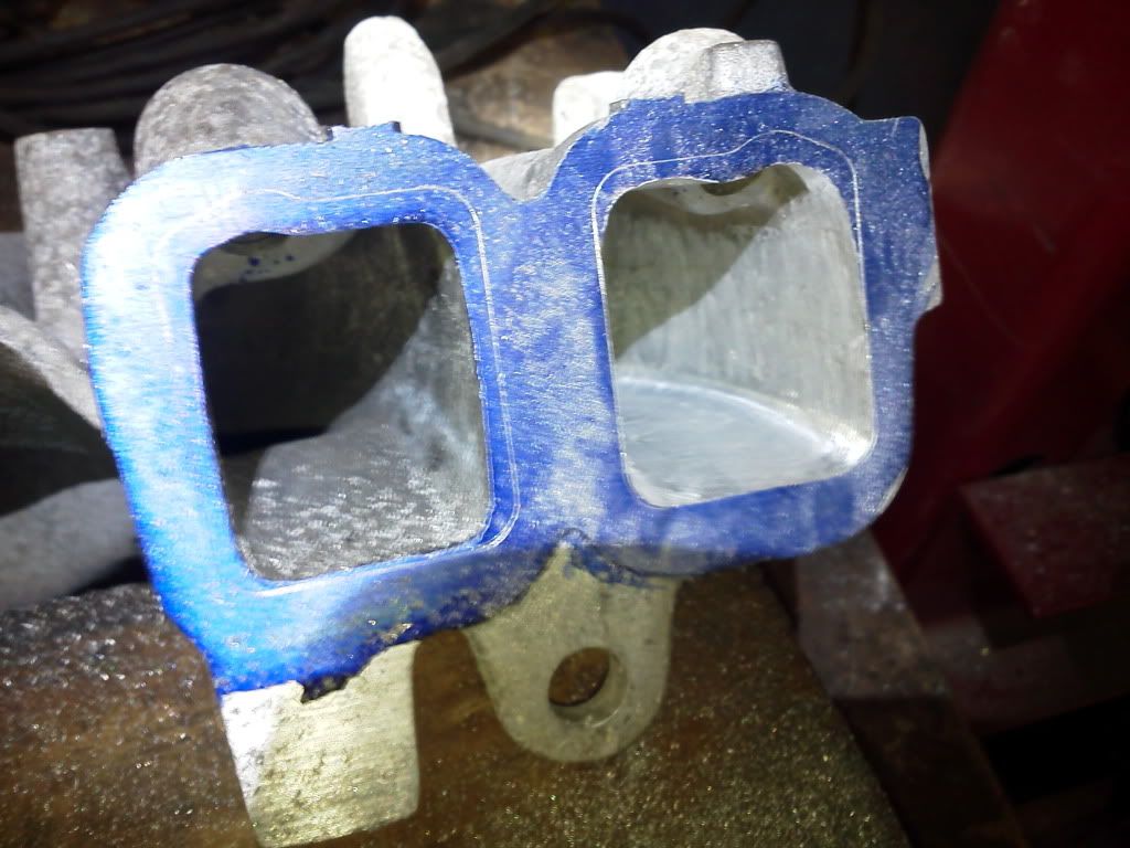

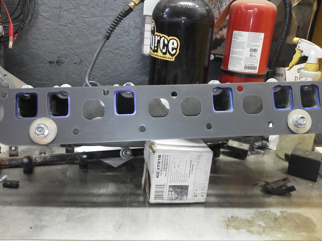

Got my intake back from cleaning today so I started on my next mini project. The gasket match and polish.
Before cleaning
After
DyeKem layout compound on ports
Gasket mounted so that I can mark my lines with a scribe.
You can see how much bigger the gaskets ports are compared to the actual intake ports. All the blue in between the gasket and port will be gone once complete

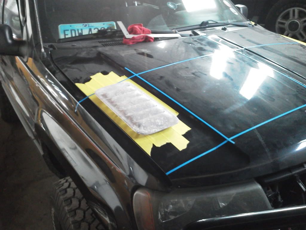

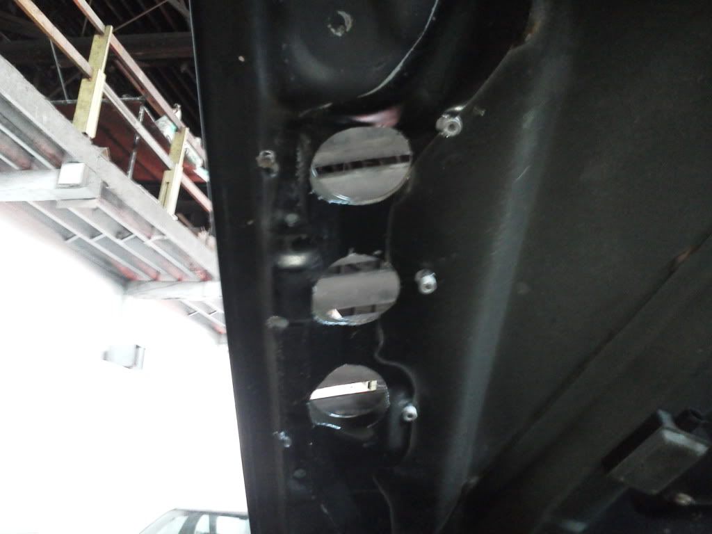

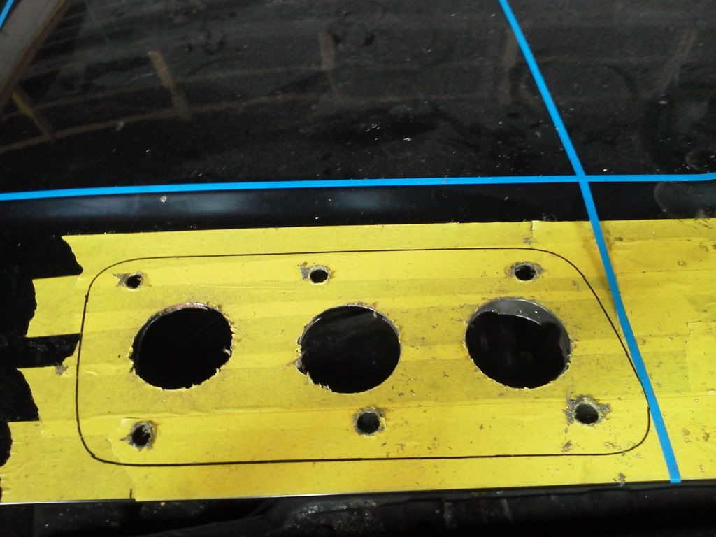

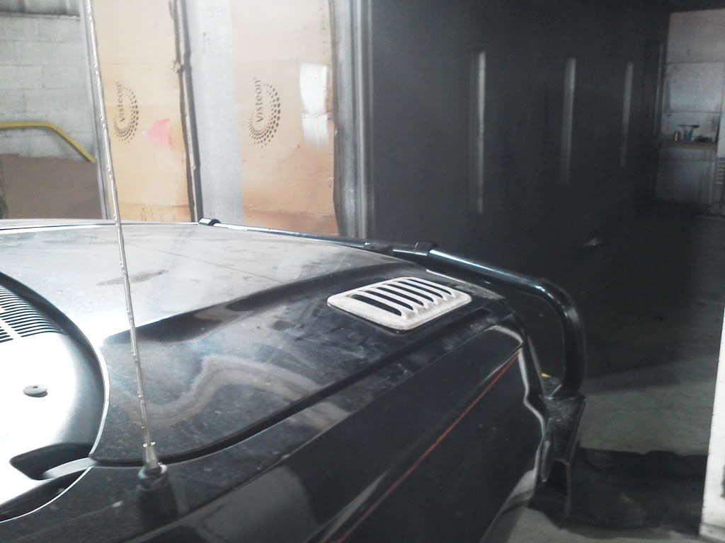

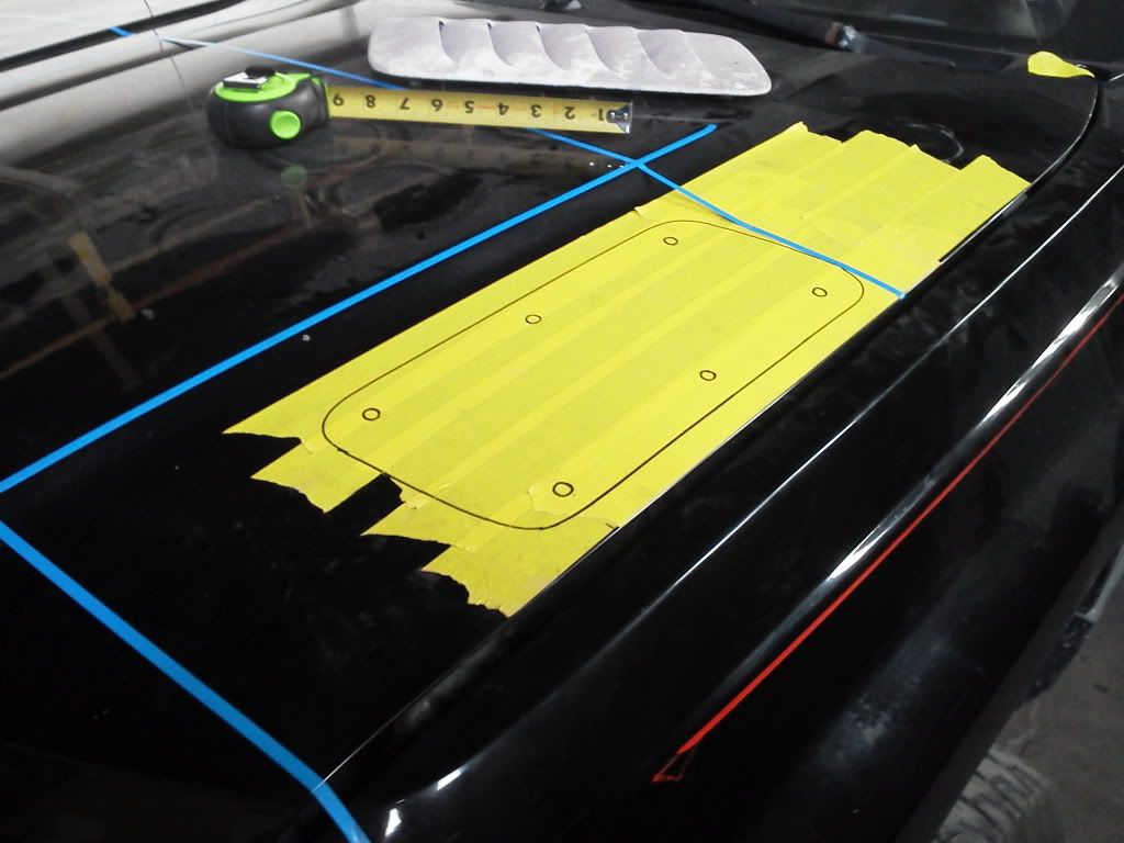

There were a few things I ran into. First being that I wanted the vents where they would be found on a 5.9L zj (since thats what they are from) I spent a good bit of time trying to find info on placement. Then after transferring the zj measurements to the wj, the vents werent in an ideal position to make fastening easy. My thought process was to put them where I wanted them (same as the zj location), cut the holes, then figure out how to secure them.
The next issue with the install was cutting into a perfectly good hood. I probably spent 2 hours measuring and adjusting and measuring and measuring before I finally made the first cut.
Lastly was fastening them. When I bought the vents, they came with drip trays too. As badly as I wanted to keep the drip trays, it just wasnt possible because of where I mounted them. I trimmed and trimmed the trays to the point where they wouldnt even serve their intended purpose but they still wouldnt allow the hood to close. I ended up just cutting mounting nubs off of the trays, and using the nubs to secure the vents to the hood.
Here are some pics
Guess I dont have any pics of the drip tray nubs I used to fasten them, ill get you some if you would like.

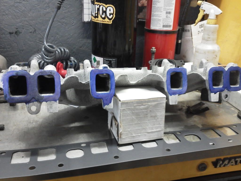

Ive also been slowly working on the intake port and polish to get that ready to go in when I do the camshaft upgrade.
1 port half done
1st port done aside from the polish. That wont be done untill very last though. This is a good pic to show how much bigger in comparison the port is compared to stock (on right)
second port roughed in
Its a long process, especially when im doing it 30 min at a time on my lunch break lol.
