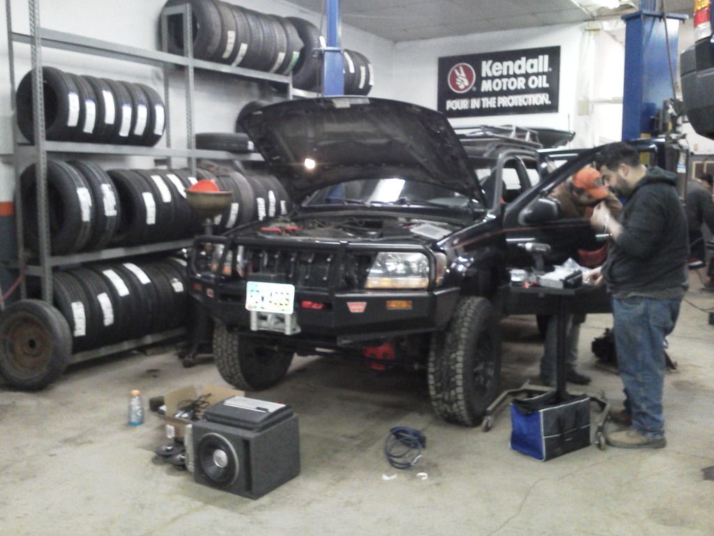

Buddy of mine (TroubleNEO) came to my shop today to do a full audio install while I was working. Nothing insane, just enough to sound good real good with the windows down.
more pics when its all finished
