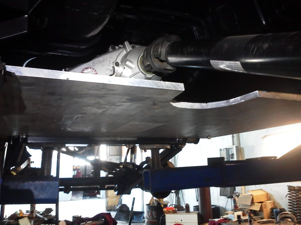

Skid plat is all finished, I just havent installed it yet because I still need to run a new t-case shifter cable and my front driveshaft. But If you want Ill throw it up there tomorrow and snap a few pics for ya.

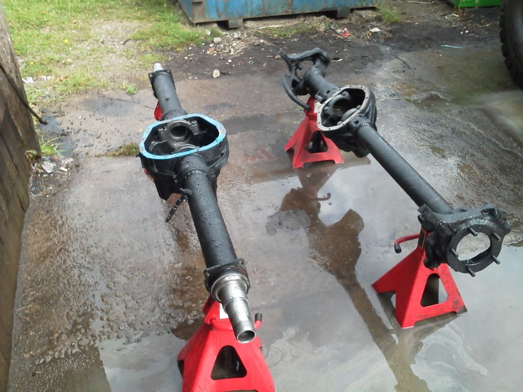

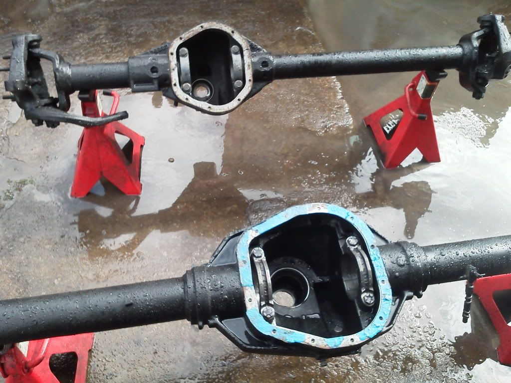

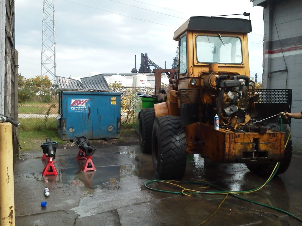

Had the pressure washer out cleaning up our loader, so I gave the diffs a good cleaning to get all the sand out from blasting.

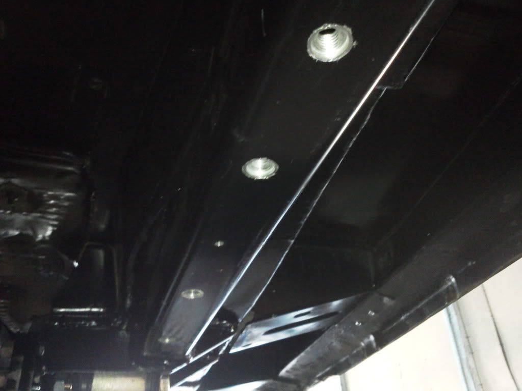

The riv nuts worked beautifully! I tested one in a spare piece of 3/16th (same thickness are frame stiffeners). I torqued it to 70, then 80, 85, 86, and at 87 ft lbs the riv nut finally snapped in half. I don't plan on tightening my skid any more than 40-45 ft lbs, but it's great knowing the abuse they can take.

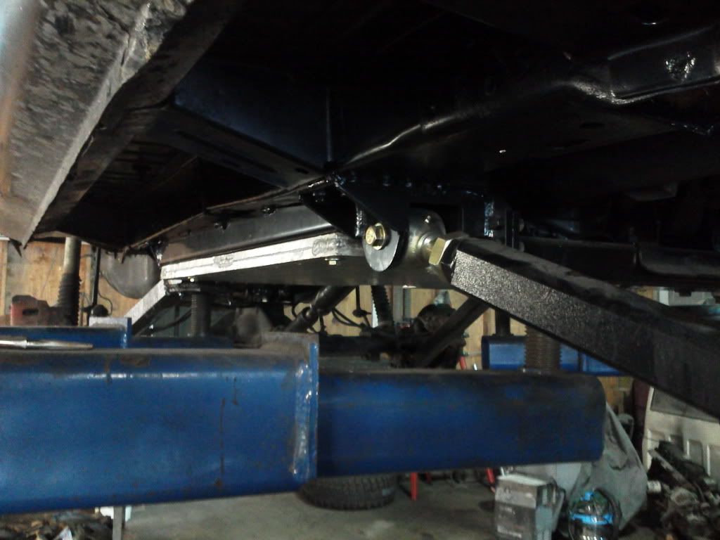

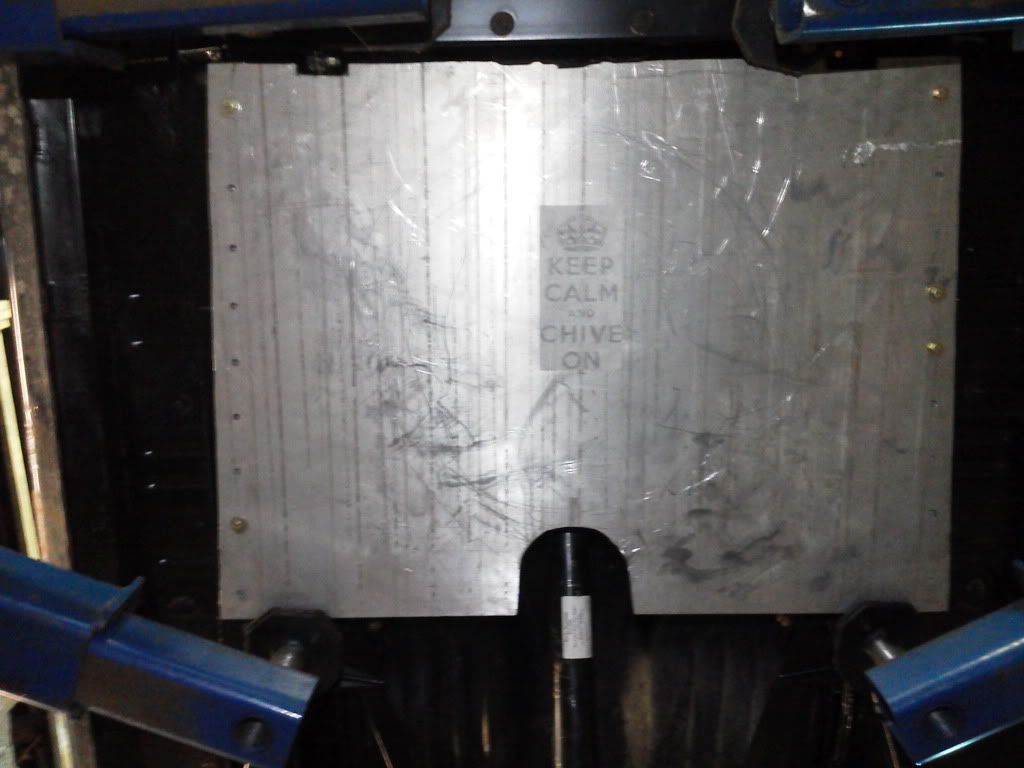

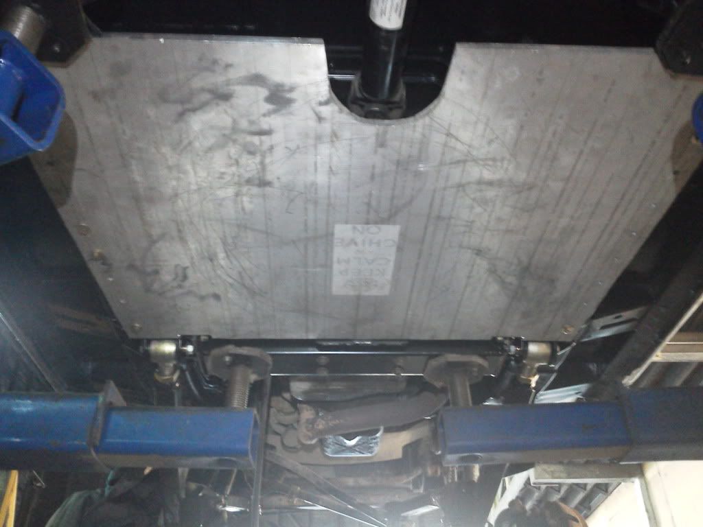

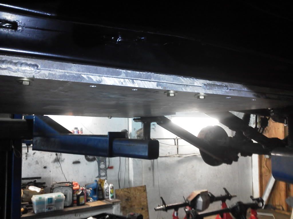

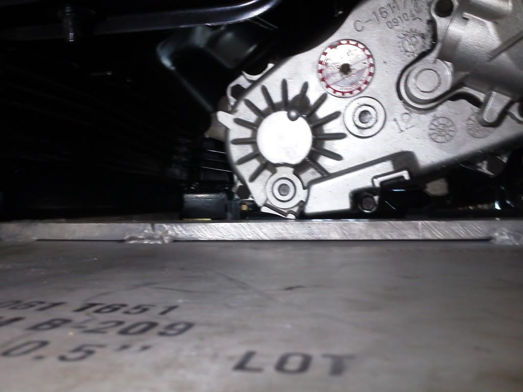

Here ya go.
Riv Nuts
Skid

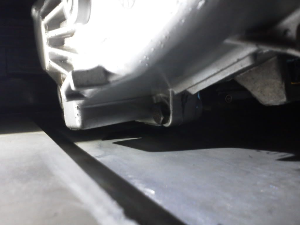

There are 9 holes drilled on each side of the skid. I decided to only drill 6 into the frame rail stiffeners. I was worried that 9 5/8 holes would weaken them

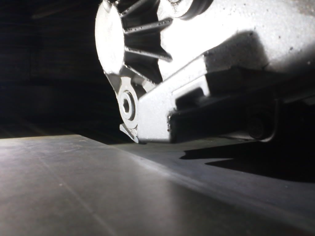

Clearence for t-case. There is 5/8" between the bottom of the skid and the case. I got the reinforcement extra close so I have no worries about the two ever meeting.
Let me know if you have any more questions

post #338 of 389 Old 10-08-2013, 02:17 PM
CRJEeP_wj
2002 WJ
Join Date: Sep 2012
Location: oroville
Posts: 703
Man that looks great, you did a very solid clean job. The 231 case must be clocked higher that the 242hd cause your almost flat and still have room. Thanks for the pics!

post #339 of 389 Old 10-08-2013, 02:18 PM Thread Starter
TJSWJ
2001 WJ
Location: Olmsted Falls
Posts: 2,271
Thank you sir. Yeah, I cant tell if the 231 clocks a little higher, or if the clayton stiffeners sit down lower.

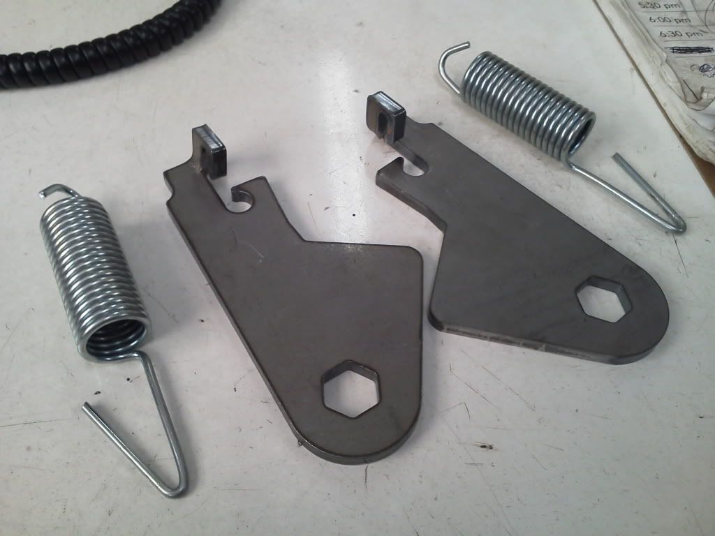

Got the e-brake springs and levers from blackbird. Ill just have to fab the cable mounts, but those are easy.

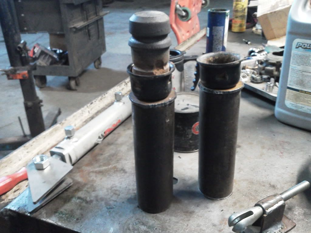

Also made some progress on my lunch break today. Got the tubes cut, and the caps cut and drilled for my front bumpstop/coil retainers. Gonna weld them up tonight hopefully. After that, just have to torque everything, run the t-case cable, get limit straps, and go wheel!
