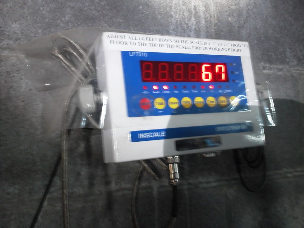

Also weighed it. It's a little heavier then I expected, but I'm still plenty happy with it.
The IRO skid was 42 pounds. This skid is 25 pounds heavier, but offers 3 times the protection, and tucks up higher. Overall I'm happy with it.

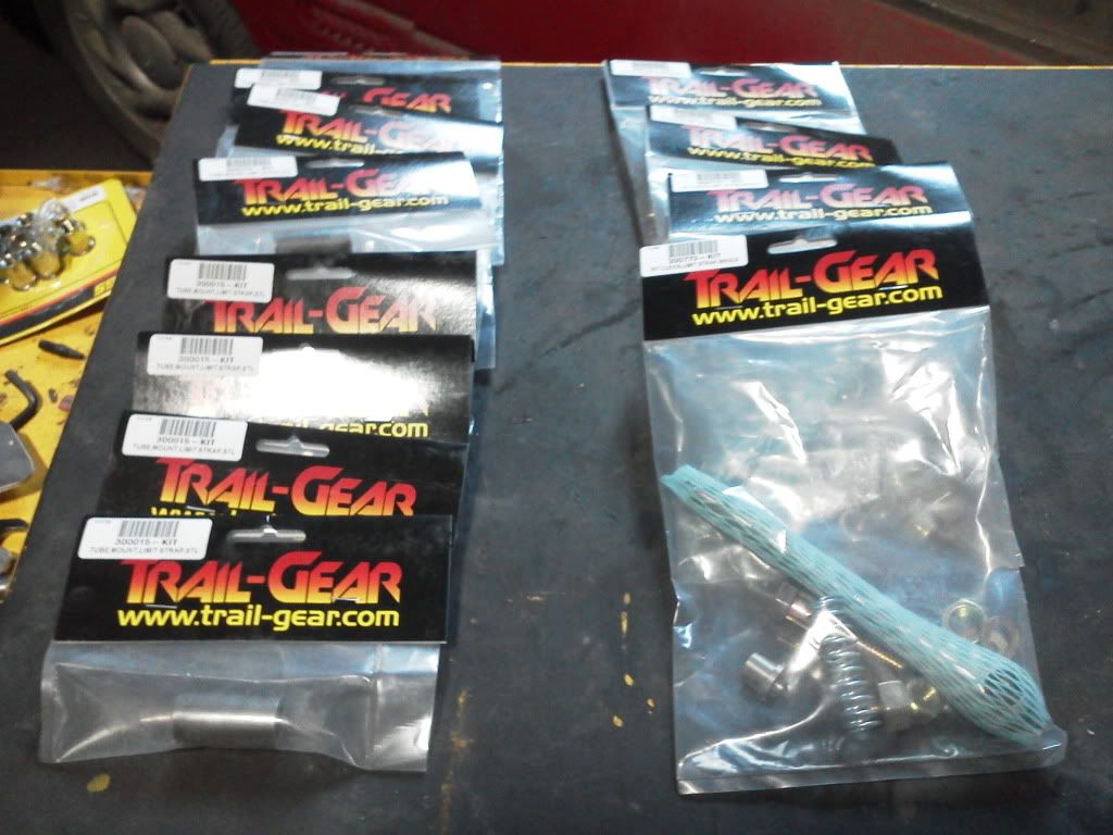

Ive come to the conclusion/realization tha the wj might be on the rack for a little while. Im just going to get done the things that need to be done and not rush it. Its already down, so might as well make it how I want it now (or how I can afforde it), and worry about wheeling once its ready. Its just getting to be to difficutl to balance a family life (2yr old that waits for me to come home), work (55-60hrs), and the wj. It will be finished when its finished. That being said....
The trail gear limit strap clevis's came in from poly performance. I ordered 4 clevis's (2 front, 2 rear) as well as 8 mounting tubes. I ordered 8 tubes because not only are they for mounting the clevis, but I can weld them to the axles to support bolts properly for a limit strap lower mounting point. Most people just run the limit straps shock bolt to shock bolt, but the way the wj is designed it just doesnt allow it. The front shocks are stud mount uppers, bar pin lowers. The rears have eyes on each end, but the uppper mount doesnt look strong enough to hold up to limit strap duty. Thats why I went with the clevis mounts.
