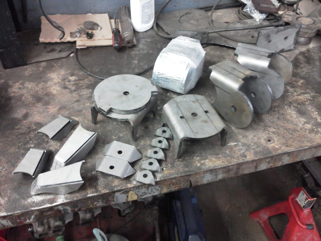

I did get some brackets in from Ballistic fab. Coil mounts, lower control arms mounts and some other misc fun stuff. I was going to go ruffstuff, but Ballistic's prices were cheaper than Ruffstuff's on sale pricing, and the brackets I wanted just looked a lot beefier coming from Ballistic.
Once Greg gets me a quote on a truss and upper control arm mounts, Ill have gathered everything I need for mock up on the axles. After that I can start saving for gears and lockers and get those bad boys in.

Ballistic brackets are probably nicer than the ruff stuff anyway.

They seem a lot nicer. I really like how they add the gussets to the link mounts, and the little plate that holds the bolt inside the coil buckets so you dont need a wrench. Its little things like that, that show the thought that went into them. I just couldnt believe that the normal price was cheaper than ruffstuffs 4th of july sale pricing.

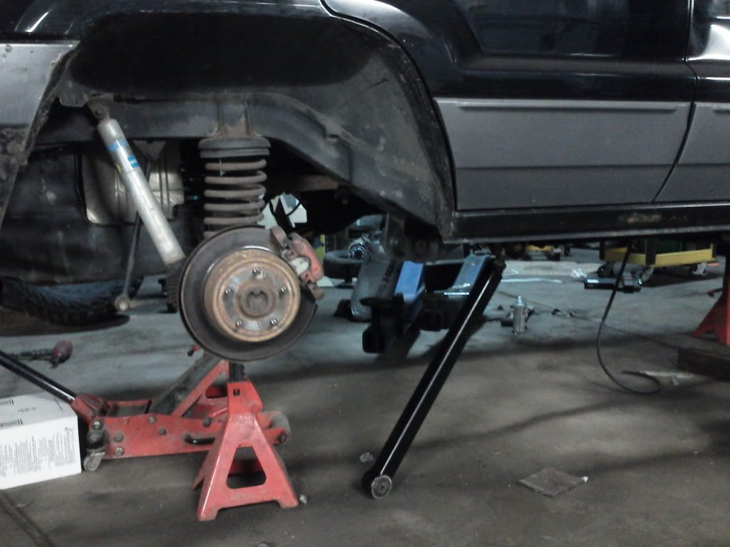

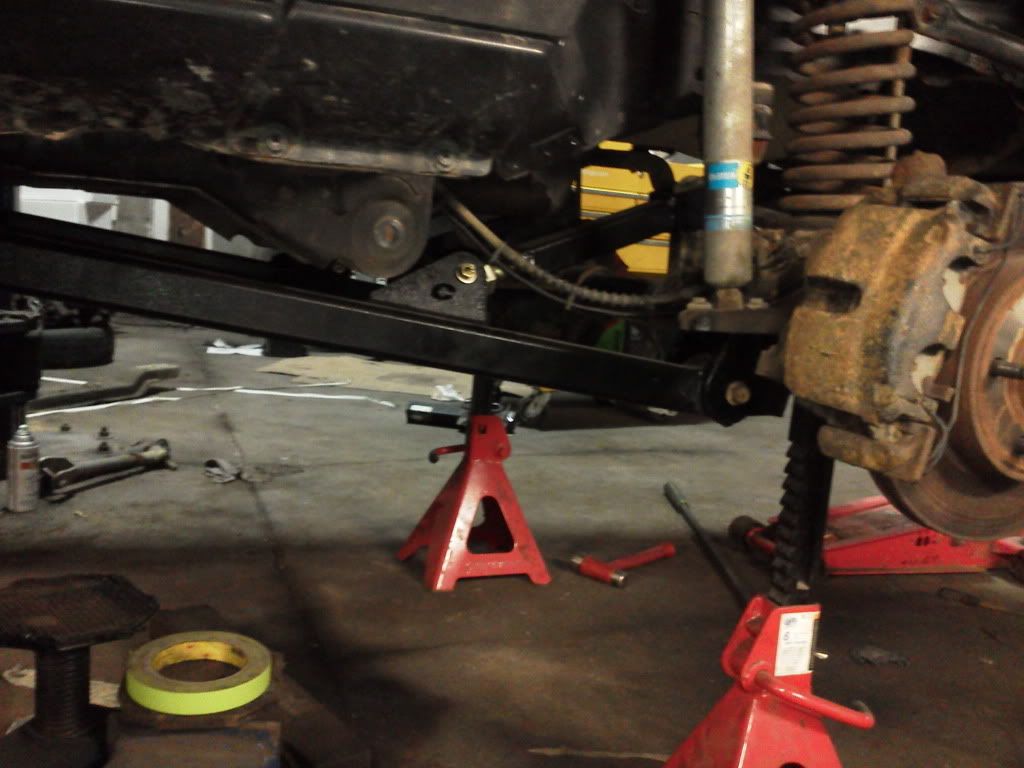

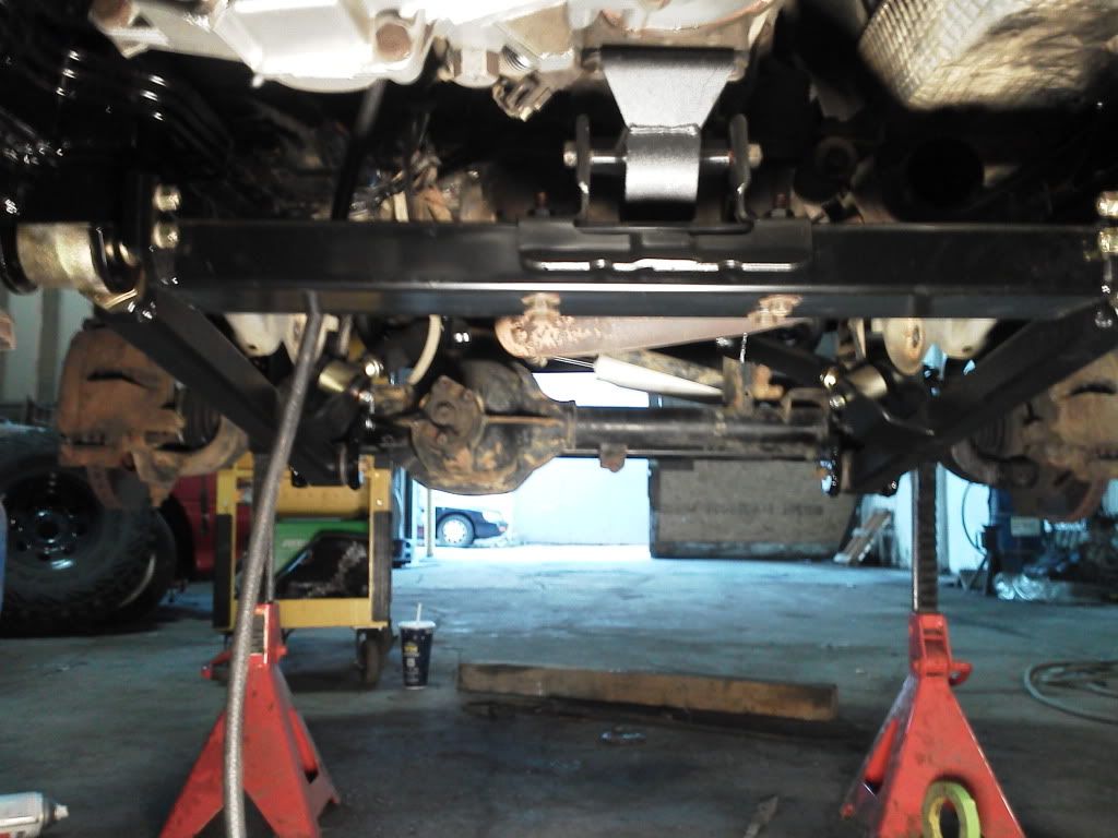

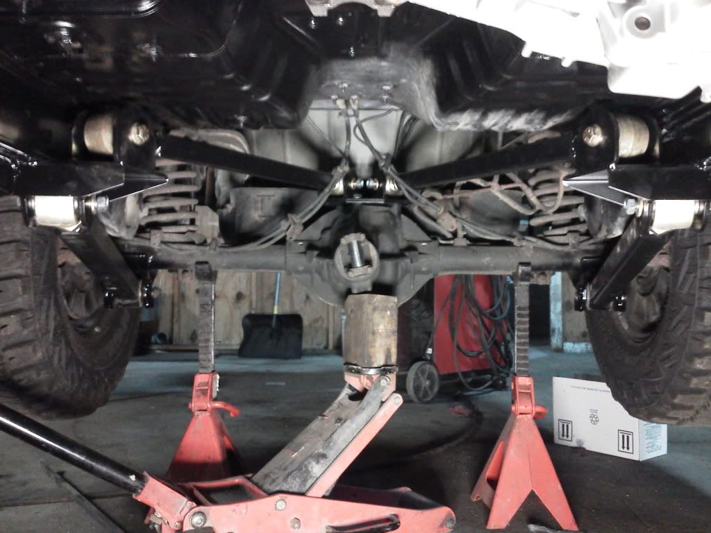

And the trophy for the worlds longest clayton long arm install goes too...... TJSWJ!
And Im still not finished. Rear arms are all in. Still have to burn off all the original brackets, then clean and paint those spots. Then go put it on the alignment rack to make any final adjustments and tighten everything down. Then the suspension is condidered done!
Only thing Im concerned about is the front brake lines, even at normal droop on the rack (sway bar connected) the look WAY too tight! I think im going to order a set of braided stainless ones from Iron Rock, unless anyone else has a better idea.....?
Edit: looks like Clayton offers braided lines as well. I'll be ordering those once I get an email back from them confirming compatibility. I like the fact that they are Clayton, but more cause they are red.
Pics!
(yes, while taking the last pic I realized that I accidently ran the e-brake cables and abs sensors under the upper arms. They belong on top.)
TJSWJ is offline

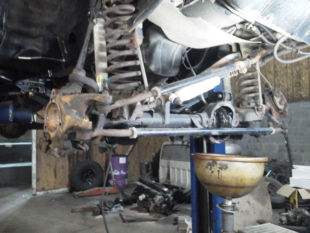

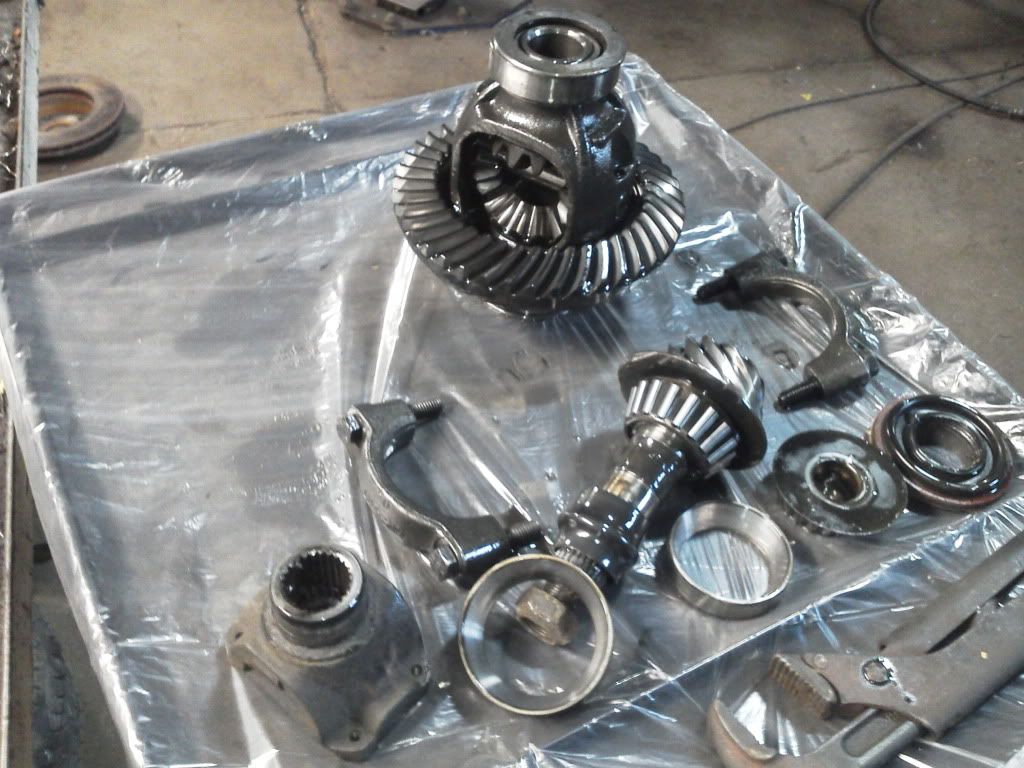

Got all the old brackets cut off and cleaned up (gotta love plasma cutters!). Started working on the front diff. Its getting new inner axle seals (been leaking a while), new pinion bearings, and since im going to be in there I decided to put a spartan locker in it. Locker was supposed to be here today, but for some reason its held up in MN

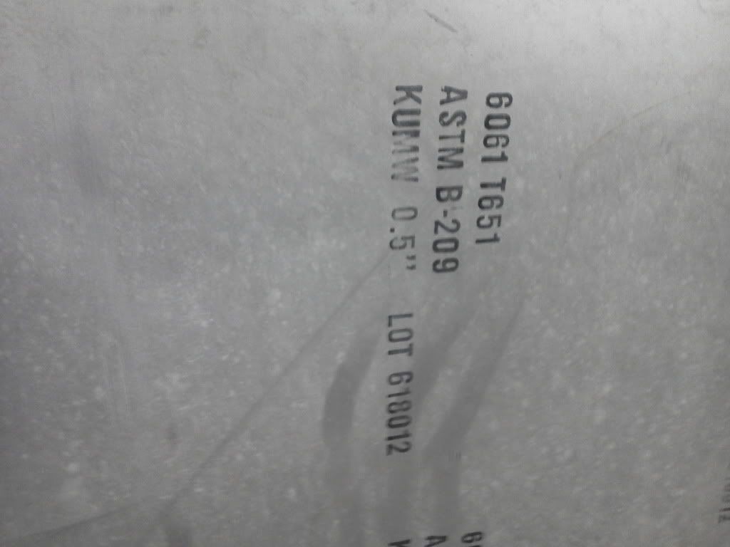

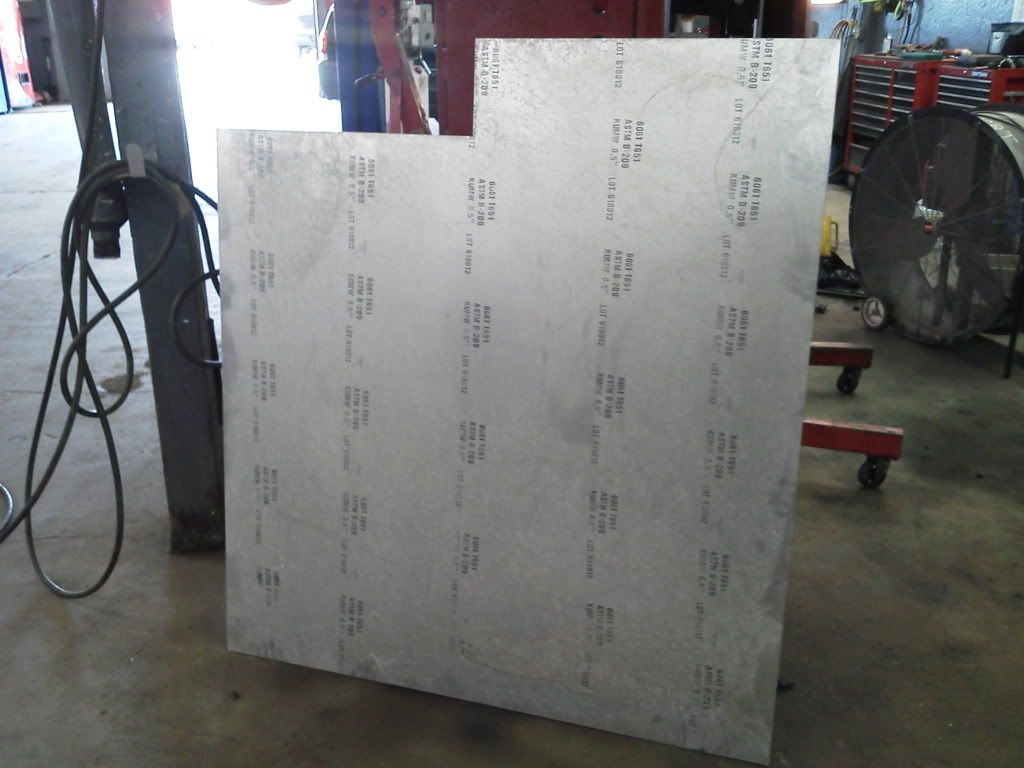

Also picked up the 1/2" 6061 aluminum for the belly skid

Started the pinion bearing, axle seal, and lockright install.
gotta have the coffee
Of course autozone wasnt paying attention and sent me the wrong pinion bearing, so that put a damper on my night. I did get the inner axle seals installed though. Those were a breeze with the right tool.

How much did the aluminum cost you? Did they charge by weight or size?

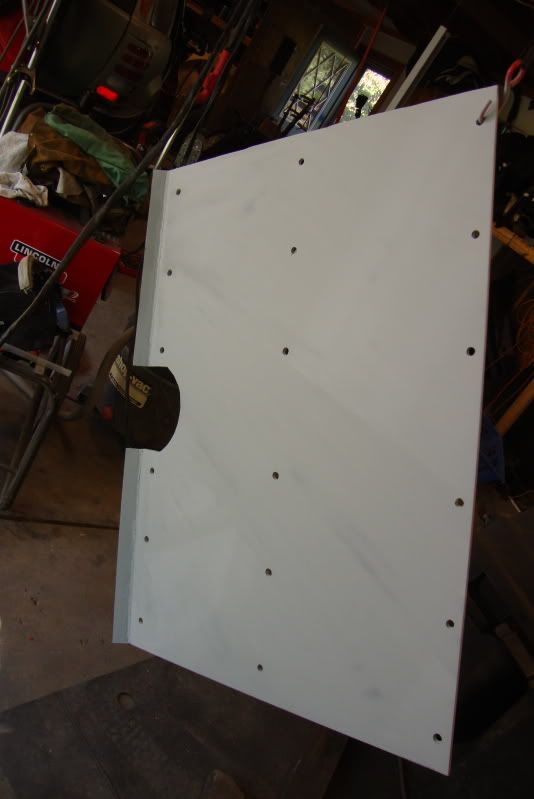

A friend of mine runs a fab shop and needed some parts from me for his jeep so we did some trading on the aluminum. But, he originally quoted me 250 for a 40x40 section of 1/2 thick 6061. I'm not really sure which way he figured the price. Although I will say that the piece I got is a he'll of a lot heavier than I expected from aluminum. Once I get the skid fanned up I'm going to weigh it to compare against IRO's t-case skid that I had.

Interested to see yours and how much it weighs.

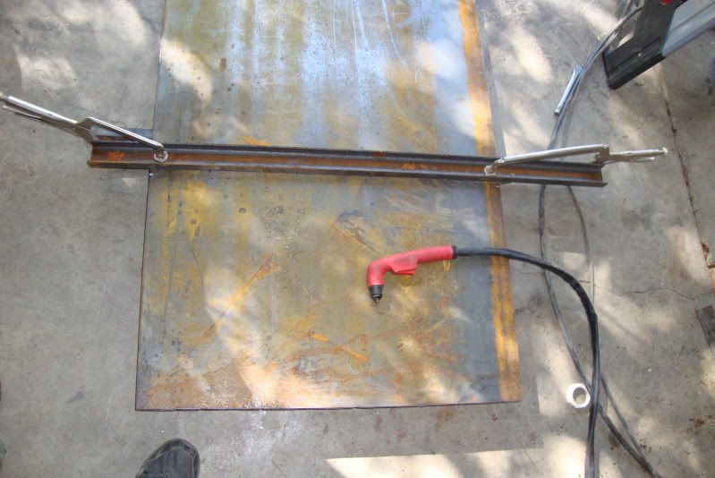

I made mine out of 3/16" plate. It was rejected steel @ .54 a lb. Weighs in just over 50lbs. Still have a couple big chunks left.
Left overs... 24x30 and 60x30 with a chunk missing.
