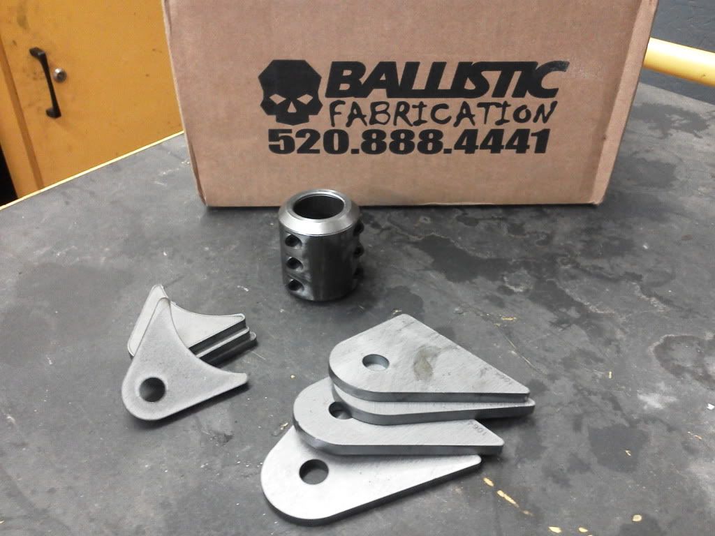

Got the correct box fittings from summit.
If anyone else wants to convert their complete power steering system to accept -6an you need 2 o-ring adapter fittings. The inlet is 11/16-18 o-ring seal (russell part# 648040) and the outlet is 5/8-18 o-ring seal (russel part#648030)

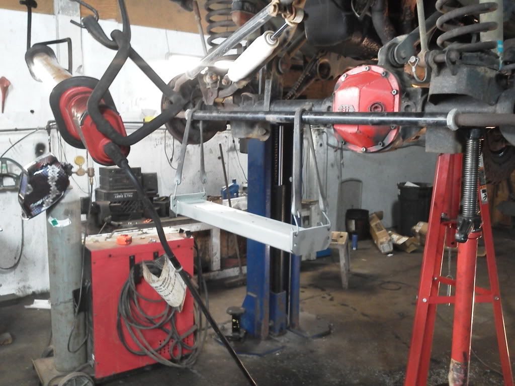

Also got my tube clamp and tabs from Ballistic today. Going to use the tube clamp to mount the ram to the tie rod, along with some of there universal tabs welded to the clamp and to the axle. Also ordered some of their shock tabs for the sterling axle.

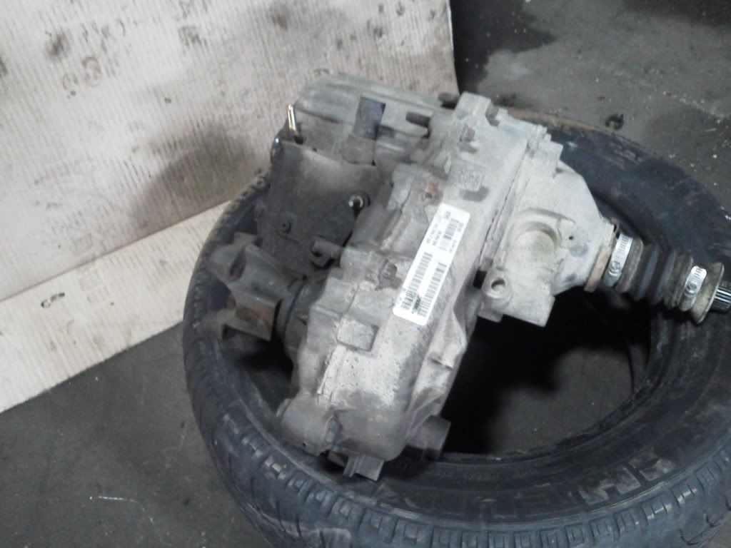

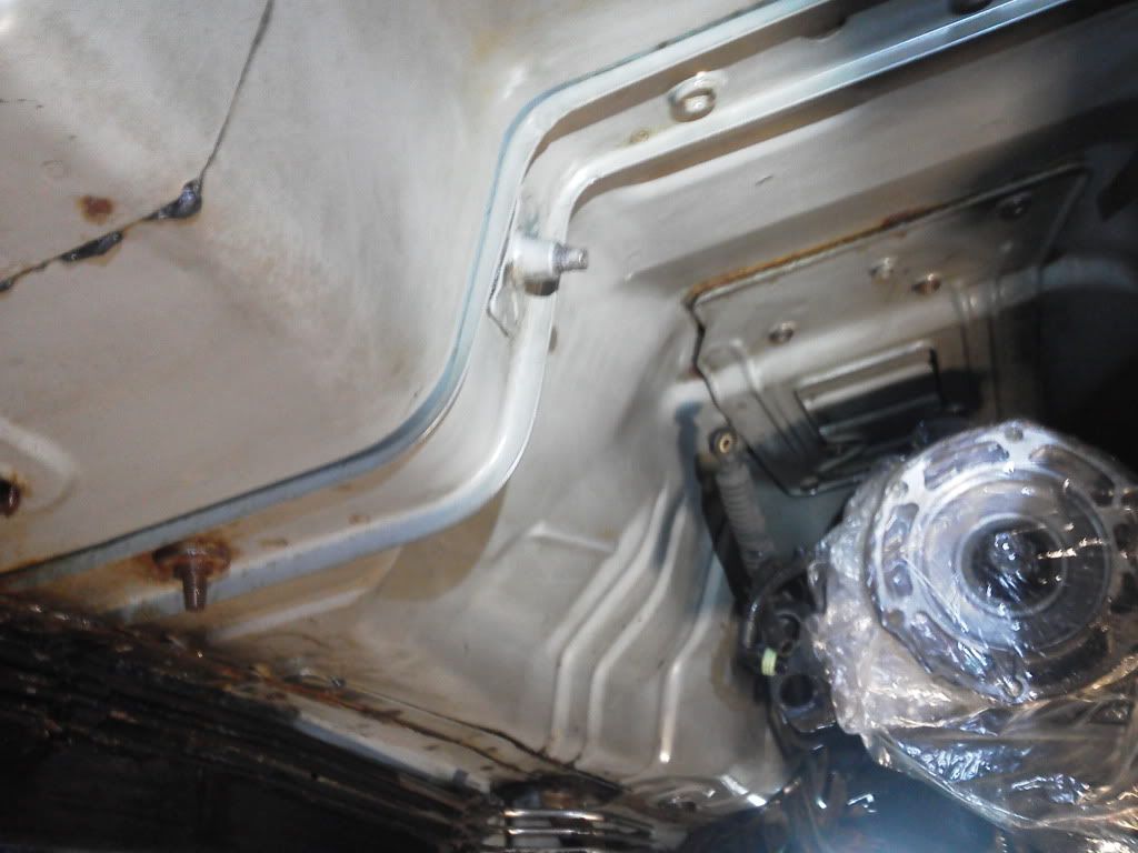

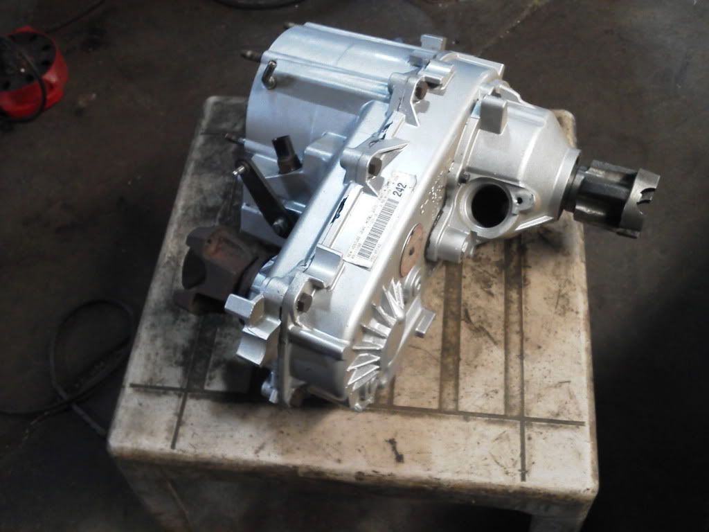

Well, Im behind schedule because we have been way to busy at work for me to get time off for the dub. Yesterday was the first time I got to work on it since I got it on the rack, so i started the 231HD and clayton install.
Old 242 out
231 waiting to go in

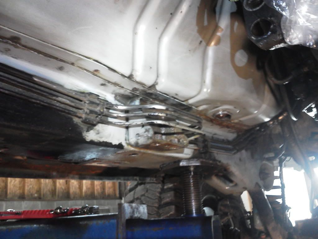

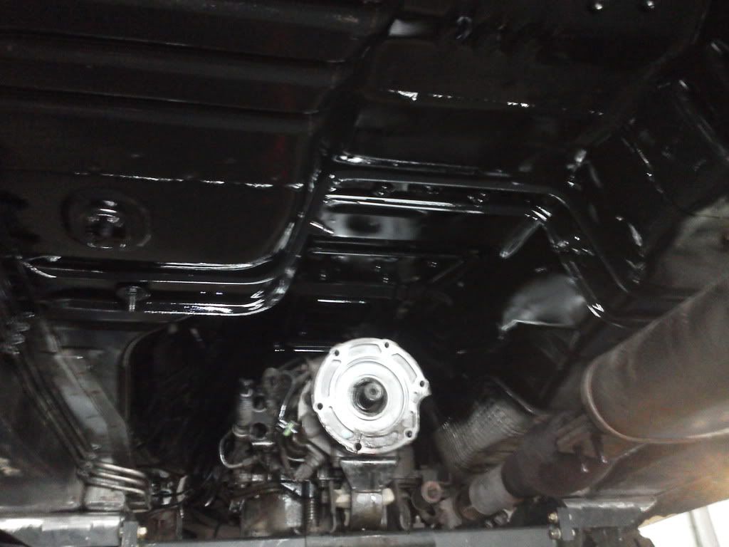

Then, while I had the case out I figured it would be a good time to do some cleaning and get all the muck out from the undercarriage. All clean
As you can see I was starting to get some rust around some of the seems. I know rust is inevitable here in Ohio, but I would like to slow it down as much as possible. I prepped everything, and hit it with a couple coats of rustoleum gloss black rust stopper paint

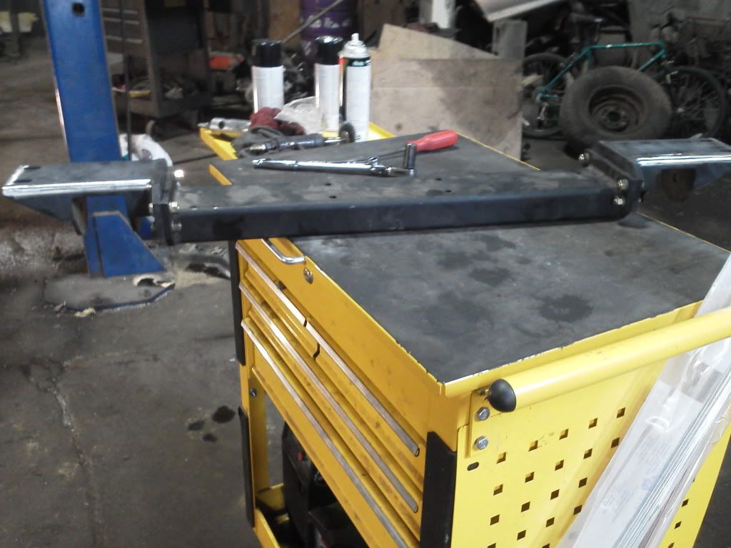

As I was doing that I got the crossmember bolted together and installed, as well as cleaning the surface rust off all the other brackets, then primed and painted them.
Of course the bottle of my mig welder went empty without me realizing it, and everyone is closed for the holiday today. So I should be burning everything in on friday, granted I get the rear brackets installed today. I shouldnt say "I" am burning them in, my brother is a professional welder, and while im good with a welder, im by no means a professional. So he will be doing all my welding for me. He say's he is going to do a mix of TIG and MIG welding on everything as that will provide the most strength.

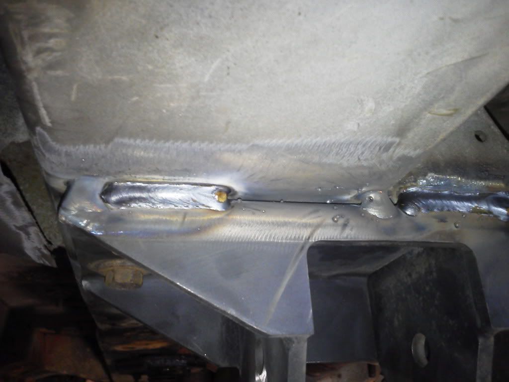

So Ive got this problem where I just cant allow someone else to work on my jeep. I have the know how to do everyhing I could ever want to it, so I wont let anyone touch it. Half the time I wont even let them help me do something.

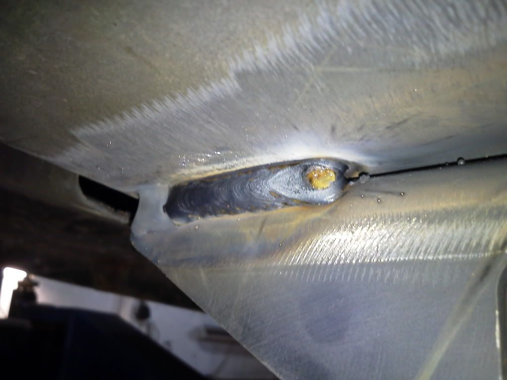

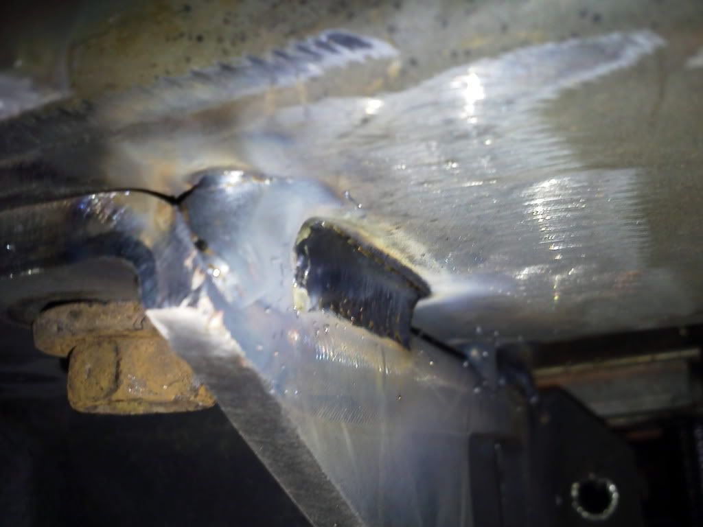

With that said, I stole the argon tank off my 140V mig and put it on the 220v. Then started burning my brackets in. For those of you who have done claytons, did you do 2 passes like they say in the instructions, or just 1?
How do my welds look?
Any constructive criticism is appreciated.

Originally Posted by TJSWJ View Post
Did you run 2 weld passes on the Clayton brackets as well?
No. That is their way to keep from burning through on the frame rails, run a quick, lower heat weld to build the area up then run more heat on the second pass.
I was able to manage the heat to keep from burning through well enough I didn't need to use their technique. Its hard to tell but I'm thinking I put more heat into mine based on discoloration on the brackets.
I did double pass my trusses though, the tubes are thick on these axles.
13 GC Overland - (Wife's DD) 5.7, stock
Past Jeeps: 99TJ, 78CJ7, 91YJ, 01WJ, 03TJ, 05KJ
dillonjm is offline
Good to know. I had no issue with burn through either which was throwing me off. I was just making sure there wasnt something I considering.

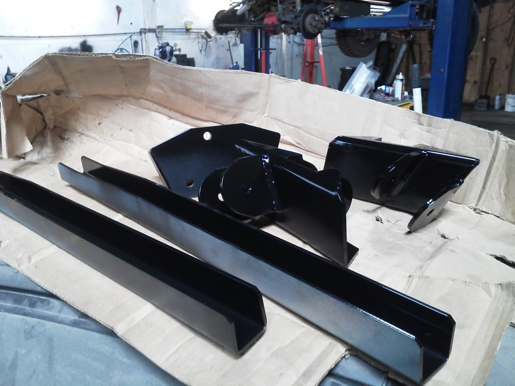

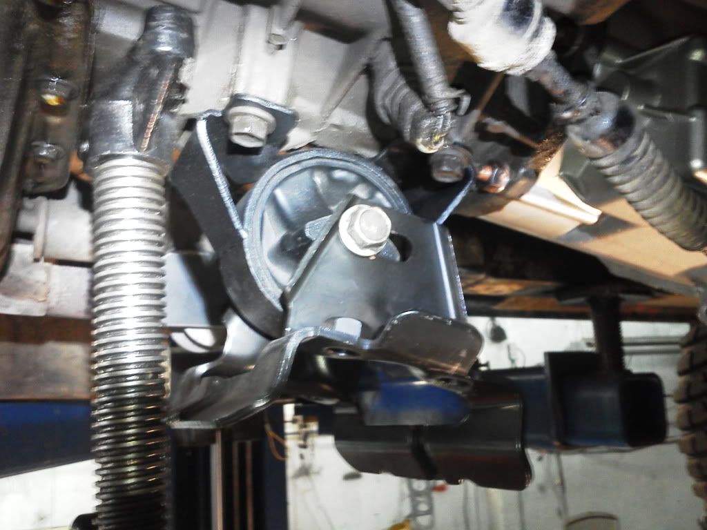

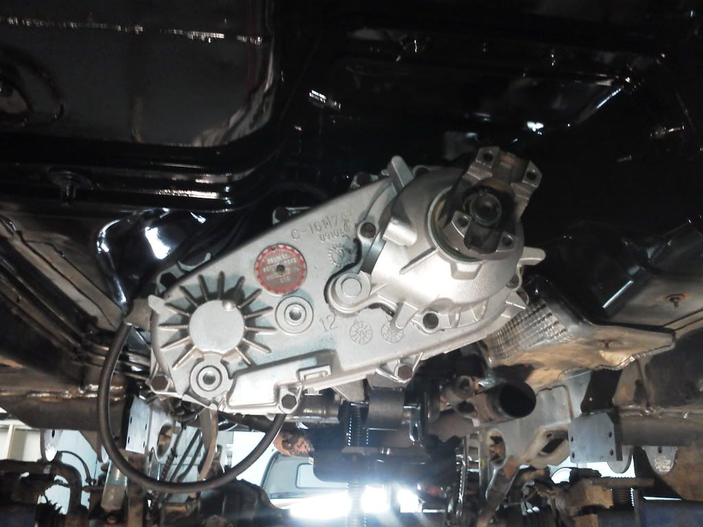

brackets painted
My make shift parts sling. Crossmember in primer
New trans mount
New transfer case in. That long hose you see hanging is for the t-case breather. It the other end goes to the top of the trans bell housing, im extending up next to the master cylinder. You can see the brackets are burned in as well.
