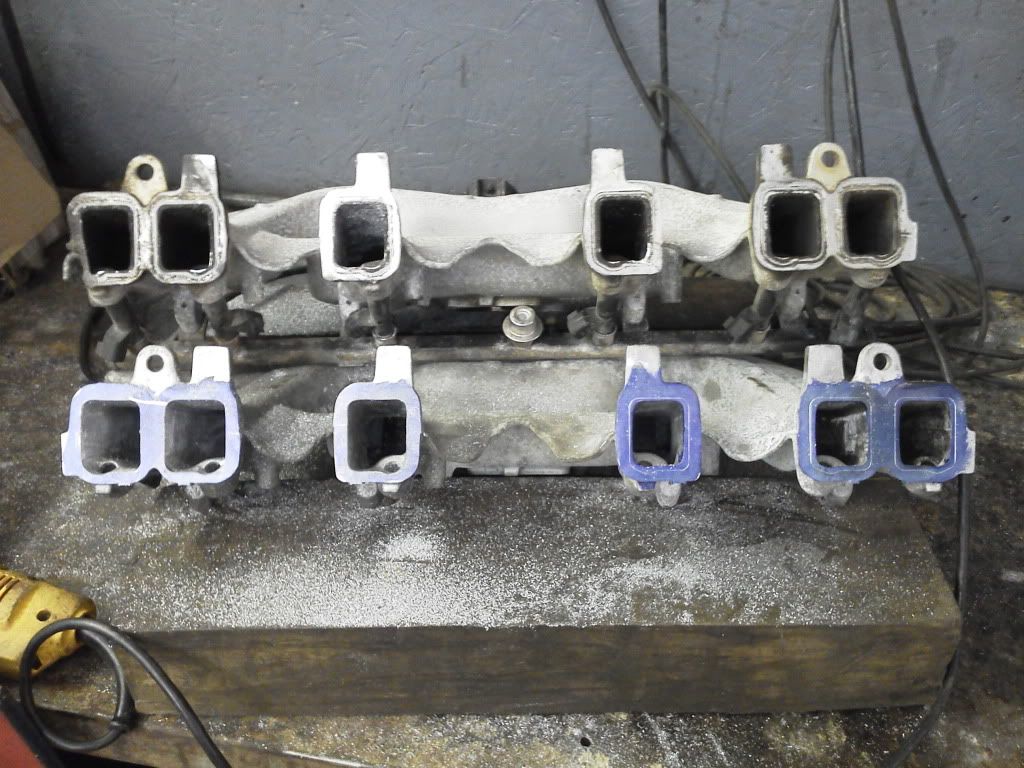

little more progress on the porting process. This time I had to get my junk intake to cut into first. The 2 middle ports have these bumps cast into them that protrude a ways into the port. I dont see how that could be good for flow so I wanted to take them out, I was just worried about cutting all the way through. Surprisingly the intake was thicker than I thought and I was able to completely remove the bump. Halfway done! Then comes the polishing!
TJSWJ is offline

Good looking intake. Interested on how it'll flow and feel with an opened exhaust.
