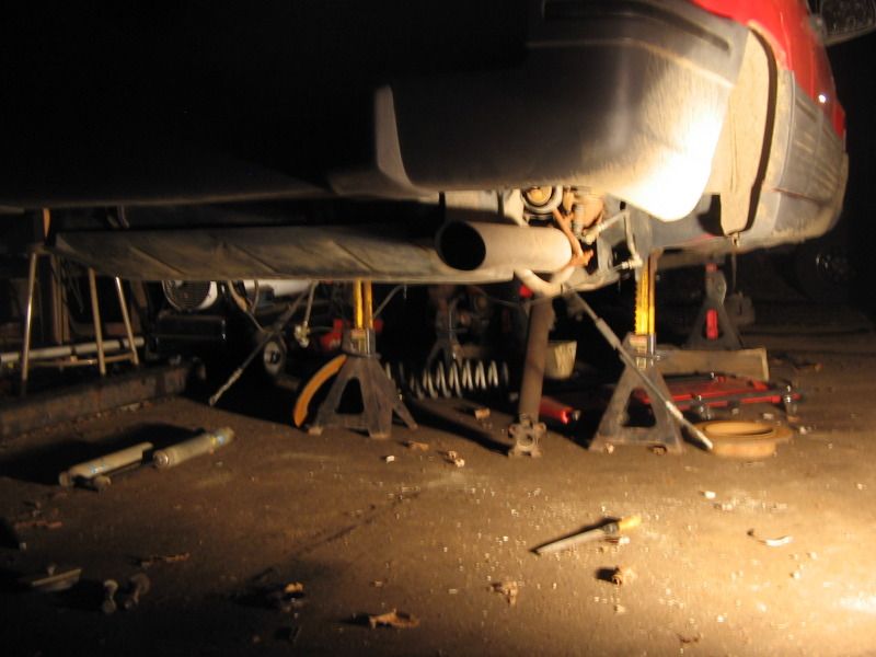

Got some stuff done tonight, starting with cleaning up the disaster in the garage after the weekend. Then I stripped the control arms off of the 8.8, which wasn't as easy as it should have been. None of the bolts were anti-seized before they were installed, so I ended up pounding them out with a 10lb sledge, or cutting them. Only one came out and is still usable, the others were trashed. I'm hoping the one that's still seized in the lower comes out with my air hammer at work, otherwise I'll have to do some delicate torch surgery. Here's a few random pictures to keep your attention.

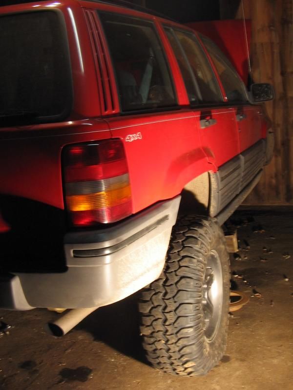

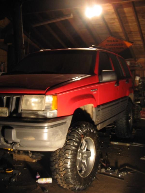

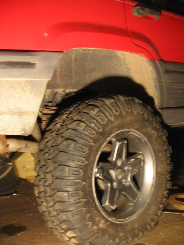

Got the rear end on it's own weight again tonight with some help from the Squash. The lowers are all set and in, one upper is in for now until I figure out the pinion angle, then I'll set them both. I really just want to see how it would look. Here's a few quick pictures, not the best because the garage is cramped but you get the idea.
