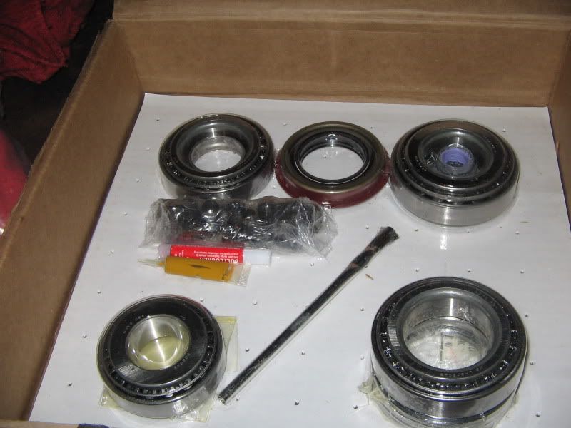

Made some progress tonight in the garage. I started by cleaning up the mess from the past few jobs so I could have some benches to work on, then I stripped the LS carrier. I'm going to bring it to work tomorrow so I can use the parts washer to give it a good cleaning, then reassemble it with the friction discs together to get a little more oomph out of it. All my stuff is here from ECGS too, so the only things left to buy are a press and a bearing splitter, and I just found out a Harbor Freight opened in the next town over. Here's some pictures just to whore it up.
Stripped carrier and all it's guts.
This is the clutch pack that sits behind the side gears in a LS carrier. The discs with the tabs on them are the friction discs, which are made up of an abrasive material that causes the resistance needed to make both side gears turn, causing both tires to turn. By putting these three together in the middle of the pack it will allow for less slippage, and more traction.
And the rebuild kit from ECGS, hopefully I only need one crush sleeve.....
