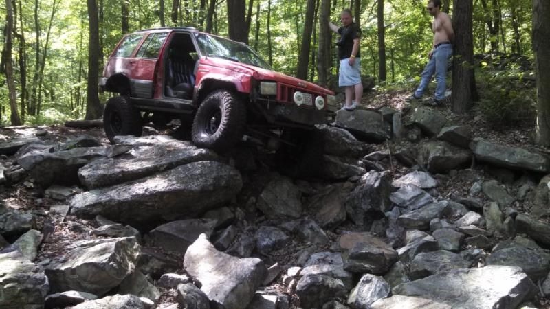

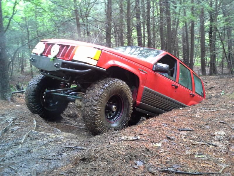

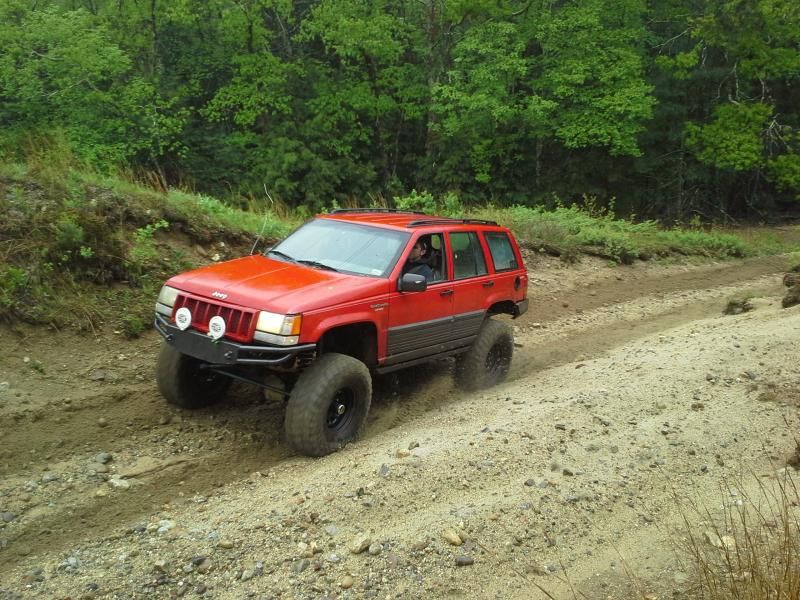

TPFB's sister rig, Squashman's 94 5speed kicking ***. It's open/open on a 2" OME kit with 31'' Duratracs and it did great all day, he only had to beat on it a couple of times.
Aaaaand here come the I told you so's. While trying this line I got a little throttle happy and the Jeep hooked to the right and slammed into the tree you can see in this picture.
Causing this.
It ripped the steel around the welds, which probably wasn't helped by the fact that I ground everything down so it looked good. I ended up hooking a strap to it and tearing it all the way off so it wouldn't get into the tire and cause more problems. I'm not 100% on what I'm going to do with it yet, I may just clean it up and slap the tubes back on, then add a brace like people had said, or I may redo the sides of the bumper out of plate instead of tube. I never really liked the way the tubes looked, but I'm lazy and I'm not sure I want to put all that work into redoing the bumper. I'll figure it out after NACfest, I'm leaving Wednesday night for Rausch Creek and I don't have time to do anything about it before then.

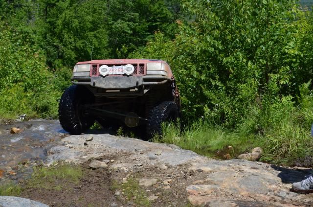

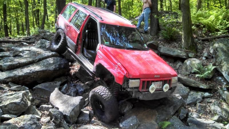

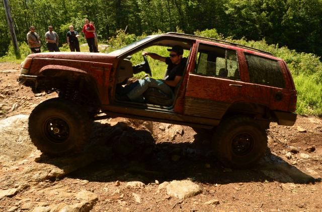

Here's a few pics from Saturday, I don't have any from Thursday yet.
Our group for the day.
A little flex.

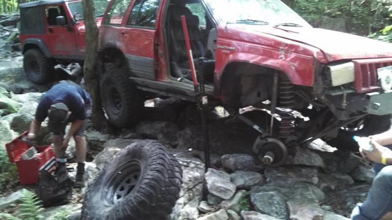

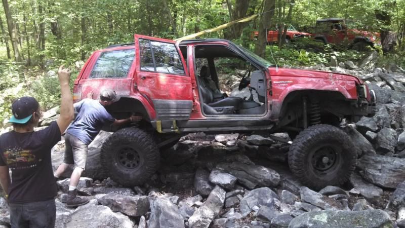

Then I broke the shaft...
Ruh-roh.

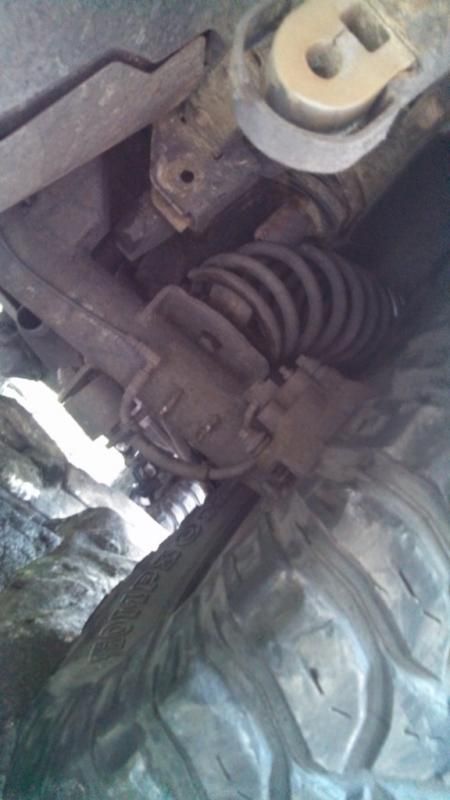

SLAMMEDDDDDD.
A quick fix with some help from a passerby with a winch.

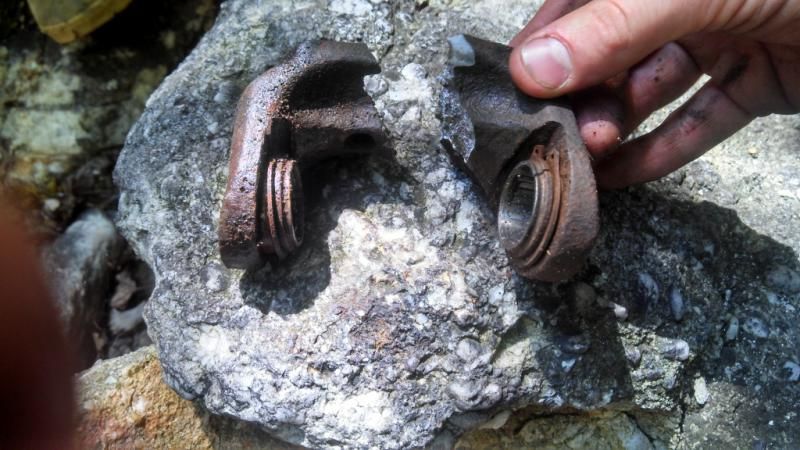

What's left of the Warn.
It turns out to warranty them I have to send both back, so I just ordered a second set as spares and to keep me wheeling while I return this set. That way when I break more in the future I won't have to worry about any down time.
