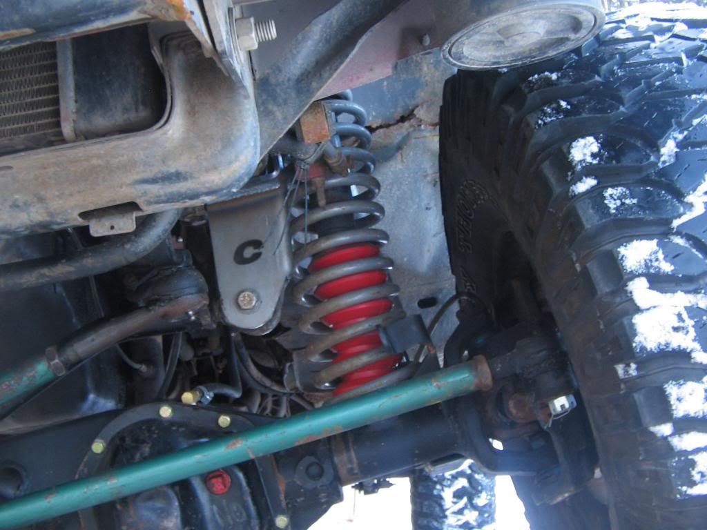

Did you make any plates or such stuff to "hold down" the prothanes like in the linked threads or are they just free floating

You don't want to hold them down at the base, it will cause them to bind up in the coils when they compress. I do run striker plates at the top, that Dave whipped up. They're made of a piece of pipe that fits snugly inside the Prothane, and is ~1.5-2" long, with a ~3" round piece of 3/16" plate welded on top. I still run some factory style rubber bumpstops up top too, which keeps the noise down.

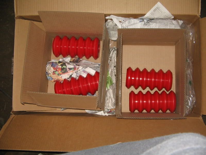

Race Jeep. I only meant to order the two for the front, but apparently 'one' on the Jegs website means one pair, not one individual insert. Oh well, now I have the two for the rear as well. At least I didn't order four, haha...
Sorry for my stupidity, but please explain prothanes to me. I know they are go-fast items, but do you have any pics of them on your ZJ?

They're a progressive bumpstop that sit inside the coil.
Dave nailed it. They're just a cheap way to get the Jeep to pretend to be a racecar. IMO, they're worth every penny, they're easy to install and make a big difference. They're a lot stiffer than I had thought they would be, but that ended up working fine as they keep my tires out of the fenders, for the most part. Here's what they look like in the coil.

Cool. Now, how do they work when I'm not playing racecar in my seXJ? I guess I mean, how much do they compress and how would I need to set them up for just regular wheeling? I've jumped my XJ a good bit, but this was with the extended factory upper stops and a hockey puck at the bottom. It works, but it isn't that soft of a landing
There's a thread on NAXJA in the Jeepspeed section about them, most people tend to run a 1-2" airgap from the upper bumpstop to the Prothane. I have just under 2" gap on mine, and in that picture they are stopping the axle's uptravel. They compress more on hard hits, but not enough to cause issues. I'm thinking of drilling some holes in the upper 2 ring gaps to soften them up and gain back that uptravel while I'm crawling.
