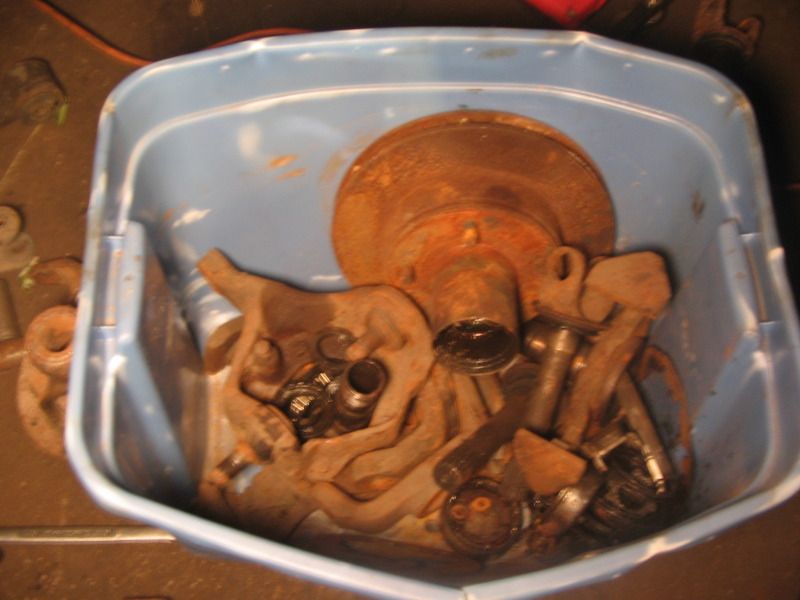

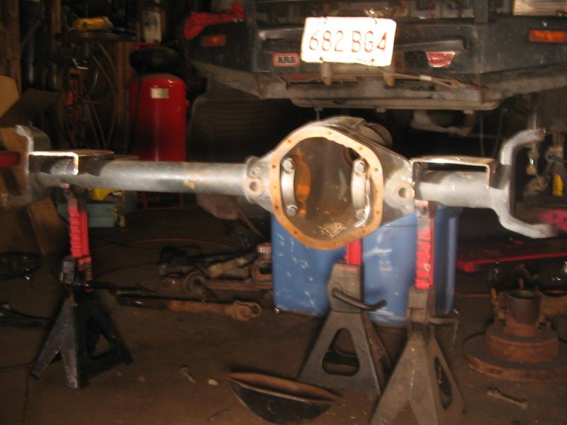

Picked up the axle and a bunch of parts yesterday. It's a '77 F150 housing, 2 3/4", 3/8" wall tubes already narrowed to Waggy width. It came with a full set of shafts plus some spare stubs, and the other guy I bought the knuckles/hubs from threw in another set of full width shafts. Looks like I'll have plenty of spares to break. Today I whipped up some spring pads after work, they aren't done yet, I'm planning to add a piece of 4" tube to center the spring, as well as a bolt in hold down strap. Hopefully I can get them finished tomorrow night, then get the axle slung under Thursday to start setting up the other brackets.
Here they are just placed on, the D/S needs a little more grinding to sit flat.
And some of the parts I picked up. Everything needs a good cleaning and some paint before it goes on.

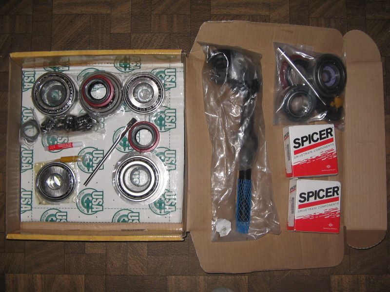

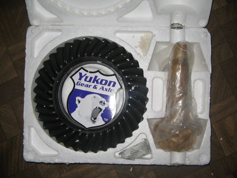

Pics of parts because I've been too busy to do any real work. I did get the driver's side LCA mount tacked on, and started prepping the passenger side framerail for the plating/mounts. Looks like packaging is going to be a *****, but I expected that. I have Monday off so I'm hoping to get the plating done and get the steering/trackbar ironed out.
760's with full circle clips, pre-reamed TRE because I'm lazy, setup kit for the D44, pinion install kit for the 8.8 and a lubelocker for the D44.
Yukons for the 8.8
I went with the USA's up front because they won't be spinning all the time and they were a good amount cheaper. The Yukons for the 8.8 were only ~$4 more, so I figured it was worth it. Both come in the 5.13 flavor
Warn premiums.

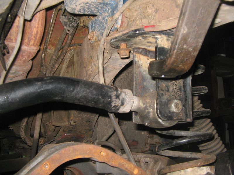

Today I cut up my old Rusty's trackbar bracket to use with my new-to-me Claytons trackbar. I was going to buy the Claytons bracket, but I'm cheap and this ended up being free. It still needs a little finish welding/grinding, but I got it mocked up and it looks like it's going to work well. It's all 1/4" plate with a big ugly gusset on the back because overkill is fun.
The trackbar obviously won't sit like that, but I'm not cutting it until I have the steering angle figured out.
Lower control arm/pinion angle. I had picked these arms up from a friend, but they ended up being too short. They work fine for mock-up, but the new ones will end up being about as long as the jam nut to jam nut distance in the picture.
