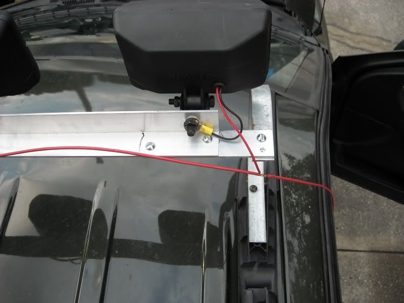

The incredibly long overdue light bar build!
And also the correct way to run wiring! I know a couple people have been waiting for this. We'll start with the physical make up of the light bar. One three foot piece of one inch by 1/16th inch steel will make up the mount to the Jeep. The section the lights attach to is up to you, flat aluminum or an L shaped bar. The flat one will obviously be better for aerodynamics, but I like the look of the L bar a bit better. You'll need this section to be four feet long and trim it down, or do what I did and use a three foot section and attach some additional material to it to extend the length.
The process: The first thing you need to do is take your 3 foot section of 1 inch steel and cut that into two 18 inch sections. Remove the front caps of the roof rack and remove the torx bolt inside. Slide one of your steel sections into this plastic and note where the hole for the torx bolt is. You're going to need to drill here. I didn't take pictures of these initial steps, but here is what we're going for:
The torx bolt is going to thread through the hole you've drilled into the steel and serve as the mounting point for the light bar, as well as the ground for the electrical connection. Take the other end of the steel bar and bend it up and back around, placing it into the plastic as well. It's going to look like this:
As you can already see, you'll drill again into the very top of the bend you have created, and this is where the top bar will attach. One decent grade screw and nut is plenty sufficient to hold this together. Now for the wiring. Your ground connection is created through the mounting points, so just ground each light to its own mounting point on the bar, like this:
The positive wire (for which I used 12 gauge, as I am running four lights), can be run down around the windshield. I think these pictures show it better than I can describe it:

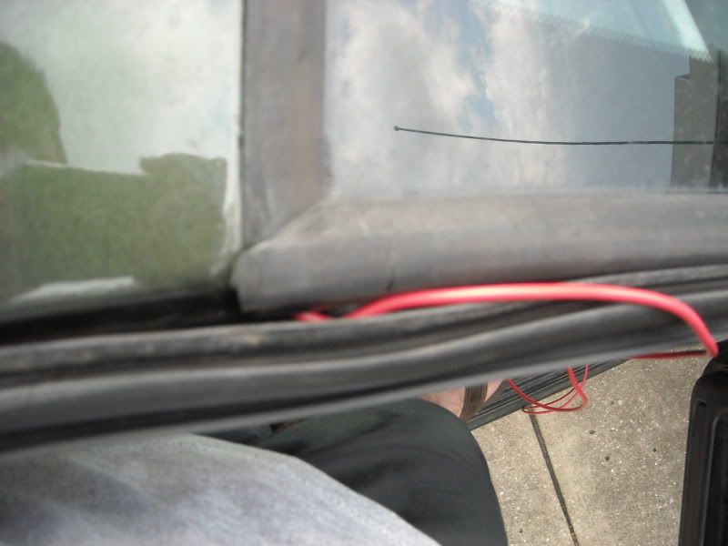

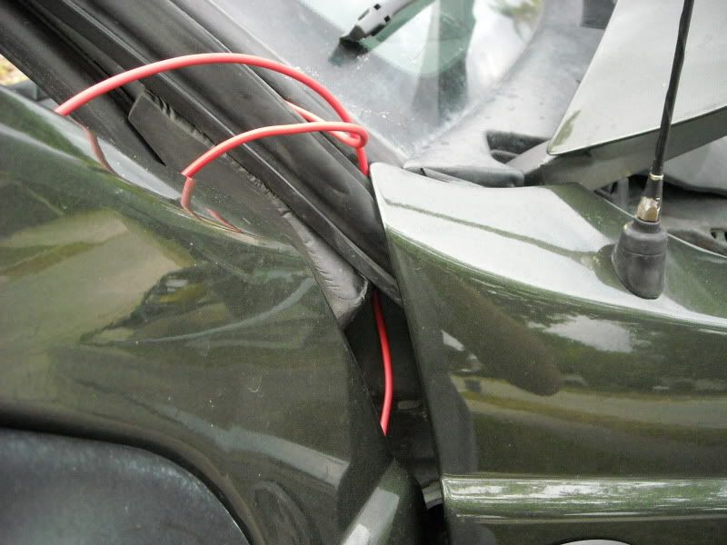

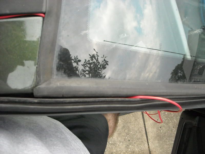

Now, when you get to the fender, you'll need to pull away the weather stripping and run your wire behind that, like so:
Do this for the outer and inner weather stripping:
Now your wire can just be run behind the glove box and drop down under the dash:
This will work if your positive power source is inside the Jeep, as mine is. I recommend running a positive power line from the battery to the interior of the Jeep, so you don't need to run switch wiring and your relay under the hood. This keeps the setup as simple as possible. I have a 4 gauge wire with an 80 amp fuse running to the interior with a distribution block, that way I only have to tap into that for a positive source. I also have a grounding distribution block for simplicity's sake. Be sure to put inline fuses on all positive wiring. I place them both before and after relays when running lights, or at any step where a short could conceivably take place.
The result is a great deal of light for extremely little cost.
