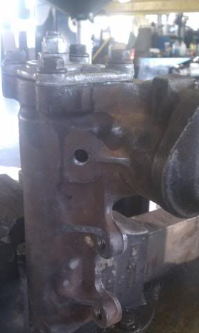

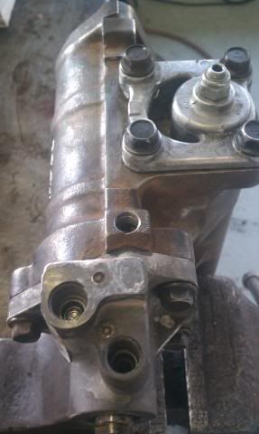

Here's the locations for tapping the WJ PS box. I got most of the info from Saturn and Shinobi's build threads and my buddy did the work.
I used 90* fittings going into the box (needed for clearance between the box and fan shroud) and straight fittings with 90* adapters at the ram side. I'll get a pic of the ram mounted once it quits raining.

sweet man! thanks for the pics. I still need to pick up a ram and get the lines, hopefully ican get everything to work out.
