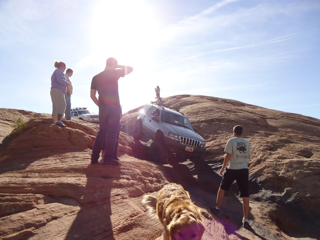

No, there is a route down. In all honestly, the route going down into hell's gate was more scary for me than actually doing it. Here is the entrance, hell's gate is on the other side of the hill to the right.
