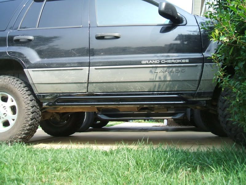

Those rocks managed to slide over my sliderz and still got into my rockers so I added an extra bar on top.
Added a Lockrite to the D30 and started snapping shafts like it was my job. After breaking at least 1 shaft everytime I put it in 4-lo I decided to upgrade. Dutchman 27 spline Chromo u-joint axles and XJ stubs with the WJ tone ring.
