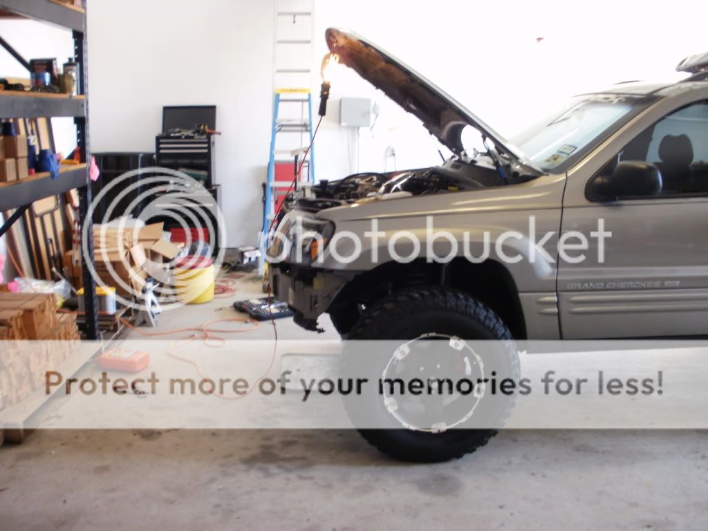

Replacing the passenger side valve cover gasket. So not fun... I have a little extra help from my GF. Then cutting up the front fenders and taking the front bumper cover off. Getting ready for my real bumper!

ugh ive been putting off doing my valve covers, let me know how it goes and if you have any tips for me to make it easier lol

Finished that valve covers. Remove heater hoses completely and take off the battery/and battery box and remove the oil fill tube. That should be enough space. Also get a good u joint for your socket wrench.

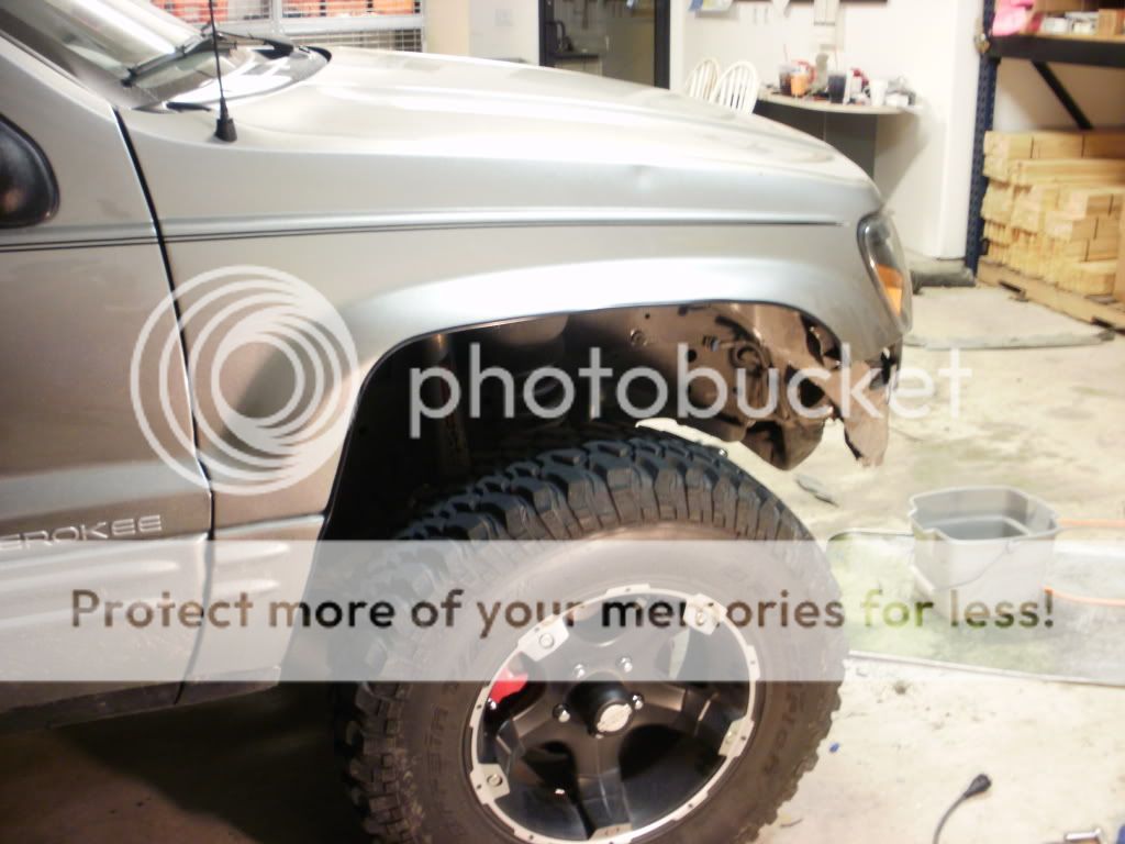

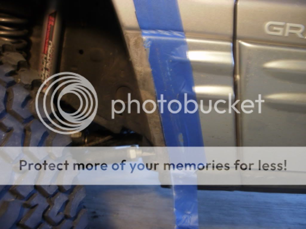

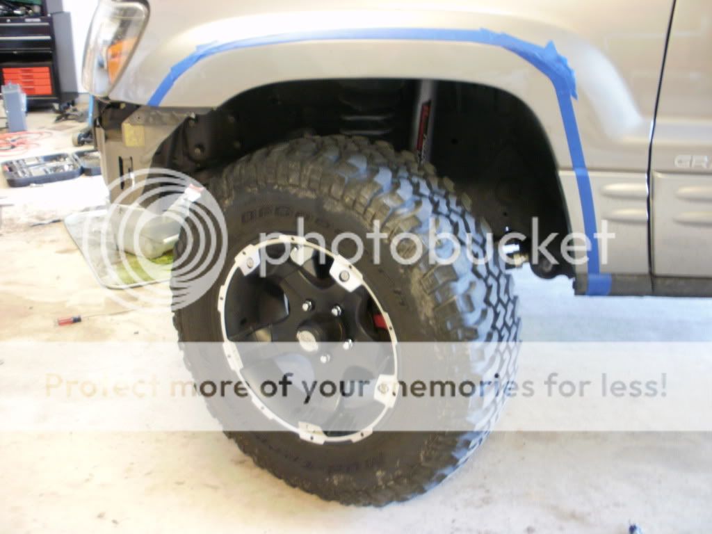

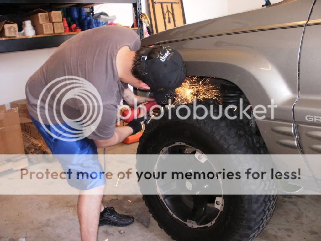

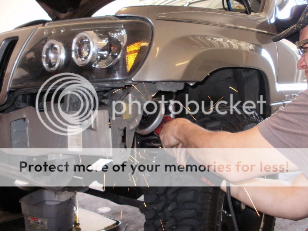

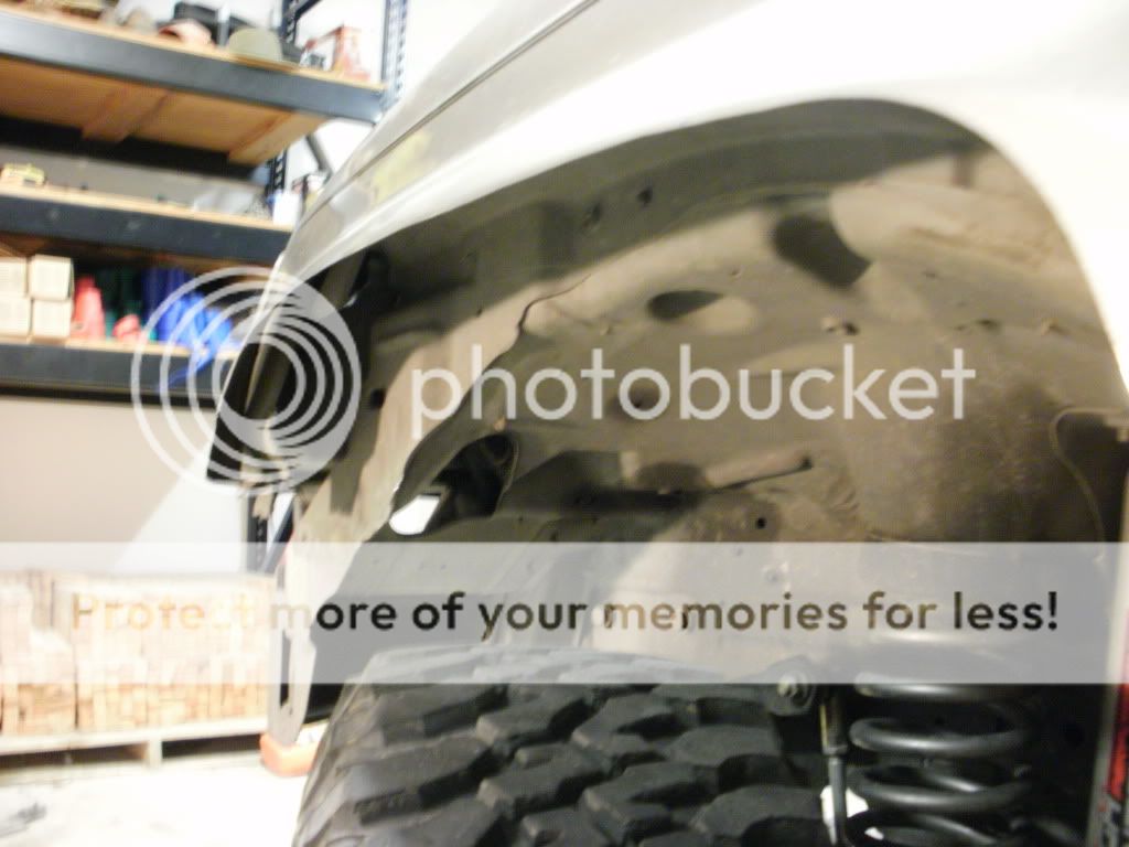

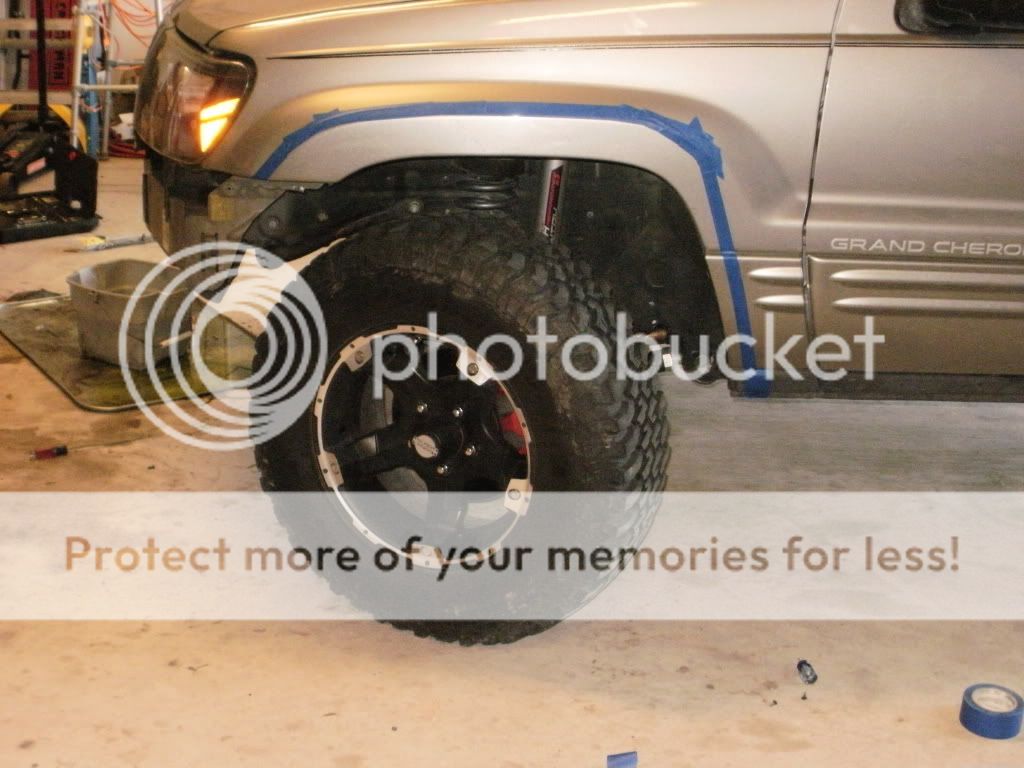

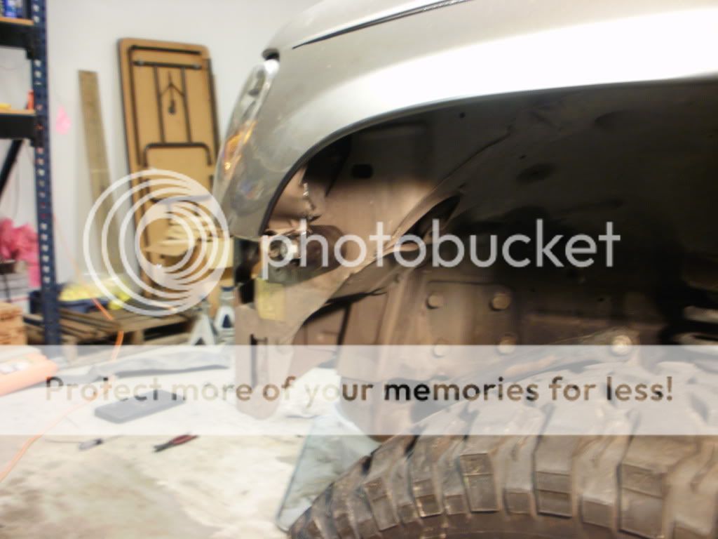

Got the privilege of cutting my fenders today! Here are some pictures. Turned out really nicely.
Turned out great! I hope I dont rub at ALL tomorrow when I go wheeling. Im leaving in the morning and will most likely have videos and pictures up late tomorrow night.

post #995 of 2220 Old 03-12-2011, 09:37 PM
1993ZJ
Location: Cincinnati OH
Posts: 290
lookin good! what did you use to finish out the fender edge?

post #996 of 2220 Old 03-12-2011, 09:38 PM Thread Starter
SplitNail
Location: Katy, TX
Posts: 4,011
A 20 grit flap disc on the grinder and then the black stuff is rubber door trim.

im confused to by what you used your transfer case drop for?????

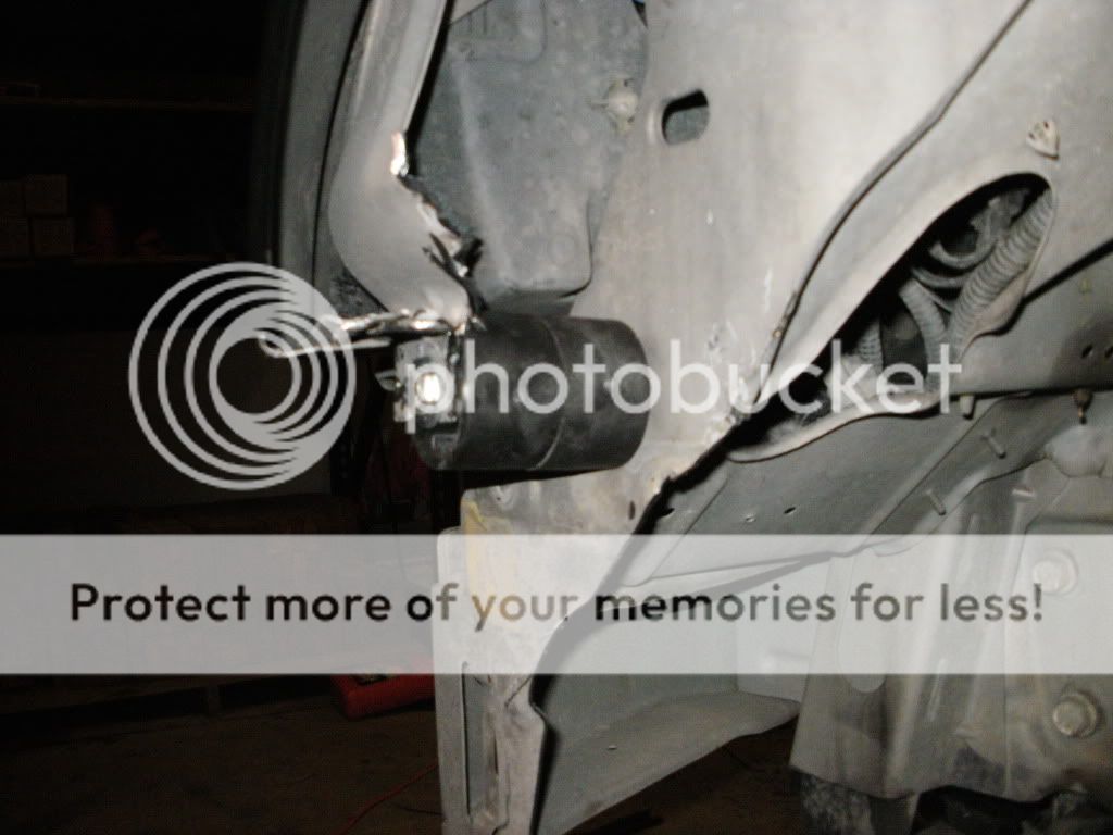

post #998 of 2220 Old 03-12-2011, 09:55 PM Thread Starter
SplitNail
Location: Katy, TX
Posts: 4,011
Hahaha. As a spacer to hold the fender. I accidentally cut the fender mount off... So I got creative and used those to hold the fender good and sturdy.
1999 WJ 4.7L V8, 242 TC, Front Aussie Locker, 4 Inch RC X-Series lift, 17x8 w/ 4.5BS Black Rock Vipers, 285/70/R17 BFG KM2's, All AMSOIL Synthetic Fluids
SplitNail is offline

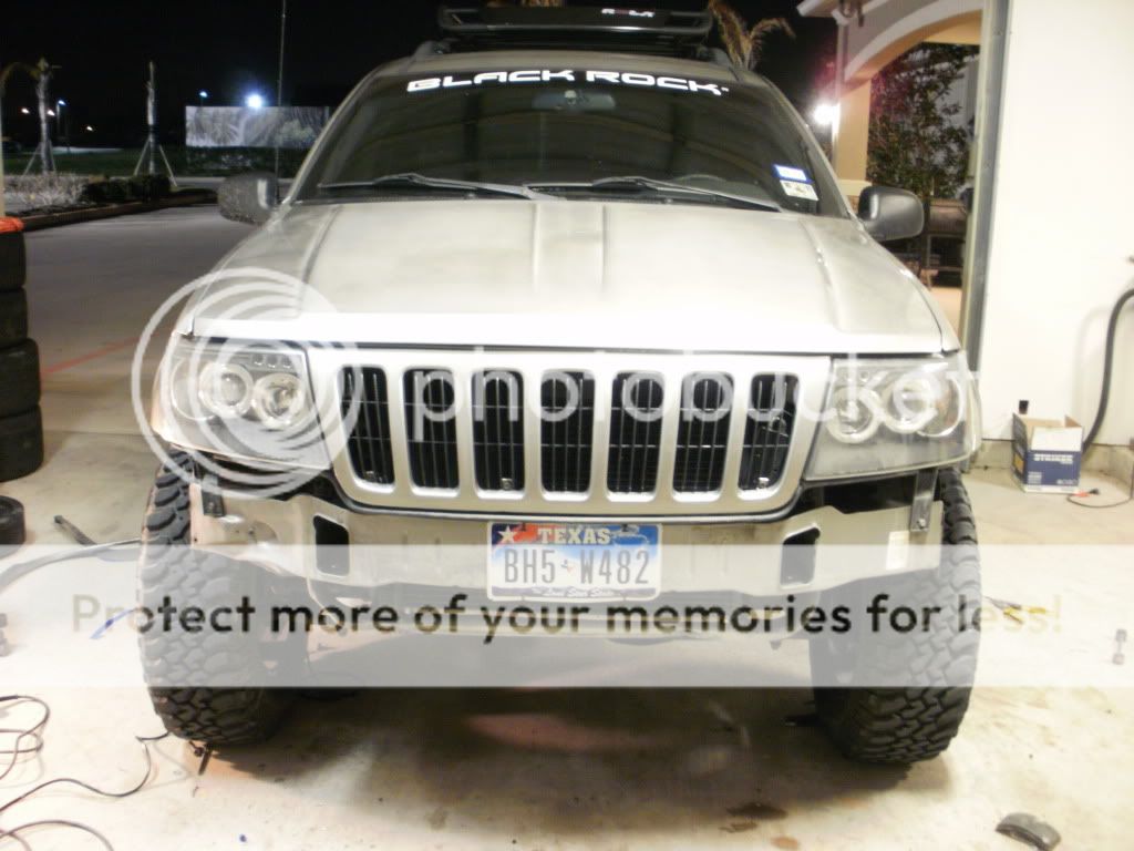

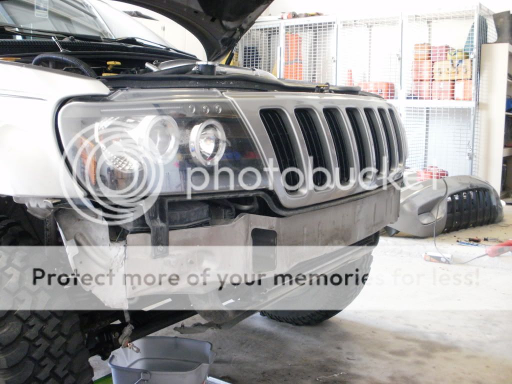

hahah smart move... how are you mounting your bumper back?

post #1001 of 2220 Old 03-12-2011, 11:39 PM
85IrocZ-28
Location: Davis County Utah
Posts: 3,934
I haven't seen a line like that before with less cut behind the tires. It looks really good, you did a great job.

post #1002 of 2220 Old 03-12-2011, 11:42 PM
RedZJ
Location: Jackson
Posts: 3,094
Damn that opened a lot of space.
I just don't like how on the front fender is goes from rounding to a straight line down.

post #1003 of 2220 Old 03-13-2011, 05:46 AM Thread Starter
SplitNail
Location: Katy, TX
Posts: 4,011
Hah thanks, and I'm not putting it back on. Getting a winch bumper in the next month or so ish.
post #1004 of 2220 Old 03-13-2011, 05:47 AM Thread Starter
SplitNail
Location: Katy, TX
Posts: 4,011
Thanks! I actually followed the same line that moony John did. I think it looks great!

post #1005 of 2220 Old 03-13-2011, 05:49 AM Thread Starter
SplitNail
Location: Katy, TX
Posts: 4,011
Sent from my JeepForum on iPod
Yes lots of space! And you kinda have too. If you start to cut more behind the tire you end up cutting off the mount that holds the fender on. It's bigger tire time!!
