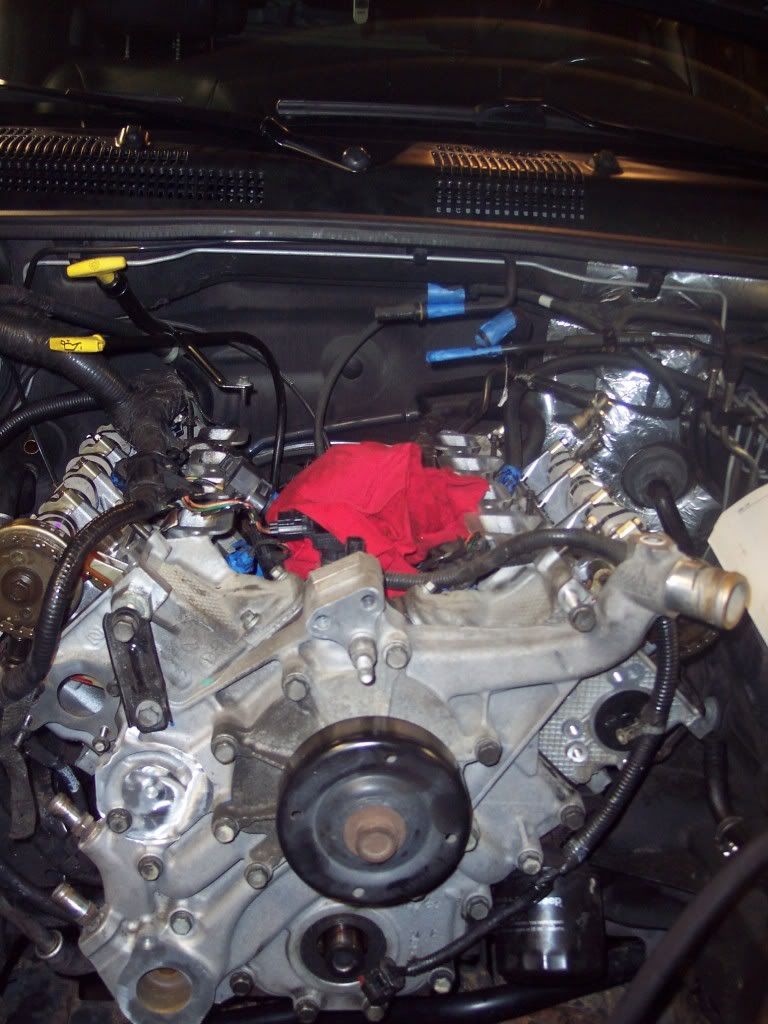

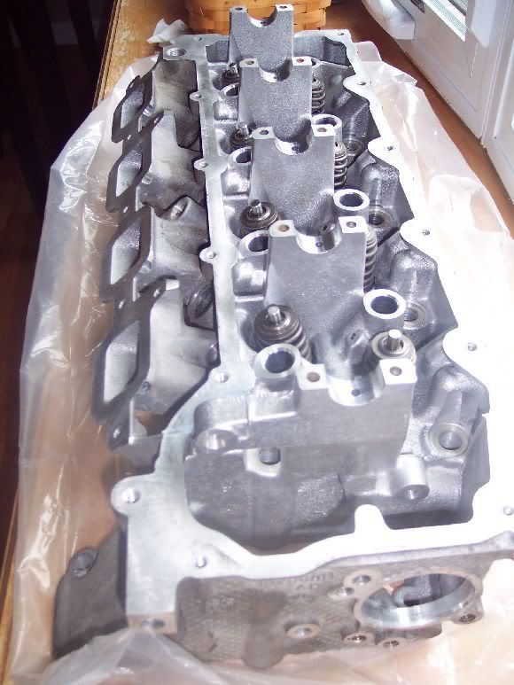

So... If my problems are in the heads what is the most cost efficient way of fixing it? Remanned heads, new heads, machine the heads? Any ideas?
time vs money ??? if you can be down for a week or so, take them to a machine shop that does car work, heads etc. have them magna flux it, and hot tank them. that will tell ya right up front if the heads are bad. if they are good, get a valve job. if you can't wait, get a set of reman, or used heads. on the used ones, i'd still get them checked for cracks. you way a head of the game by doing that and getting new seals. depends on milage, you might wanta do timing chains as well, that bit me in the aZZ and took the 2 extra months... being 1 tooth off !!!!!!
cleaned up heads
alot comes off..

Wow.. How much did you pay if you don't mind me asking?

Will the heads on an 04 HO 4.7l work on my 4.7? I can get the heads new with cams for $622.

I don't see why they wouldn't....still a 4.7 block. Seems it would be an upgrade with the HO cams and what-not.

Yea my thoughts too.. Same price too. Why not. If my heads/valves are bad I will prolly buy them new.
