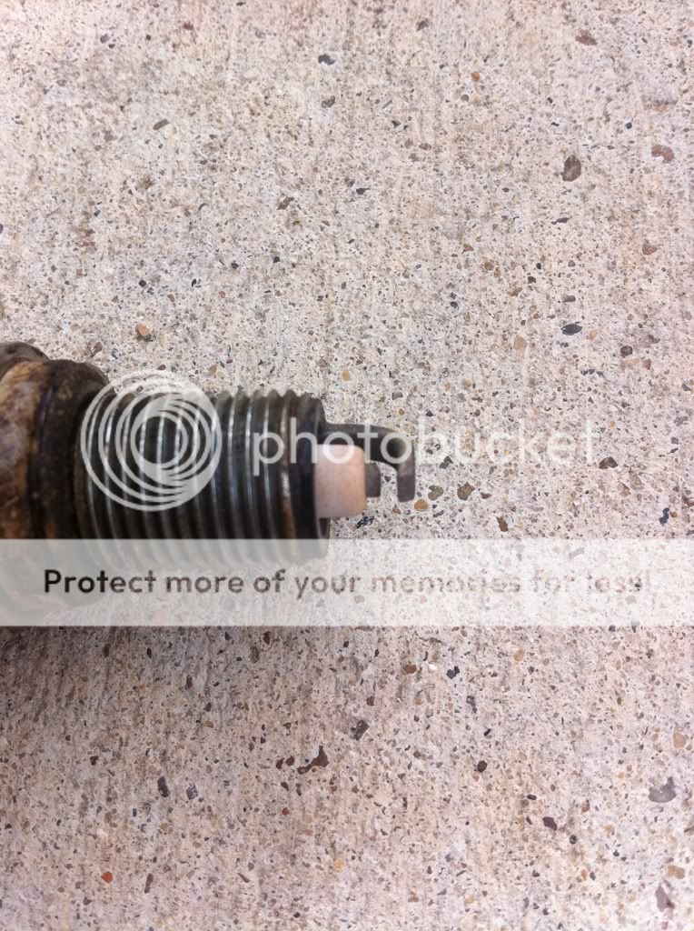

Here is the spark plug. Any comments??

that plug looks pretty decent.

Should i replace them?

4.7 should be using the platinum tip plugs is that a platinum plug, does not look like it, never hurts to replace them.
I have always heard use the champion copper cores...

No oil deposits on the plug, thats good. Looks just like normal wear. Do you know how many miles are on them?
20k. I'm gunna go ahead and replace them. Just cause. Where could the oil be going then?
That's also just on cylinder. We will see what happens.

Yep, check all the cylinders and see if there is oil on any of them, and yeah, I would replace them just cause too lol
