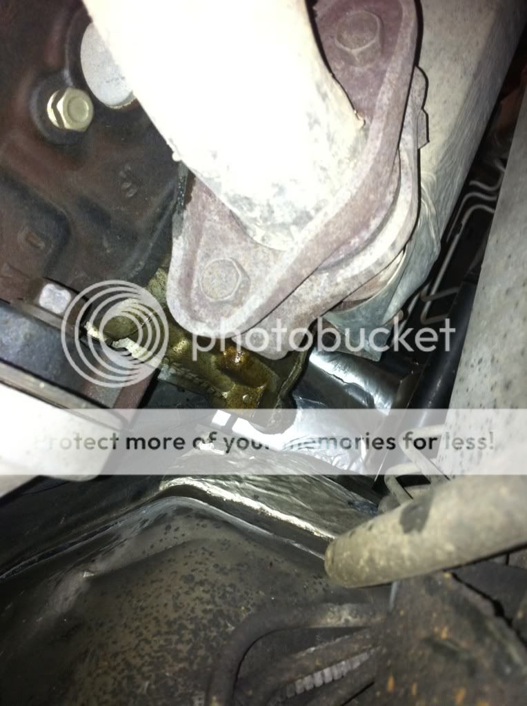

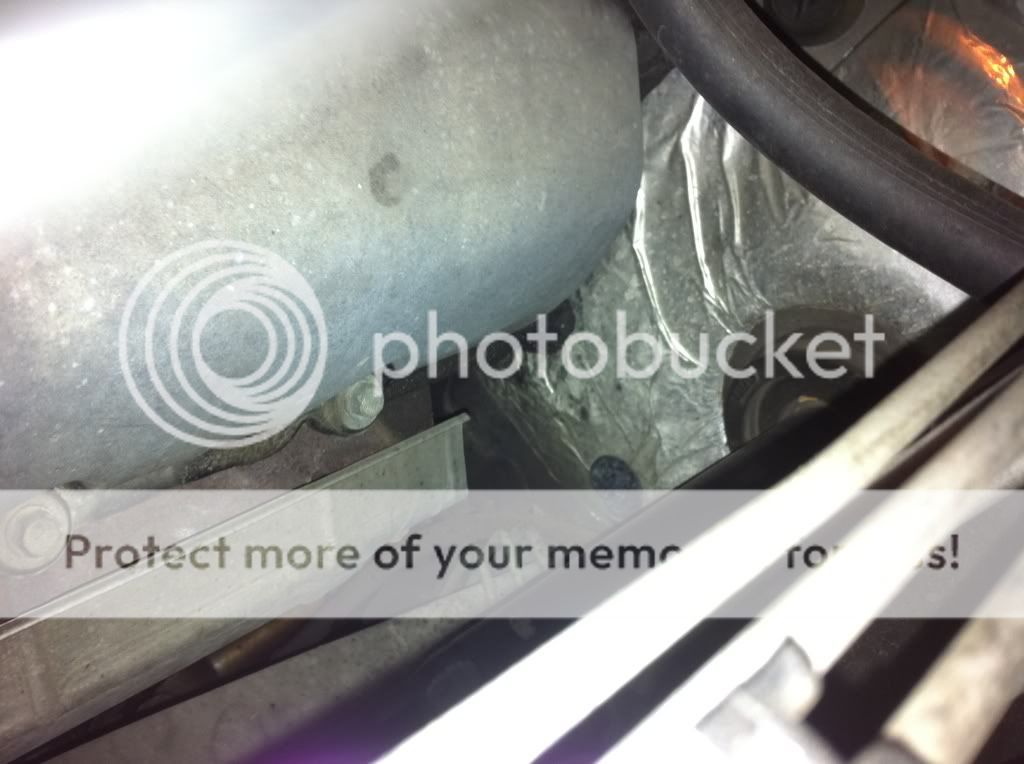

Looks like ill be replacing my valve cover gaskets pretty soon. They are leaking yet but they are wet. /: Anyone done this before on the 4.7L?

just did it when i did my head gaskets last month. the valve covers are easy to get to

if i remember correctly, dont take the alternator out, just move it, get the plugs and the basic stuff covering them off and then they wiggle out. i cant really picture my engine in my head right now since ive been UNDER it since 10am re-welding the claytons and lifting the gas tank. let me get my manual outta the jeep once i muster the courage to go outside in the cold and i'll pm you about it or you can just call me

No worries man, I'm not gunna do it for a couple of weeks. It's only wet. did you use the felpro gaskets?

yeah, but they were stretched, so i ended up going to the dealership and gettin mopar ones. cost was within a couple bucks of felpro. id suggest the mopar ones
