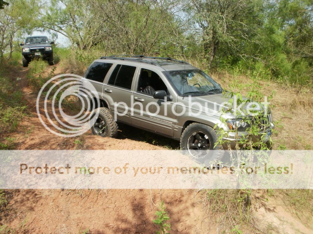

post #162 of 2220 Old 10-19-2010, 06:06 PM Thread Starter
SplitNail
Location: Katy, TX
Posts: 4,011
Originally Posted by AustinTexasXJ View Post
naw he is on like 5.5 with spacers on the front.
but I guess ill just go with 4" back spacing. I really like wide stance. my XJ was on 3" of lift with tires way out on the side. I know it isnt LCOG but o well
I think 4 is still too much. Your tire will hit the lip of your fender.

post #163 of 2220 Old 10-19-2010, 09:10 PM
myjeeplovesmud
Location: Madison
Posts: 3,240
i'm at 4.5" and think its perfect for my set up..... i'm sitting at 4.75" of lift and wouldn't go any wider... they are just a hair past flush with the body

post #164 of 2220 Old 10-19-2010, 09:57 PM Thread Starter
SplitNail
Location: Katy, TX
Posts: 4,011
Agreed, when you flex you won't be able to stuff the tire under the fender. Like this
