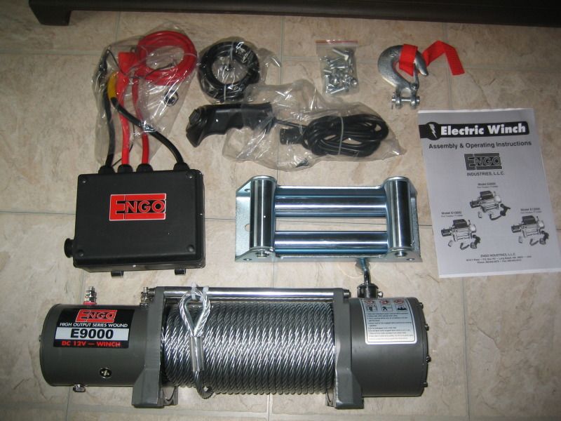

I put a new Moog drag link on to replace what was probably the original. Then this came from the FedEx guy. I hope to get it in this weekend. I took the gearboxx apart to clock it for the ARB.
Hurry up and install that winch!! Per Zach, the Engo has entered into my mind for a winch, it's between the Engo or the Recon 10.5 w/ synthetic line...

I got the Engo and the ARB to coexist mostly. The fairlead is 9/10 fullsize so it had to be modded. The verticle rollers are not far enough apart to fit under the lip of the bumper and bolt through. They are like 1/4" off per side. I can't clock the handle to fit down. It either hits the bumper or the Jeep. have to cut a hole in the top of the bumper and put it at the top. That it where it should be anyhow. The only bummer is I have to take it all apart again to do that.
I figured out a way to mount the solenoid pack and the fairlead. I will have pics when I get it done.

The winch is done exept for plugging it in to the battery.
