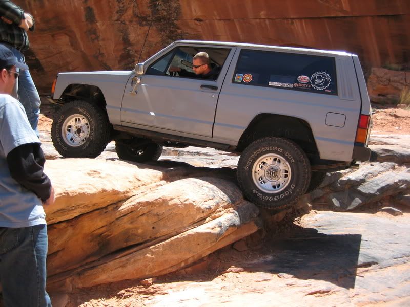

I trimmed with a jig saw after taping the area to avoid chipping the paint. I regret trimming the fenders somewhat, because now my door hinges get hammered with dirt and salt. Withought it though I would need taller bumpstops to avoid hitting the fenders. I will block them off later. If I had taller stops they would hit on big bumps on the road, requiring more lift. My goel is to keep the center of gravity very low. It worked great on my old Jeep and it made it go places that taller rigs with big tires could not go. I like showin up rigs that cost thousands more than mine. One was here:
There is a vid of a ZJ on 37's that had to go around this. The year before I climded a ledge with only a trac loc that 3 TJs, 2 had 37's, one was a rubi LJ, all went around after failing. The last guy watched me walk it in disgust.
Nice man! I had the same deal w/my old xj. 4.5 on 34s and locked. Would wheel w/guys who had 37s and they had to go around stuff or take much longer. You should ck out my thread I have on 33s w/no lift. See what you think.

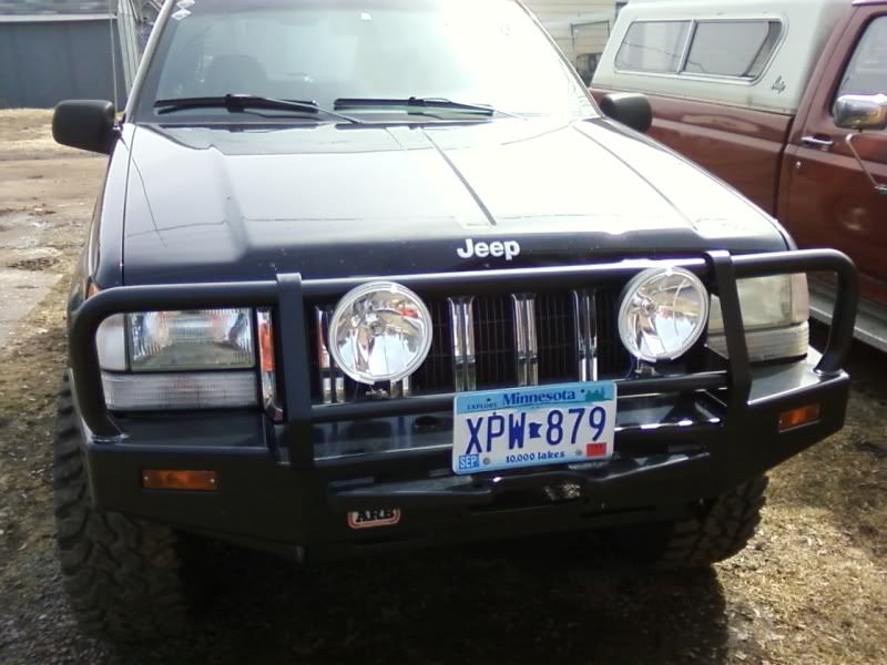

Moab is out for me. Just too dang much gas money to swing this year. I did pick up some Hella 770FFs and wired them into the factory fog wiring.
