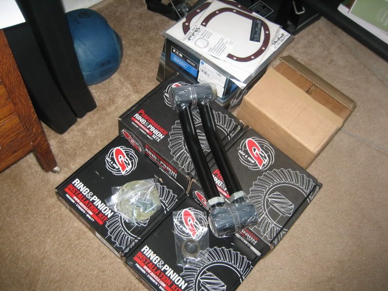

I picked up my new parts the other day. I will take me a while to get them all in, I have to go through my HP30 thast still laying in the snow, Then, once it's ready to bolt in i will go after the 8.8.
Full Detroit locker for 8.8
4.56 G2 gearsets with master install kits
IRO adjustable lower rear arms
low ratio carrier and seal to convert my disco housing
lube lockers
Thanks Iron Rock

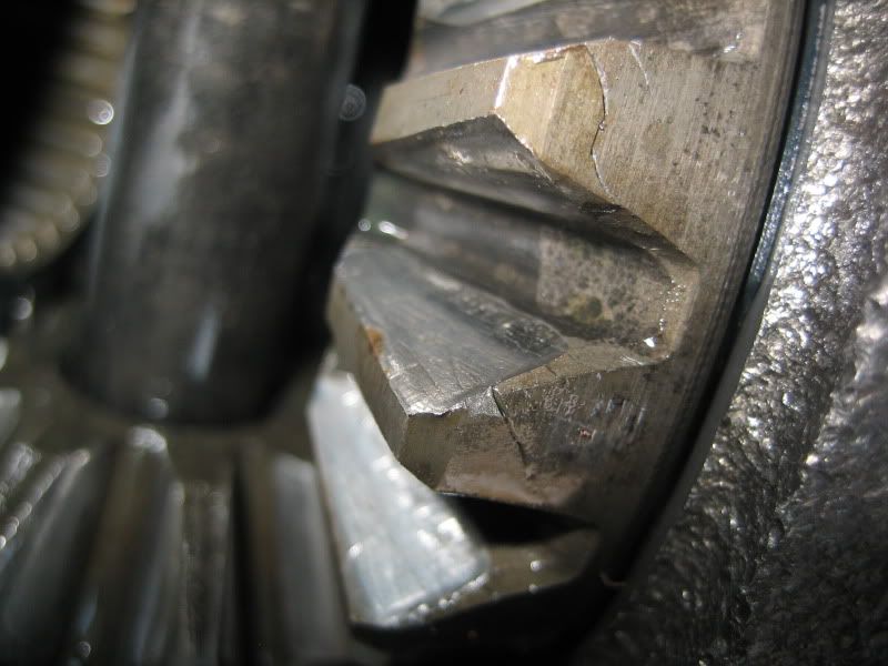

I have the 30 torn down.
I broke my 1/2" breaker bar and rachet the other day trying to get the driver side hub nut off. I wheeled that axle fro 4.5 years in my XJ with two Moab runs and never did replace that tiny 260 U-joint the whole time I had it. I finally gave up and pulled the shaft and bearing together. Today I finished the tear down and found some issues with carrier shims and spider gears. I won't be needing either one with the Aussie and new carrier going in.
Tonight I have to read up and start planning assembly. This is my first try at setting up gears but I have help close by if I screw it up. Randy's Ring and Pinion has lots of helpfull tips on his site. I also borrowed a good manual and set-up bearings so with paitience I should be set.

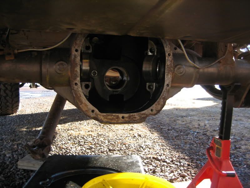

The other day I got the front gears set. I have to pull it all apart one more time and put the new bearings in. Yesterday I tore the 8.8 all the way down. I took the old pinion bearing races out and ground the outside of them down to use as set-up bearings for the new gears. I also warmed up the 4.56 ring gear and mounted it on the Detroit. Today I hope to get bearings pressed off the old carier and pinion so I can gring them down on the inside to also use for set-up. Then it's on to reassemble the rear. The front is waiting on funds for all new Moog ball joints.

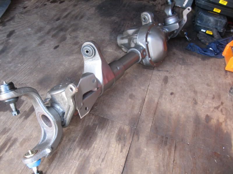

I finally scraped together a little more cash for the project. First I cleaned it up a bit. It wasn't bad being from a CO. XJ with 200k. I put in all new Napa premium ball joints, new seals to convert the disco housing, and new upper control arm mount bushings. Now I just have to get the pinion bearing pressed on and rip the LP 30 apart for the locker, shafts, and knuckles.

post #45 of 137 Old 04-12-2010, 09:54 AM
PaLftr
Location: Central PA
Posts: 876
Front axle looks awesome
