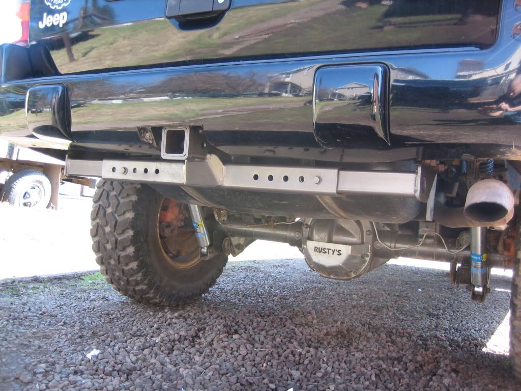

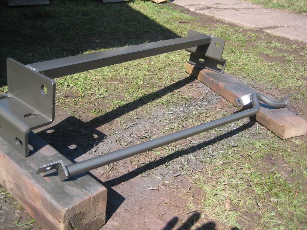

Today I tackled the low hanging adjustable width hitch. I took it apart, flipped the center and cut the bumper up 2". Then I painted it up to match the 8.8.
Just as I finished the Fed-Ex guy delivered my KOR radiator support and steering brace so I wiped them down and primed and painted to match. They are going on tomorrow.

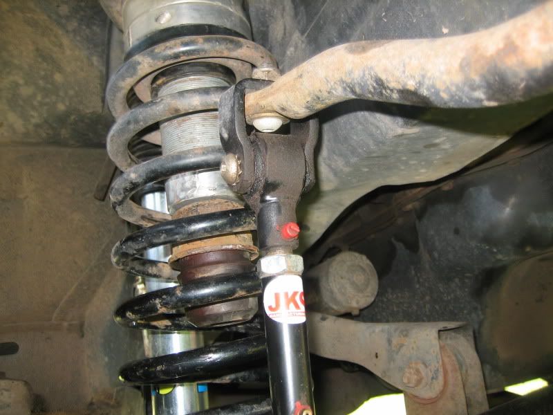

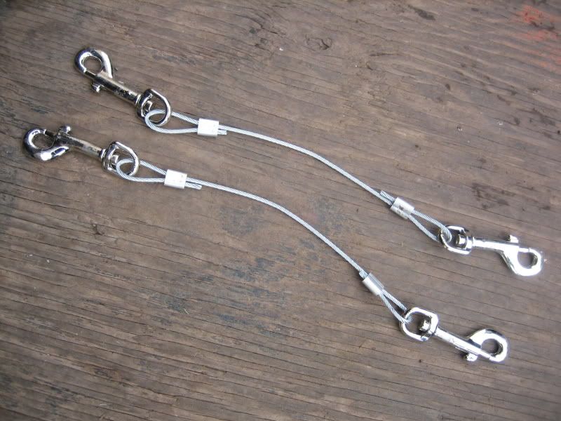

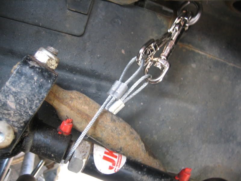

Today I made up some swaybar disco retainers. I put small eye bolts in factory holes above the swaybar. One is holding the battery tray in, the other is under the air box if you still have one. It cost me about $13 for hardware.

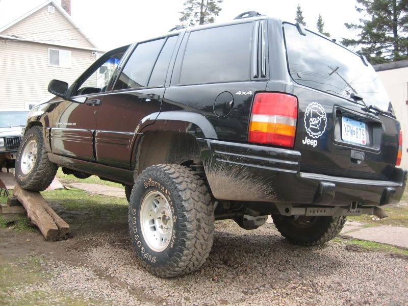

Here is a cheep driveway poser shot since I didn't have time to go rock hunting.

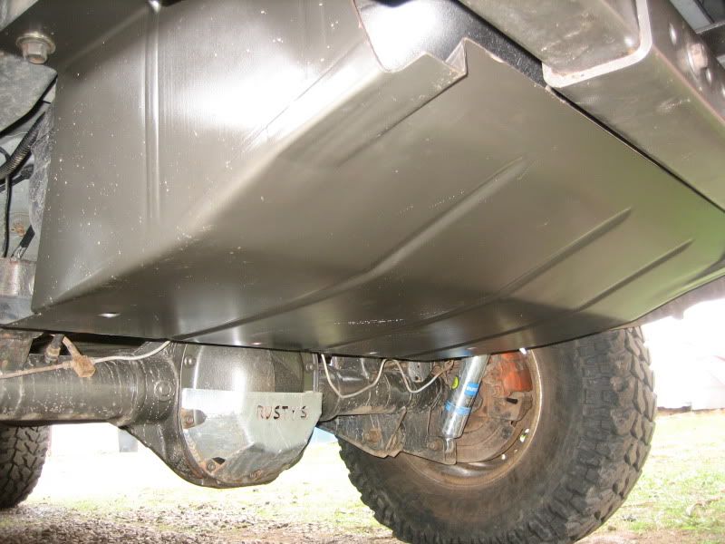

Here is a shot of the junyard skid I scored locally. I have to get the tranfer case skid mounted yet. I also picked up some used ACOS's on trade I hope to have in soon to perk the front end up.

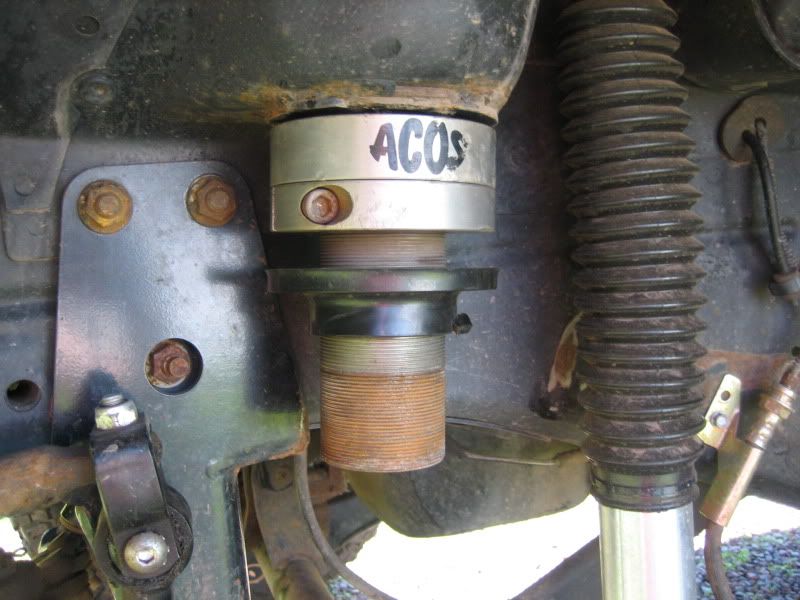

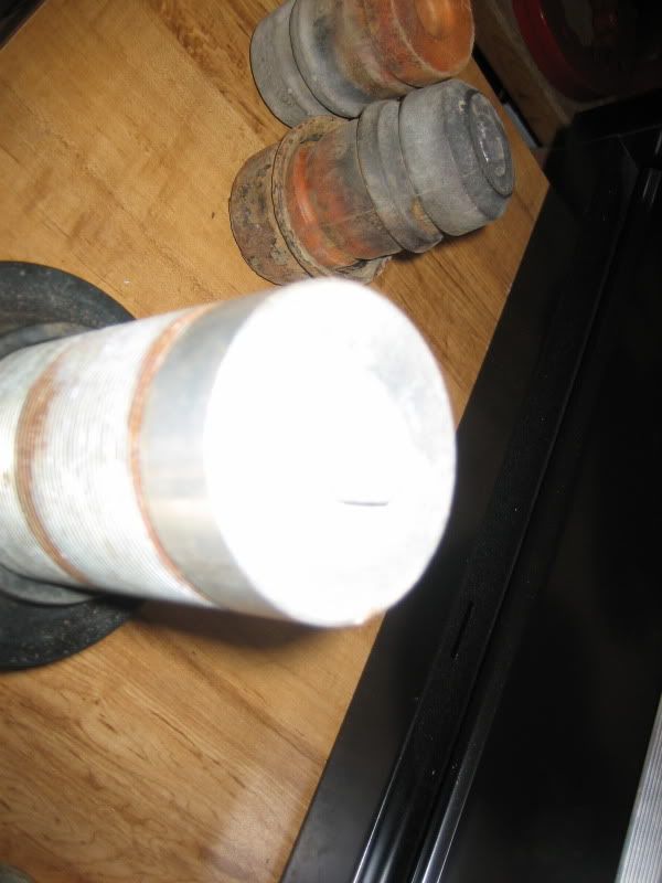

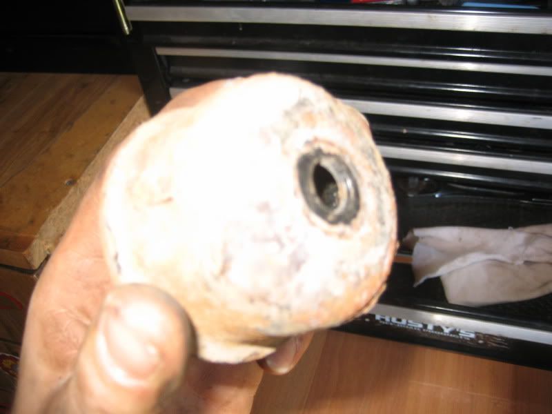

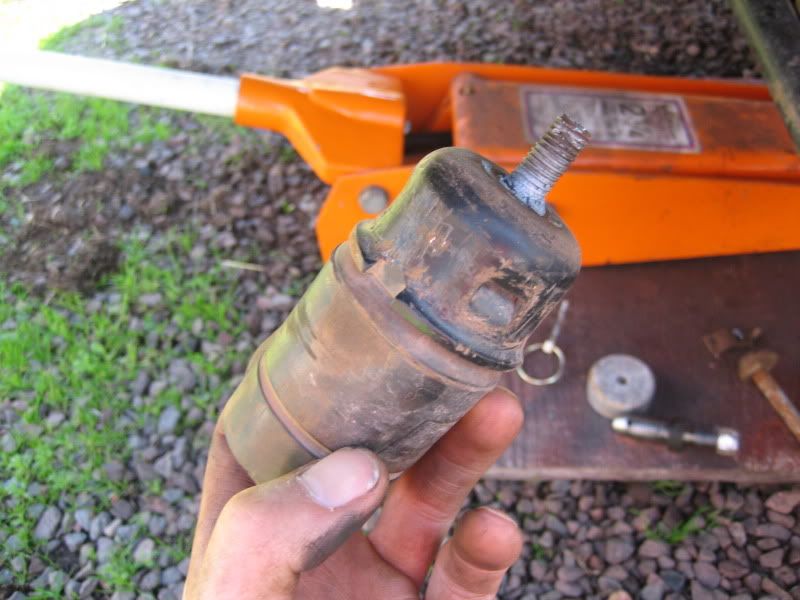

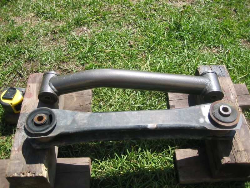

After helping my cousin on his rig I aquired his old RC lower control arms. I was waiting on these to finish up the front suspension. Now that I had the parts I tore into it yesterday. I had a pair of ACOS's from Randy waiting to go in too.
The ACOS's were missing the bumpstops though. Because they slip over the factory post I had to figure out how to make a bumpstop work. The Idea I had in my head worked out great.
The ACOS has a 1" thick aluminum spacer that mounts in the stock bumpstop location with a single bolt. The ZJ has bolt on bump stops like my old XJ.
The only issue I had was that the aftermarket bump stops I was using had the bolt welded to the insde of the cap.
Because of the spacer that must be used to mount the ACOS the bolts were too short. Luckily I saved the stock ZJ bump stops. They had the bolt seperate from the cup like this.
I used the bolt from the ACOS and the factory ZJ stops. Then I added a puck to the bottom and ended up with this.
I gave the RC control arms a shot of hammertone to clean them up and bolted them on. They are about 1/2" longer than stock. I didn't realy need the length because the ZJ uses cam bolts at the axle end of the arms. I will be going high pinion eventually though and these will be gone. The main reason is more suspension droop=more flex.
So now with the ACOS as low as they go it sits 1/2" higher in the front than before. If I need another inch or two of lift, or add a heavy bumper all I have to do is crank them up. It also freed up my 1" spacers so if needed I can use them in the back.

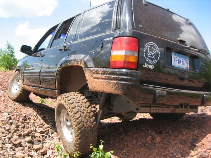

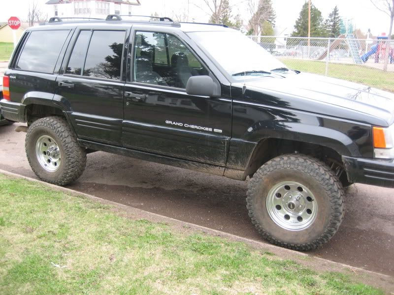

I took it on it's first real wheeling trip. It worked flawlessly. Some of the trails were realy tight and I made it through unscathed.

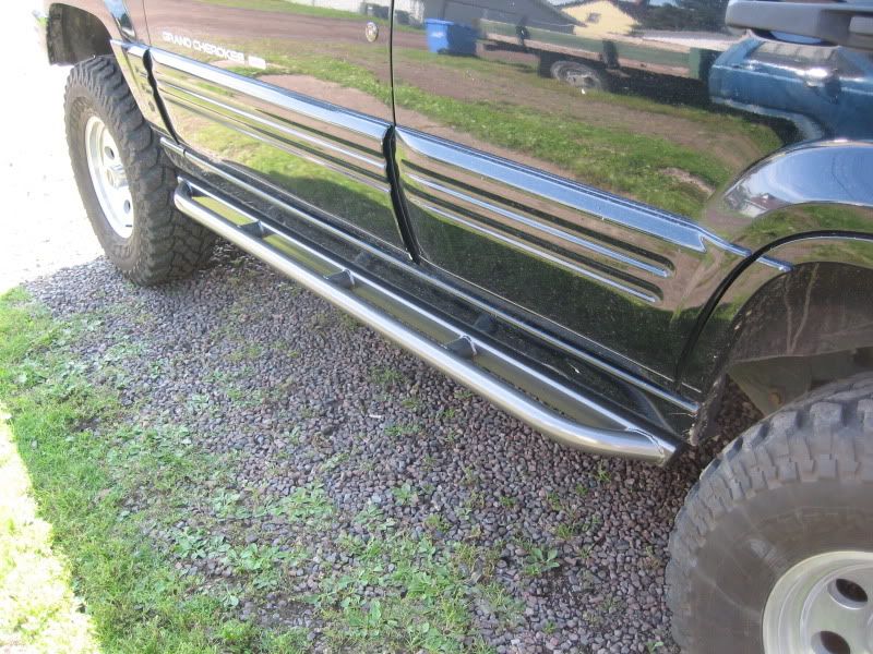

I put a set of AJ's superrails on today. I like.

post #26 of 137 Old 08-30-2009, 02:44 PM
ZJ_Richie
Location: Saylorsburg, PA
Posts: 407
Lookin' good
How much did those set you back?

$320 out of Iowa. For me it was the way to go. I had them in about a week.
