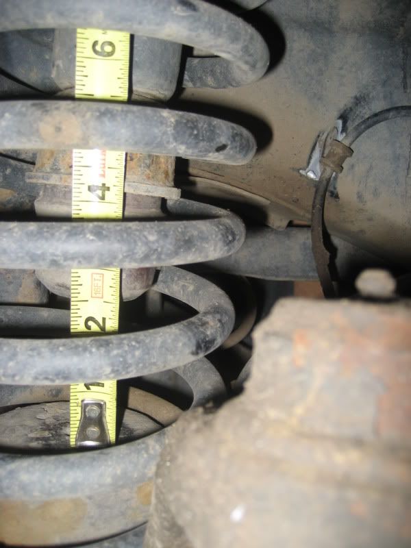

2.5" from the axcle housing to the bump stops.

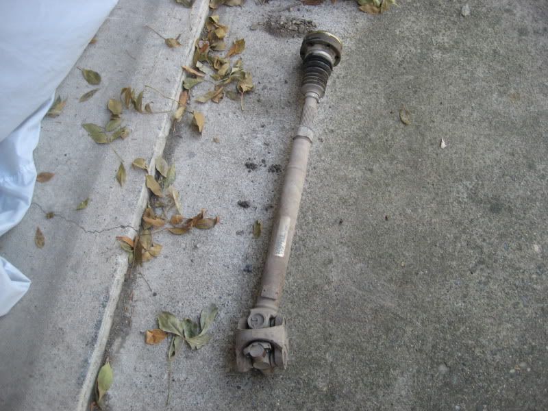

Old cross member and the new.
Old front driveshaft.
Transfer case is supported, ready to install the new cross member.
