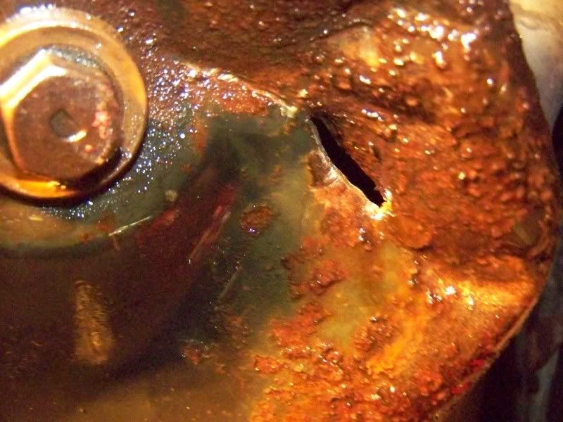

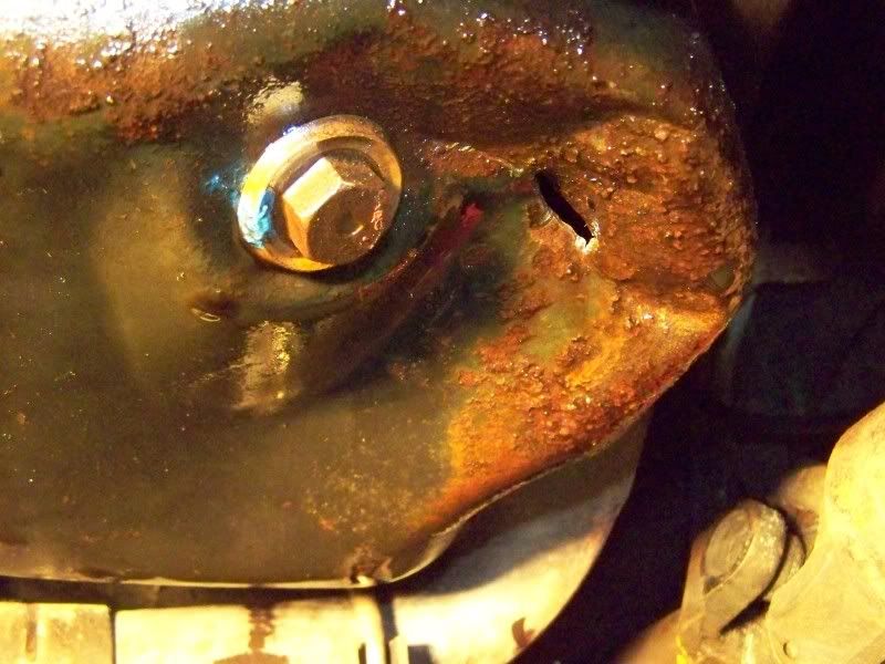

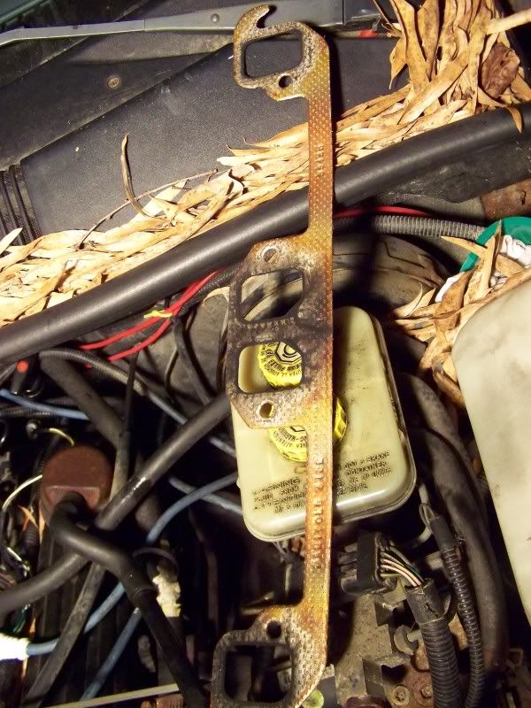

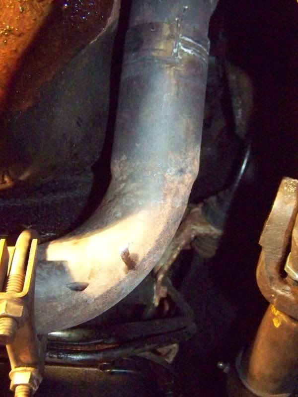

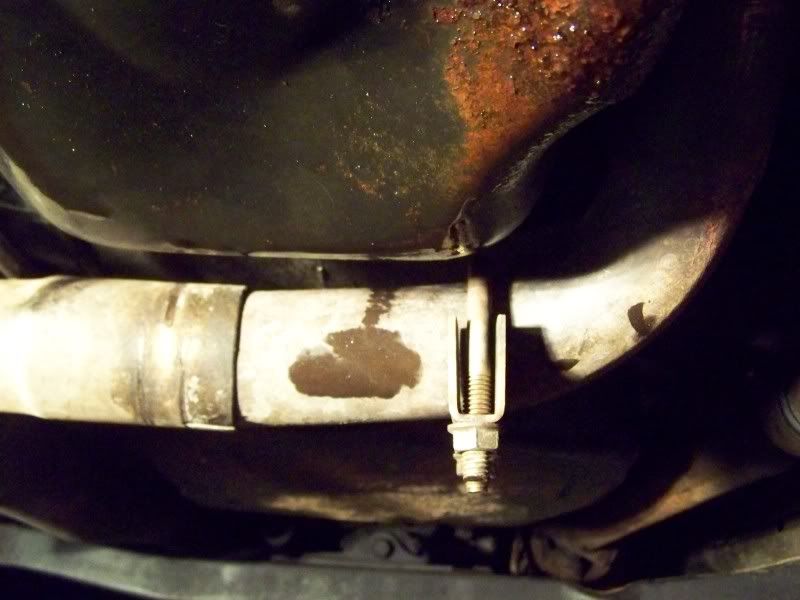

I got started on the ol oil pan. It's quite the PITA with the header and down pipe doing what it is.
Pics of said crushed oil pan:
Downpipe that's all up in my way:

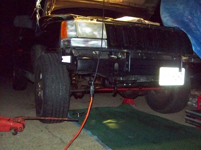

My wonderful workspace in this beautiful 30 degree weather:

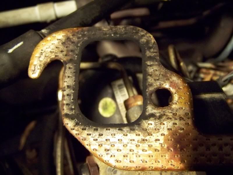

My driver side header:
You can kind of see, it says Borla on the tag.
Header gasket was installed the wrong way. It doesn't look bad, but I may replace it with a new to be safe.
The worst side:
That's all for the oil pan, I got stuck on getting that header off. It just doesn't want to come off all the way. It will only slide out about an inch, then stop.

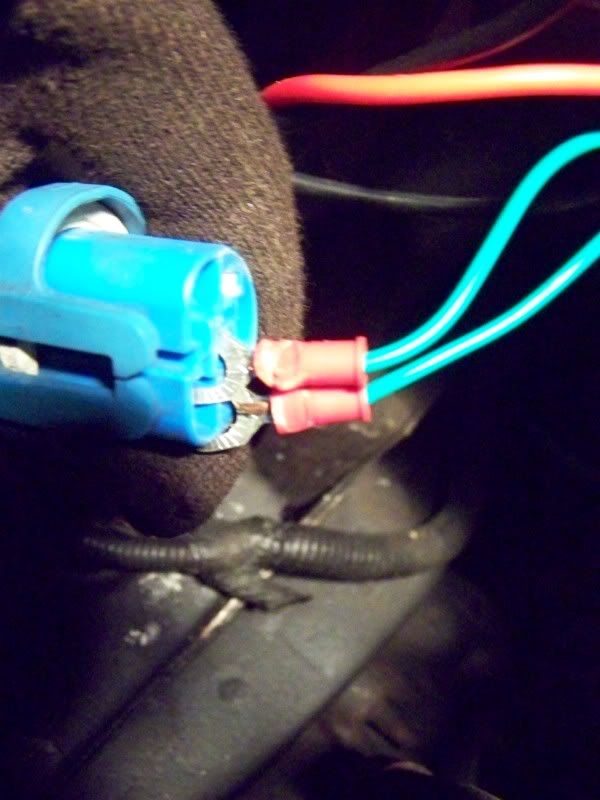

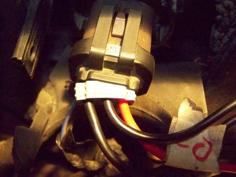

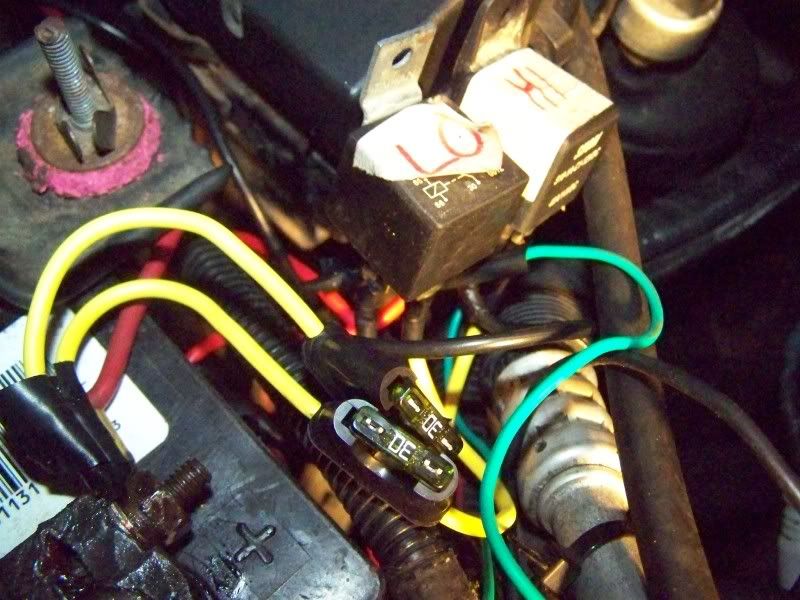

Here are some pics of my headlight harness upgrade.
These are the high and low relays as well as the power wires that run to said relays.
My 12g wire soldered directly into the little plugs in the bulb harness.
The wires that run to the high and low on the stock harness to the relays. Right now they're just little connectors slid into the harness, but eventually If like to pull apart a bulb and solder those wires to it. Still keeping the ability to use stock bulbs should I desire, but I'd feel alot better if they were hard wired.
That's it for today, hopefully after work I can get some more done since my jack decided to stop working tonight.
