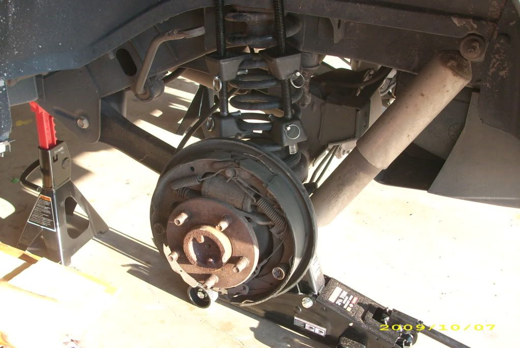

When you get the compressors, pull out the pucks, set the spring back in and jack up that side to compress the spring and put the compressors on it. Then all you have to do is lower the axle 3" and you can put the puck and spring in no prob. I did it this way by myself and it only took me about 2 hours start to finish.
yea thats what im planning on doing. dont wanna **** with the coil and have to compress it.

They should have them. I bought a set of cheap spring compressors at harbor freight for like 10 or 12 bucks knowing I was only using them to hold the spring not compress it.

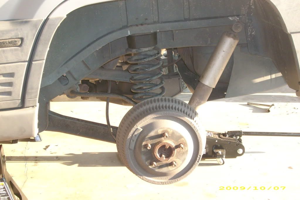

got it done today. Pics of the back will be following later, they are on my sisters camera cause mine had died.
could be weeks. =p.
but heres the work in the front and sitting on its own weight.
finished front on its own weight.
and then completely done.
sorry they are so blury, it was on night mode so it flashs like 5 times before it takes a picture and i cant hodl still that long.

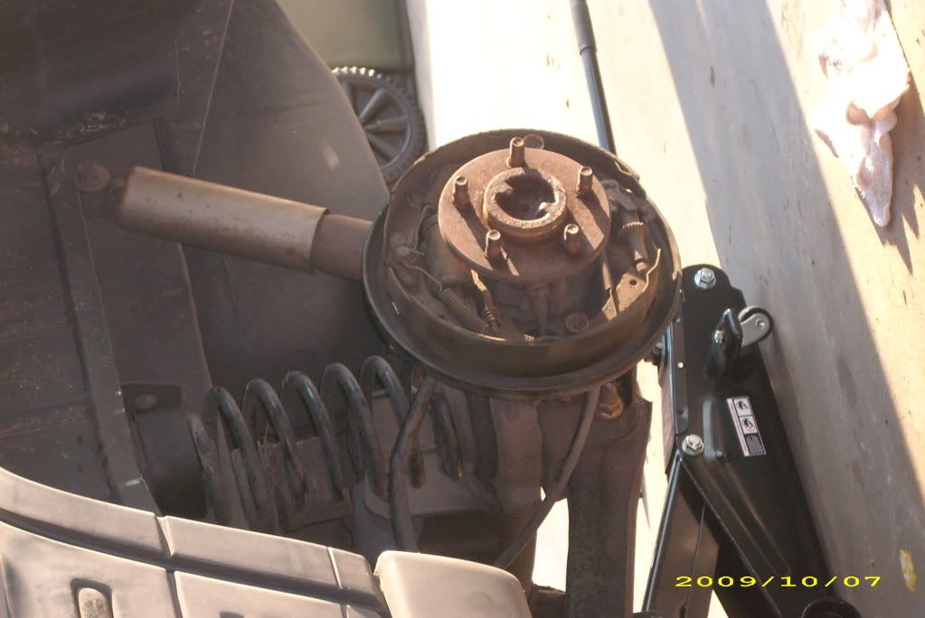

finally got the pictures of the back. didnt realize she only took a couple...
RMFK13 is offline

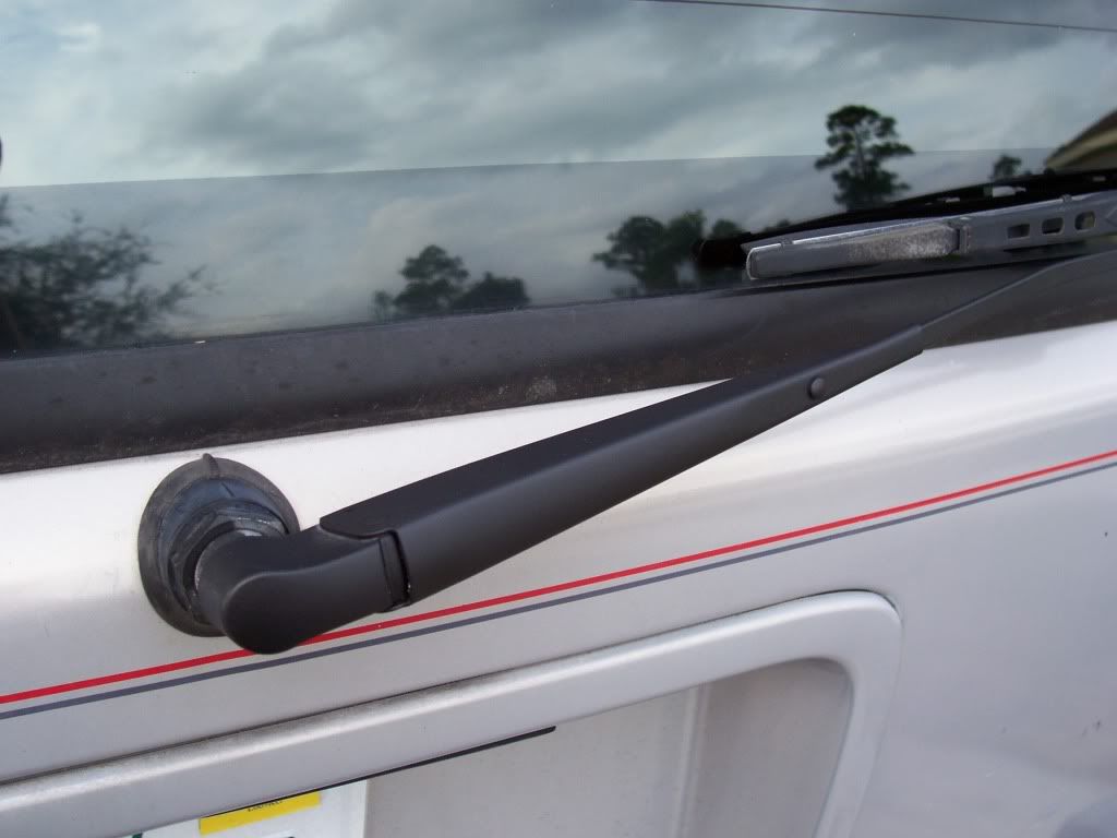

painted my grill and front and back wiper arms. only got pic of back arms, they were rusting and peeling and all. so i painted em.
