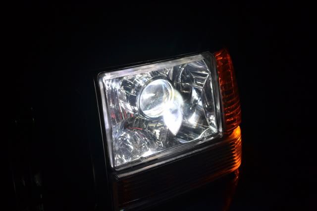

I finally redid my retrofit headlights with ddm tunings v3 hi/low projectors with 55watt his kits. I absolutely love them they are way better than my Porsche Cayman retrofit I've had for years. The install was easy as pie. I baked the lights at 225 for like 15-20 mins to melt the glue pulled the lenses off, popped the reflector off then your ready to install them. They just thread thu the the existing hole for the bulb and sandwich with a bracket it comes with that lines it up perfectly. Anyways here's pics of the install. here is a link to the projectors http://www.ddmtuning.com/Products/Projectors-H1-V3-Pair

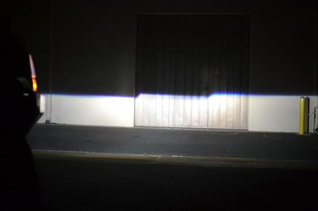

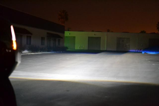

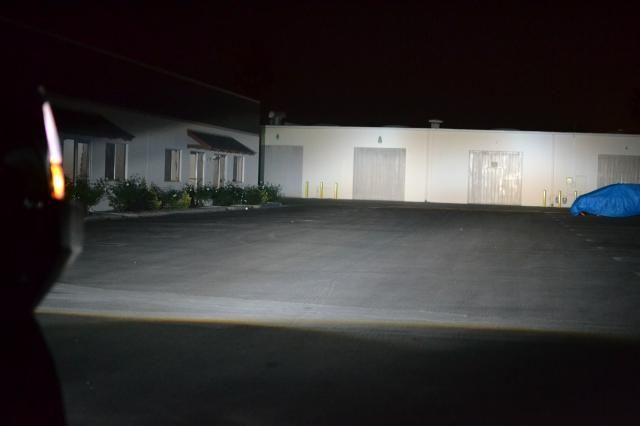

heres some night shots that my buddy took tonight
low beams
high beams
cut off
and a pic of them all done and lit up

Yep they are really bright but the cutoff is great so not blinding oncoming drivers
