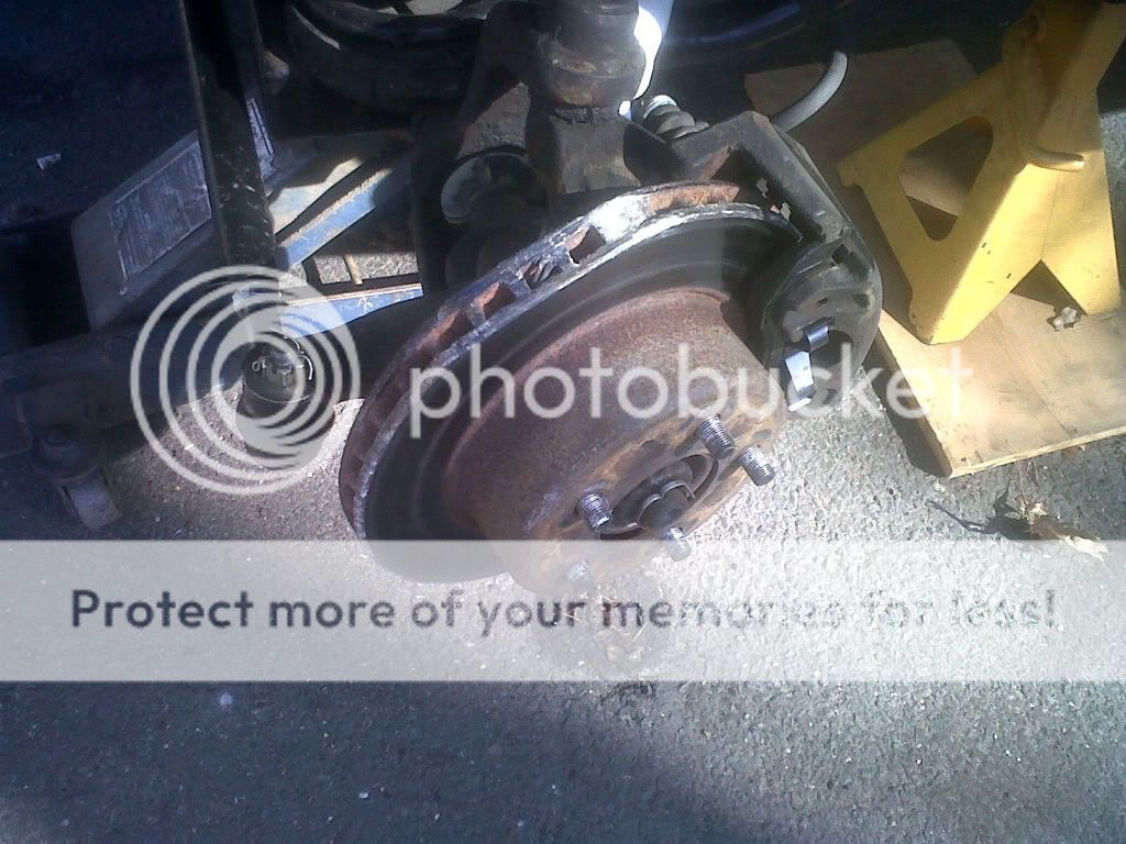

Went for a test drive today with the new HP Dana 30 I got..
Front Driver side caliper was seized... and pass. side u joints were also seized.. Thats ok.. Wasnt too pissed, had the spare parts..
Went to put both calipers back on, to find out the GOD DAMN knuckles were stripped out. (would have been great info if the son of a... told me.)
So we rigged something together, then found out the bearings are shot. REALLY. MORE!!!..
So I drove it home... AND THE DRIVER SIDE WHEEL FALLS OFF AT 50 MPH.
AGH. So mad.
RedZJ is offline

Im fine.. Looks like I lucked out. Wont know till tomorrow when I check it out.
From what I did see, looks like it will need a new rotor and.. yea thats all I could see that was messed up.
Still dont know what caused it. This axle is ****ing hell.

did the lugs shear? or did the hub separate?

They look shear'd.. but I dont know.

That's crazy. So they broke? Hard to see in the pictures.
