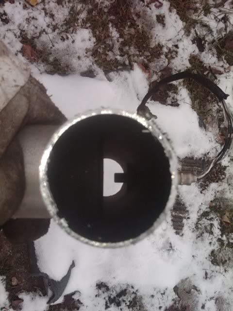

somewhere in this picture is a joke. anyone care to guess the punchline?
Is that your "high flow" custom Y?

Unread 12-08-2009, 06:56 AM   #134
blackjack12982
1994 ZJ
Location: Wichita, Kansas
Posts: 1,886
I'm just saying, if that's your "high flowing" Y-pipe, you need to kill that the guy that came up with the design. It looked bad installed, but that's atrocious!

Unread 12-08-2009, 10:02 AM   #135
ratmonkey
R.I.P.
ratmonkey's Avatar
Join Date: Dec 2006
Location: , Pennsylvania
Posts: 19,794
i'm heading over there to stomp a mudhole.
i'm almost done with building it myself, all i need is another couple j-bends to fab up the s bend i need for the driver's side downtube.
