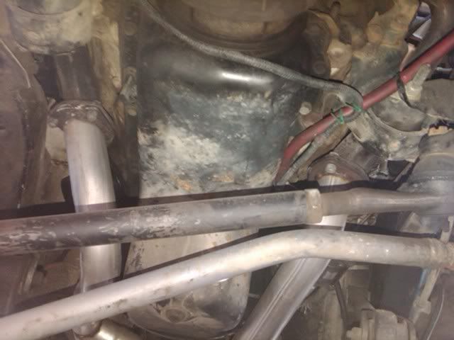

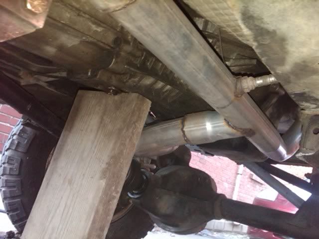

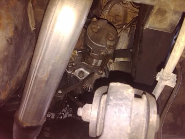

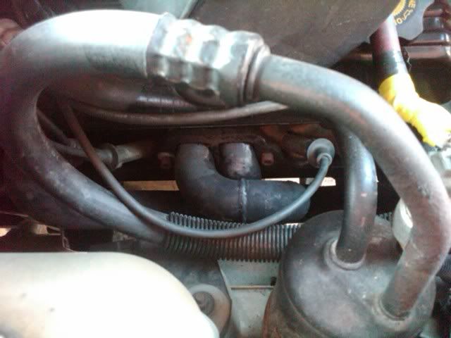

some pictures.
clear lights, they're bright as all get out with the silverstar ultras in them. the glare at light level is pretty harsh though,never realized it till i had them on pulling my other car into the driveway.
clearance of the dodge starter.
bottom of the headers.
y-pipe, i am not very satisfied with the build quality from the shop that was highly recommended to me.
(don't mind the wood, it's not going to fall past the cross member. lol)
top of headers.

I'd redo that Y pipe . . . doesn't look like it can flow that well with the downpipes meeting like that.
it can't. i can tell in the exhaust note how much turbulence it causes.
i have to redo the whole exhaust just about to work around the clayton's anyways.
