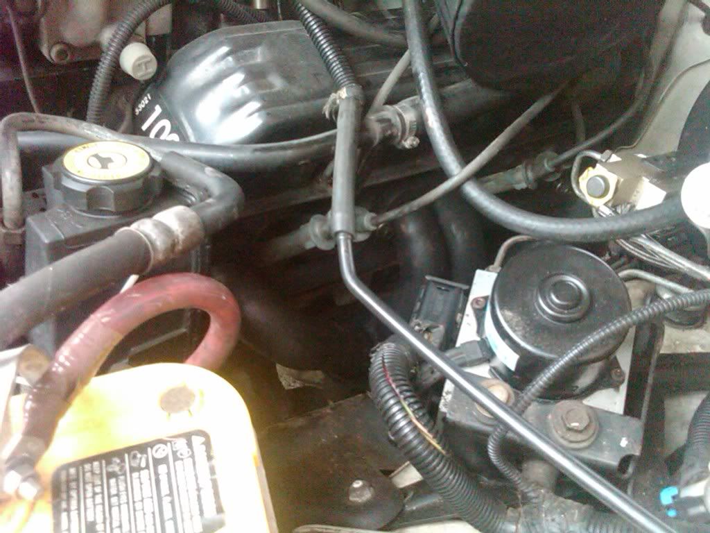

put the headers on today. hedman tight tubes fit very well, the y-pipe is going to be getting done tomorrow. should be an adventure for the shop to get it clearing everything under there.
the bolts hedman included are the wrong thread pitch for the heads for some reason, they appear to be metric.
from the top, driver's side
pass side
another shot of the trans mount.
unfortunately yet another problem has crept up. none of the gauges work, all the idiot lights run through the sequence at start up(i think, gotta pay attention to the mil) hope it's not a bad pcm...
