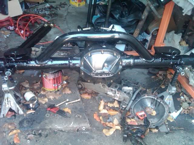

por-15 and a solid cover now. just waiting on master install kit and locker.
cut all the bracketry off the back finally and por-15'd as much of the underside as i could reach. and a decent amount of myself as well. exhaust routing is going to be interesting.

i'll let everyone know after I beat on it. Its heavy, well made, and good hang for the buck.

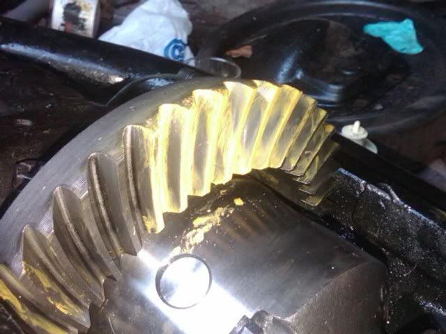

I got the locker installed today, checked the gear pattern and its pretty much textbook on the coast side, a touch off on the drive side, and the backlash is good. Not gonna do any adjustments since the preload is good on the carrier bearings and the gears are used.
Gotta drill for the locker wires grommet. bolt up the brakes, run some brake line, then bolt it to the jeep before the snow starts.

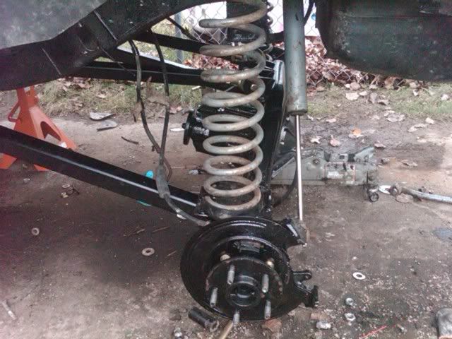

finally on all 4 wheels again. gonna have some tweaking to do for control arm lengths in the rear, axle is twisted a hair and pinion angle isn't set fully yet. so, brake lines, final control arm lengths, and flange adapter is all that's left on that end. gotta do a little more modification to the clayton's crossmember to fit the dodge trans mount. i was off by about 3/4" in the mounting location now that i've fixed the mount stack height issue i had encountered previously(had to add 1" to the mount for proper driveline angles)
gonna need to throw the bb on top of the springs in front, the 8.8 swap added over 2" of lift to the rear.
22.75" hub to fender front, 24 7/8 rear.
finally got a little side by side of the 44a and 8.8, the 8.8 is significantly bigger all around. fully recommended.

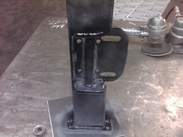

got the crossmember and tranny mount modified. needed to add 1.25" to the stack height of the dodge tranny mount.
i've done better work with a plasma, but this'll do. most of the rough edges is a weld bead anyways.
here's the gear pattern i got when i put the locker in.
